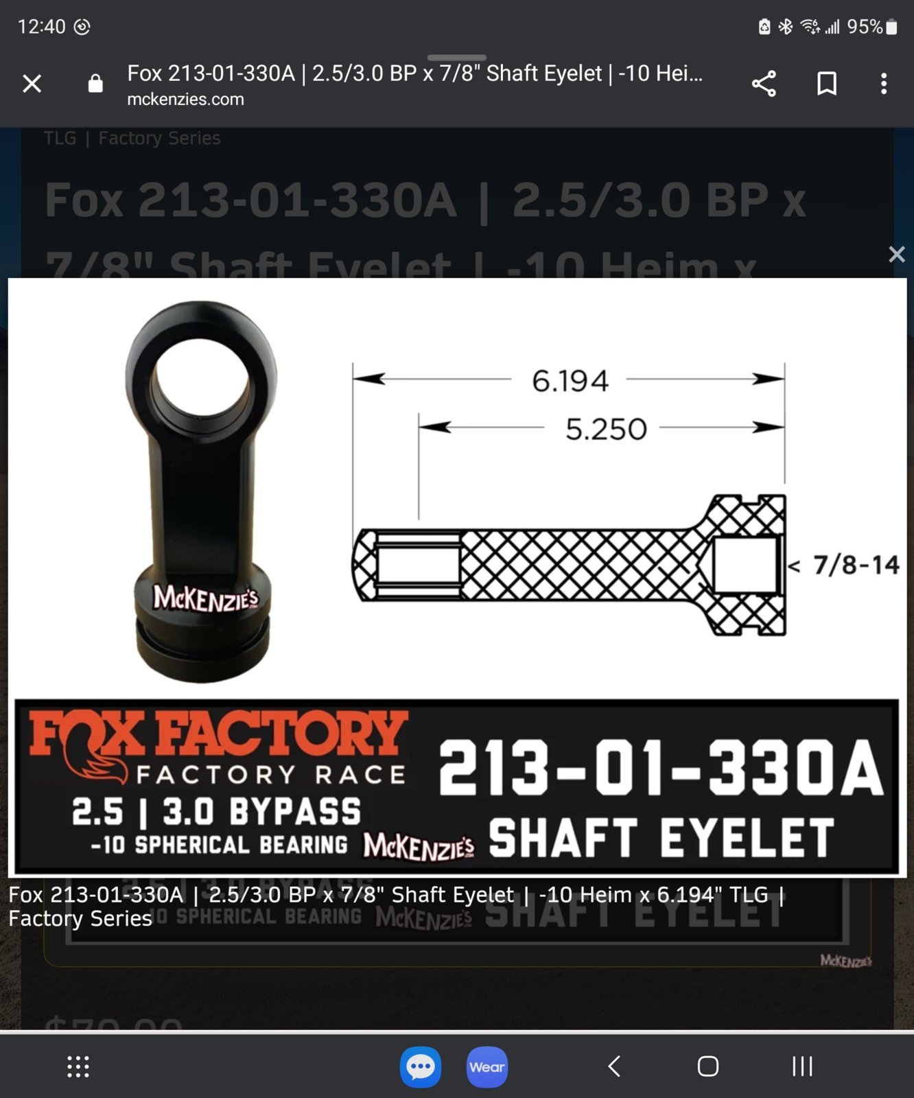

    option 2 - The new leaf spring reduces the available up travel due to the additional thickness of the spring pack. Longer rod end for the shock shaft would likely be the easiest, just don’t know what options are available from Fox.

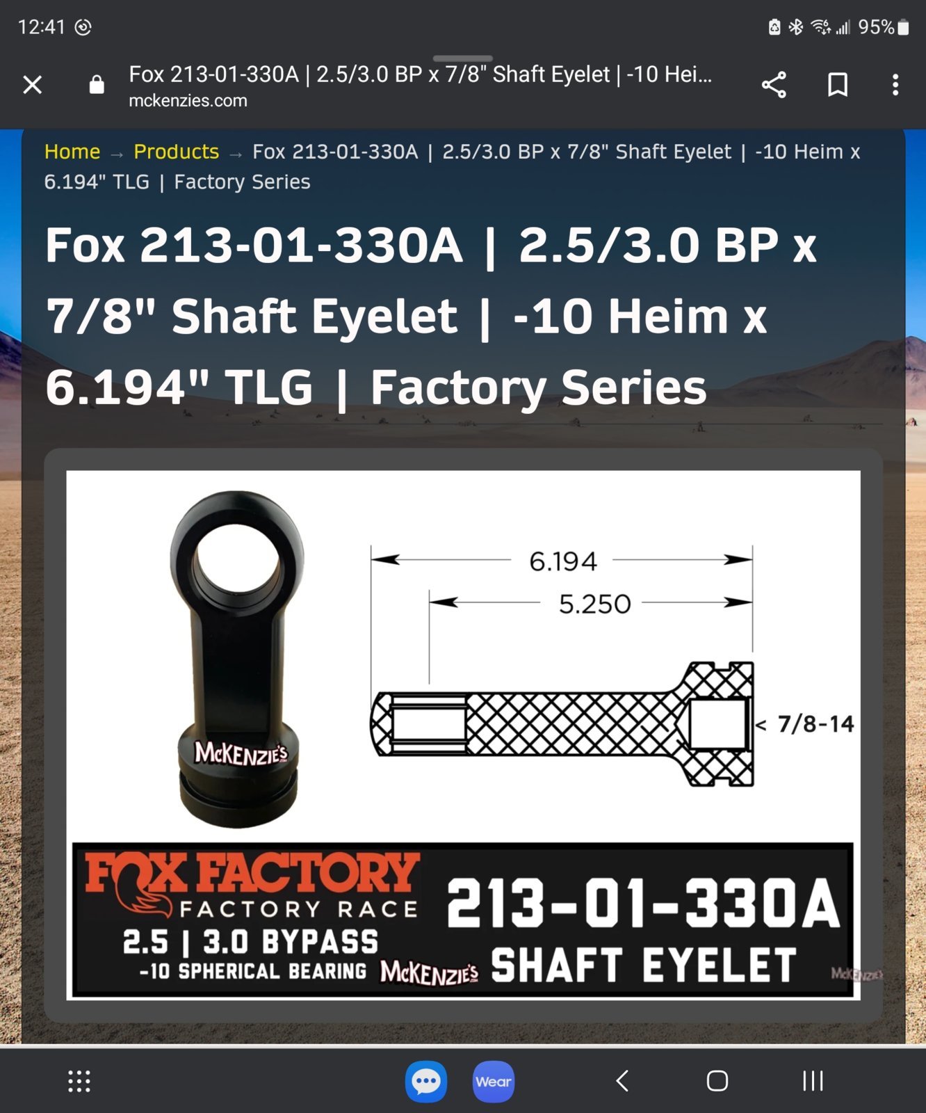

    This might be the correct 1” longer rod end, definitely should call and talk to someone though. Might be other options available also. Need to make sure the added rod length doesn’t bottom out the shock when the bump stops are compressed. Going off the added spring pack thickness, 1” longer should be about right to keep the original compressed length.
    https://accutuneoffroad.com/product/rod-end-3-895-oal-58-bearing-78-shaft-std/
    Both of these companies have also been helpful answering suspension questions and getting parts from.

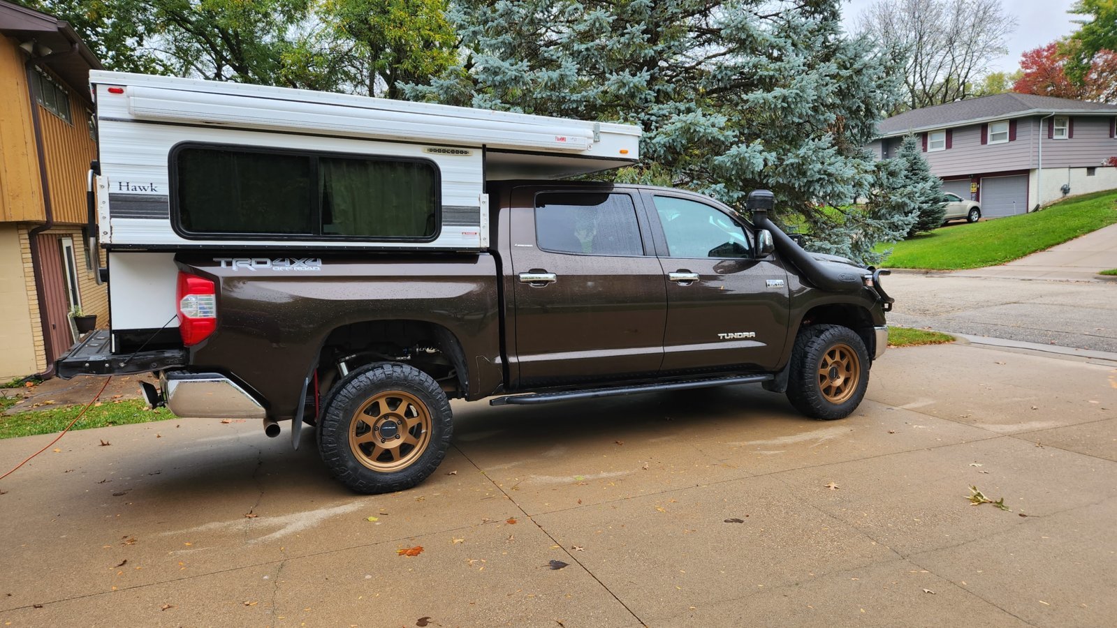

    Can you share some photos? Let’s see what we’re talking about here. Would be good to see the whole truck from the side, the rear, and anything that will show the rear suspension.

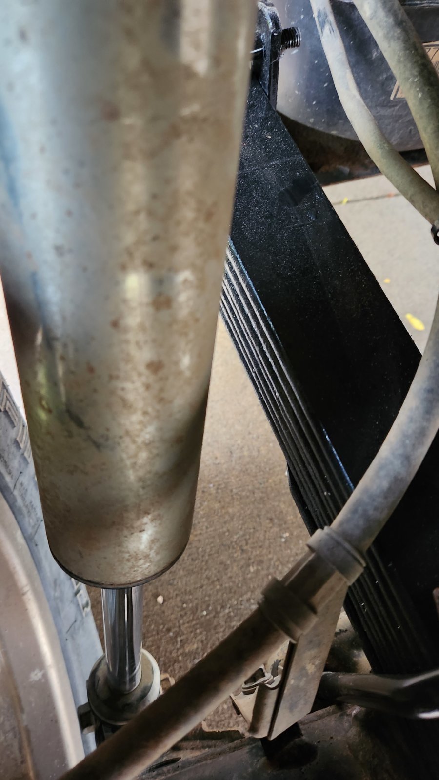

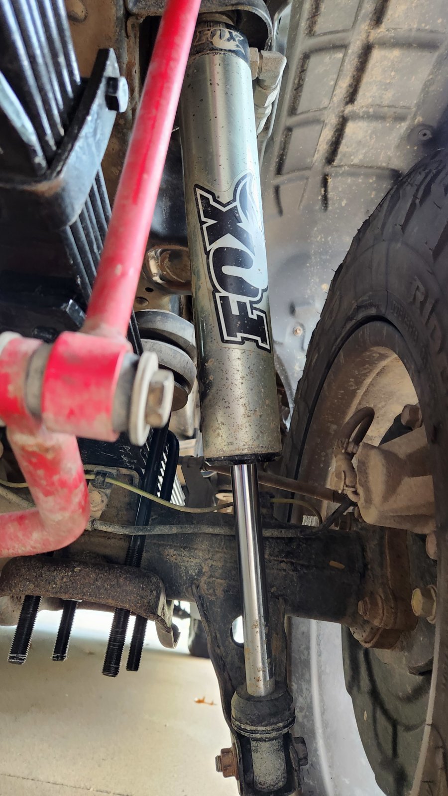

    Here’s how much shock shaft I have exposed at regular ride height:
    That’s with Deaver U748 springs and TC shackles. Supposed to be 2” lift, but they’re giving more than that. Every bit of 3”, and they’re well broken in. Close to 50K miles on them and my truck is a fat pig.
    My shocks are ADS’s “Deaver spec”. 11” stroke, if I remember correctly. I do hit full extension on the shock just before the springs max out on droop, and I am well into my bumps before the shocks are fully compressed.

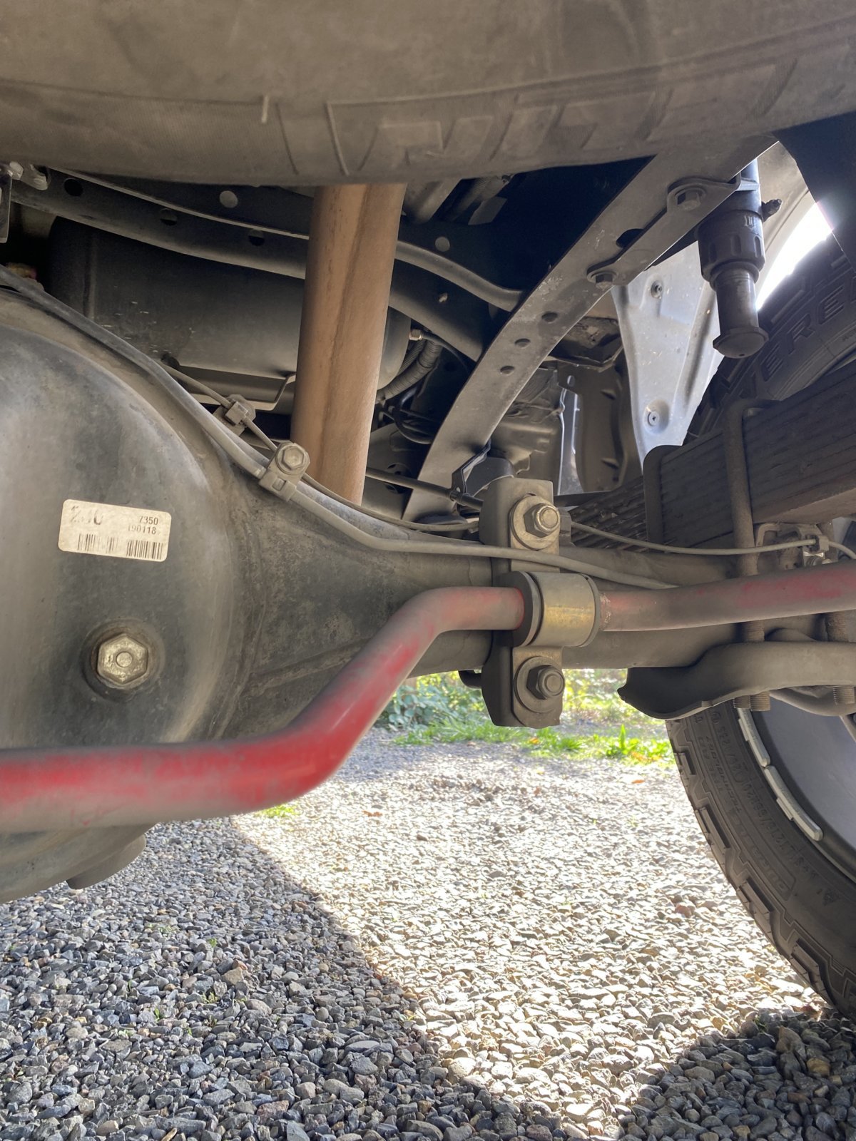

    Our springs are certainly different. I wasn’t able to keep the rear sway bar mounted beneath the axle. I had to rotate the mounts and locate the bar behind the axle because it was hitting springs.

    Ya says bar is another? Can you explain rotion to me thanks

    Some
    The ubolts holding sway bar to axle spin 90 degrees so that the sway bar runs behind axle instead of under axle.
    It puts the endlink connecting point back a little further for more clearance at the spring. Also adds some ground clearance.
    In theory the sway bar is less effective when end link is not vertical now but I didn't feel any difference in handling.

    Yup. As mentioned above^^^
    the u-bolts and hardware simply get rotated 90° on the axle housing and the bar will move rearward about 4”. Also up about the same, which makes the links really close to the same effective length as when stock. Move the link top bolts to another hole. You’ve got 3 to choose from, and you’ll get it real close to perfect.

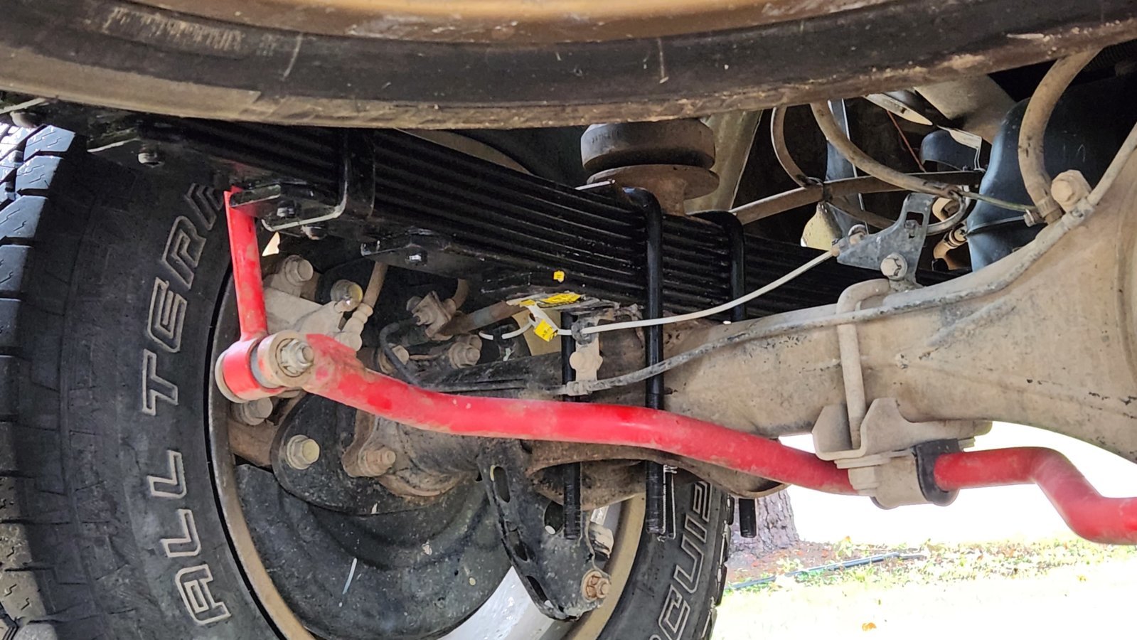

    Well I looked at that--- .what did u do with metal tube that runs along axial .thinking its the break line?

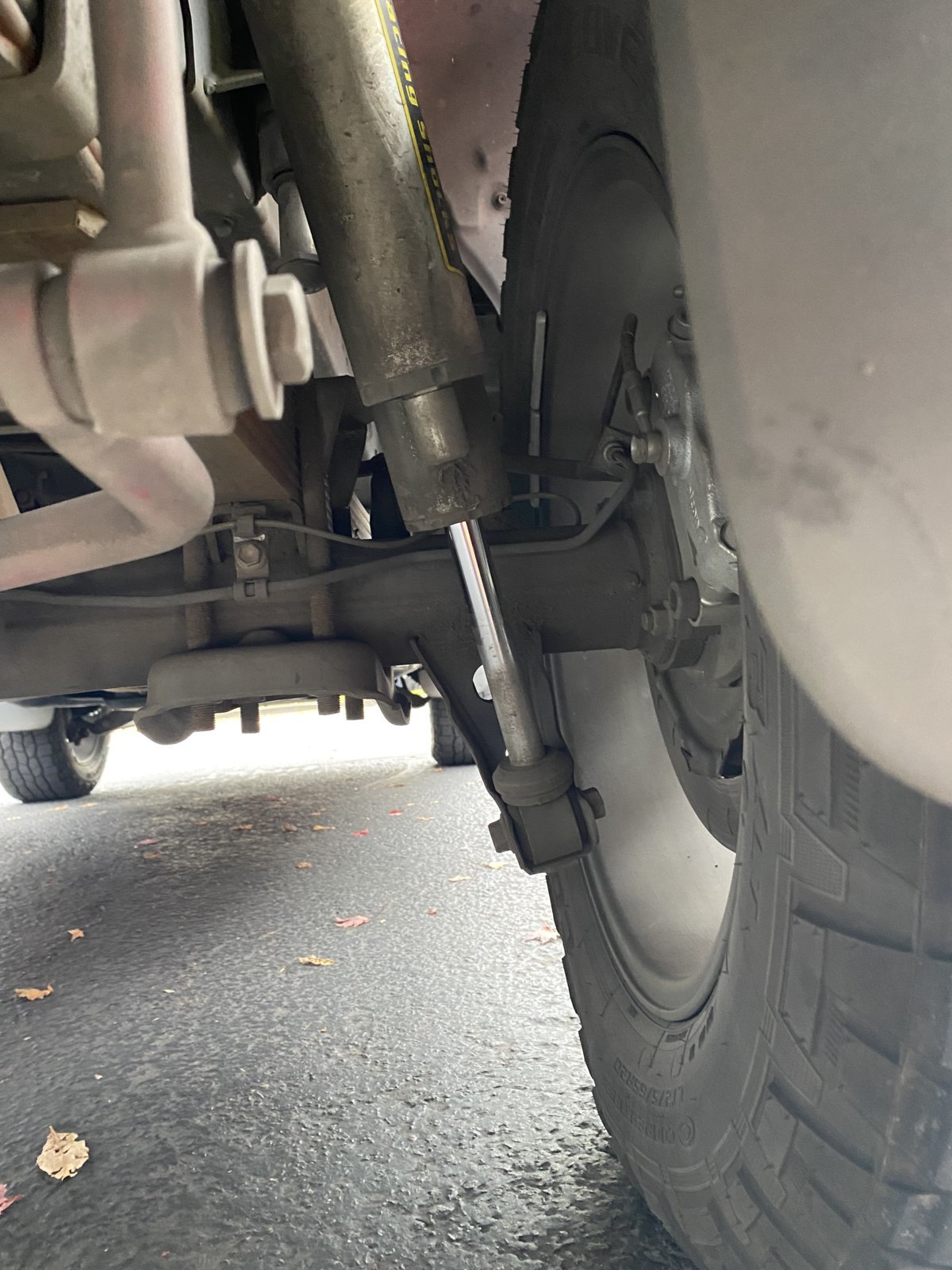

    Plenty of room. Just crawled under and took a photo for you:
    I can’t remember if I had to, but you may need to loosen the brake line R-clamps from the axle tube to get it slipped together, but it’ll all go right back into place. That RSB bracket isn’t much thicker than the U-bolt that was slid between the axle and brake line.

    U think this will work. ?
