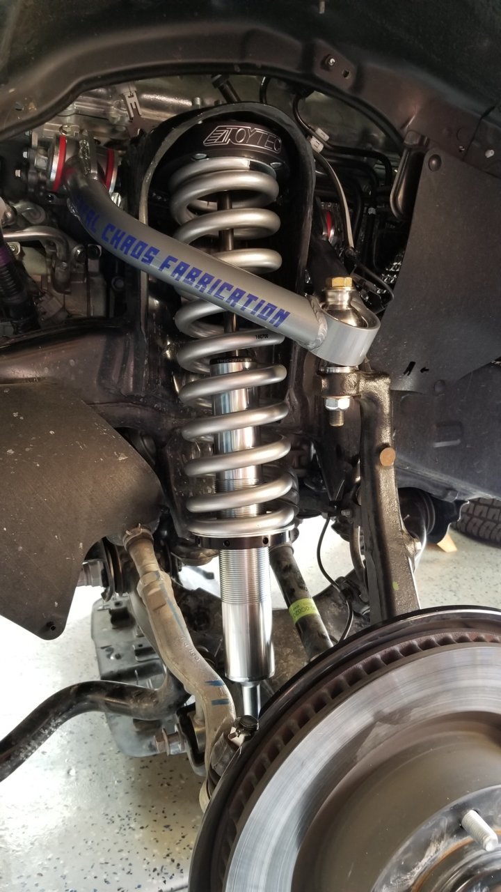

    3" ToyTec Boss kit with Total Chaos upper control arms.
    Stroke250, JoshuaA and T-Rex266 like this.

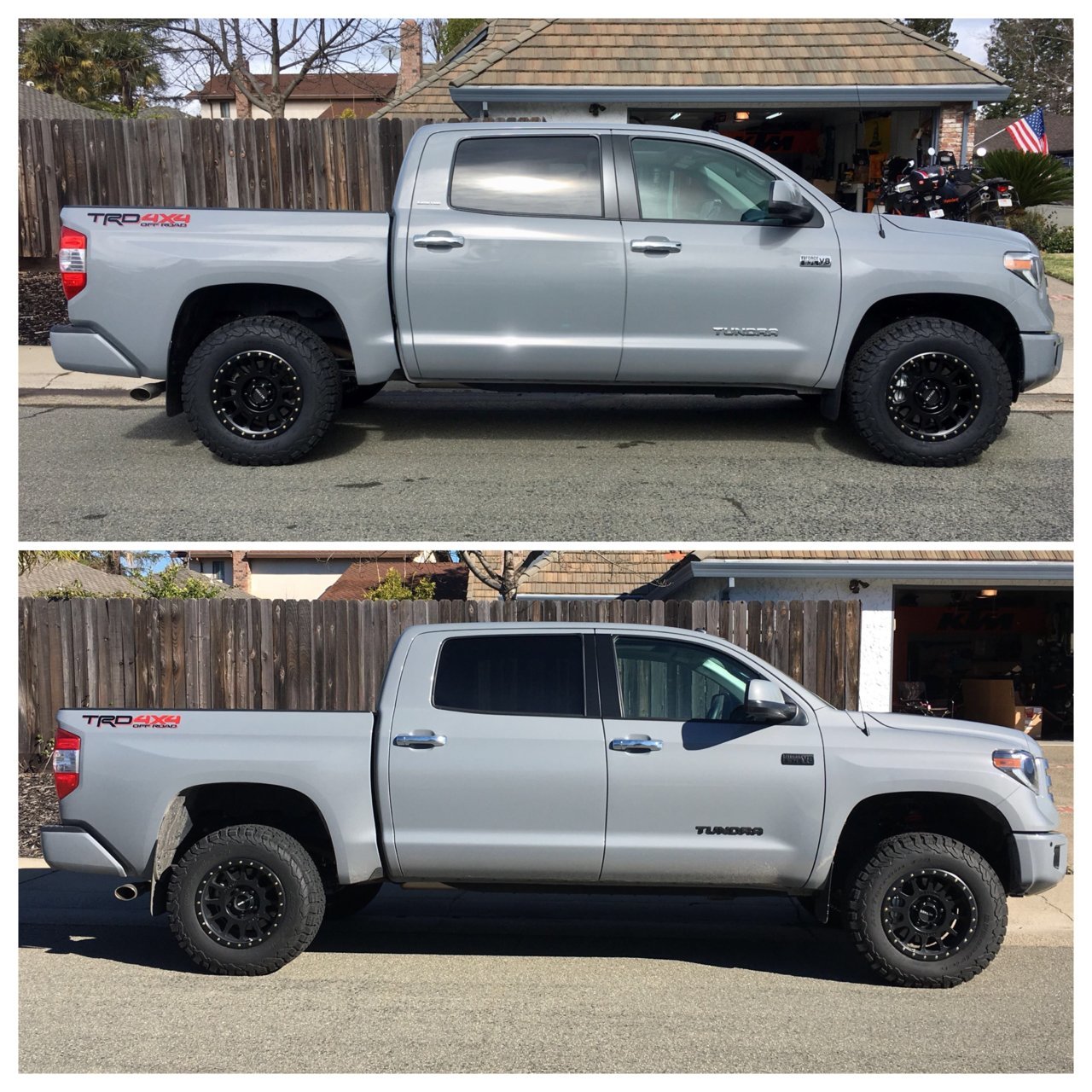

    Wait until it's done. If you do need Toytec shackles, I recommend the optional polybushings and greased properly, the ride will improve over stock.
    2.5/1.5 Toytec in rear (I've tilted the pic a bit to account for the decline in my driveway as there's a slight rake on level road)
