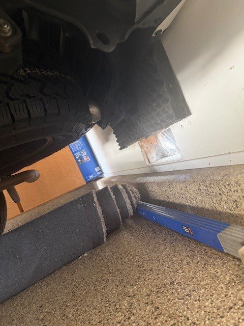

    I have CB's +2 shackles on the rear along with a full size spare(295/70/18) and did not have to modify anything (except remove spare alignment guides). I just push the spare forward when tightening it up. I also put a roll of packing tape sideways between the spare and inside of hitch to help keep the spare forward. Sorry for the lousy photo. I do have factory rear exhaust.
