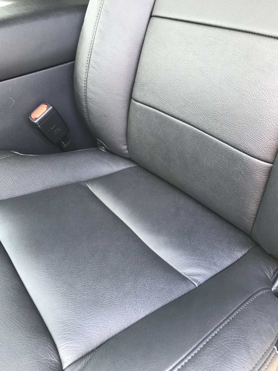

    I am really happy with the way they turned out. Did factory match as option and was $1300 installed.
    For $200 more I could get 3 extras including custom stitching, perforation and piping. Only thing I was sure about was going without perforation (thought it might be too hot and not breath) but I’m in Texas and it hasn’t been noticeable.

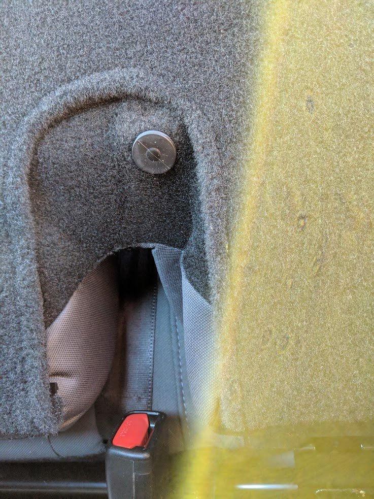

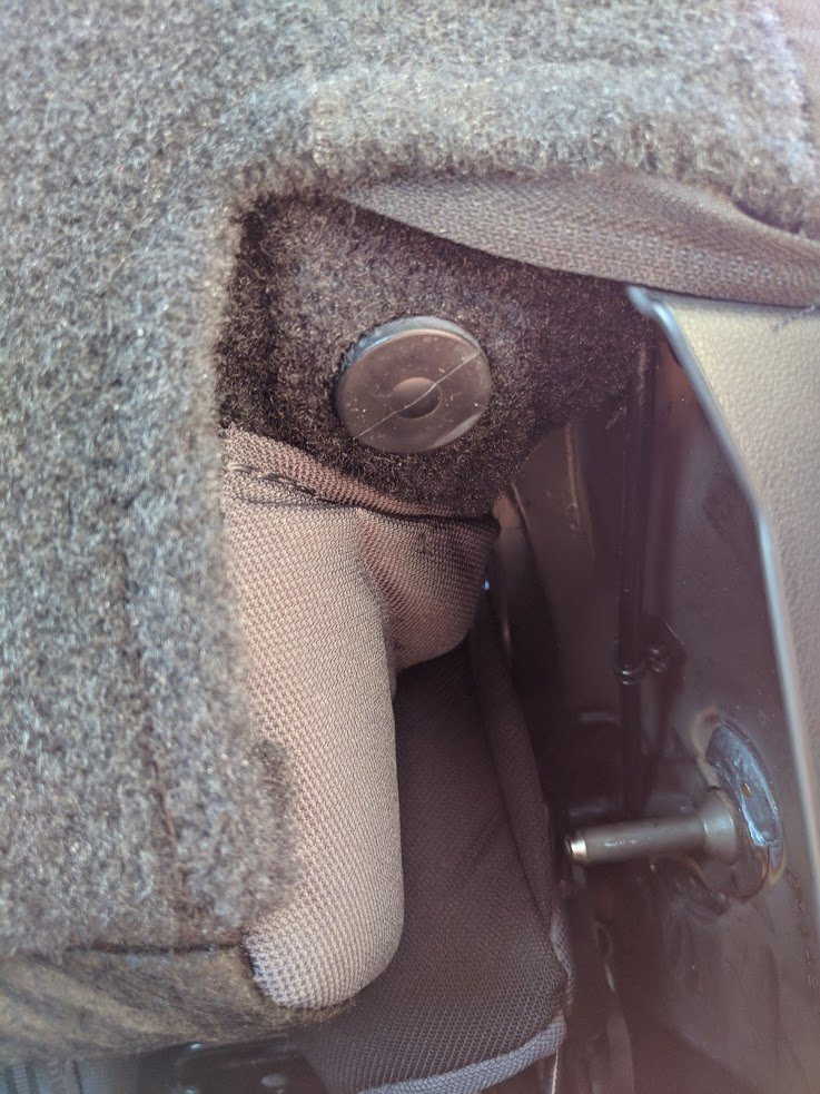

    I just checked mine. When they are latched in the down position I can move the front about an inch up and down - but it does not rattle at all, it's more like flex in the seat than movement at the latch or hinge. I see there are little round rubber bumpers that it sits on when closed. Check to see if you have those, or maybe you can replace with something a little thicker. I would think that these would keep it from rattling. MwbNuKpe6mk_VEK6EJS1ZxwluiamE716NDmKhmln_42e75c52f708dda29cb61186dca23318f9cb5915.jpg GWdbpNwh_nLEMeJ6cgzv6_AngP2pQ4kUn6bqZ7ZZ_c9ae775b7a0508ba9665a9c3a44eec49c56c7ad2.jpg
