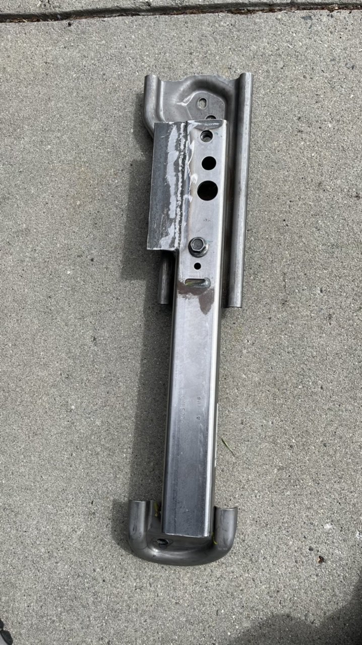

    Could probably just get a thick square tube of the same width and the height you want and weld right on top of the seat brackets. Would probably weld a fish plate along the side to reinforce it. Weld the nuts inside the tube.
    Here’s one of my seat brackets that I had angle iron welded to the side of it. As you can see there is plenty of space to put the square tube on top of the bracket. The front of the truck is towards the bottom of the picture but the bolt holes for the seats are towards the rear.

    Hate to dig up an old thread. I'm currently researching this, and found a post, was it this one? https://www.tundras.com/threads/how-i-fit-three-12-subwoofers-in-a-2019-crewmax.72599/#post-1863482
    I see they use "2" square tube of .12" thickness" but really wish the other dimensions were available, such as length, spacing for holes, etc. Let's see if this @ works: https://www.tundras.com/members/marauder.49442/
