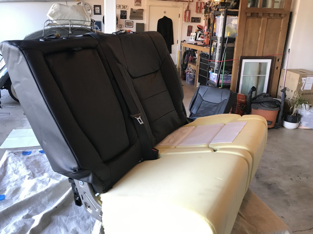

    Just purchased a 3rd gen Tundra.
    Came from a 2nd gen where the backs of the rear seat folded down allowing storage access behind.
    Anyone come up with some type of hack to get the rear seat backs to move to allow access?

  12. Dec 9, 2019 at 3:40 PM
    Ruggybuggy
    Ruggybuggy Seasoned Veteran
    Sep 23, 2019
    #36508
    3,687
    Dave
    NW ON, CANADA
    2016 Tundra OR
    I just finished doing this mod and it works great. I decided to remove the hooks of the back of the seat and cut them. The reason I didn't bend the tabs down on the back of the panel is because I have a rear slider and didn't want the headrests interfering with the glass. It was easy just to remove the seat hooks and modify them. I took of about 1" and it works perfect.
