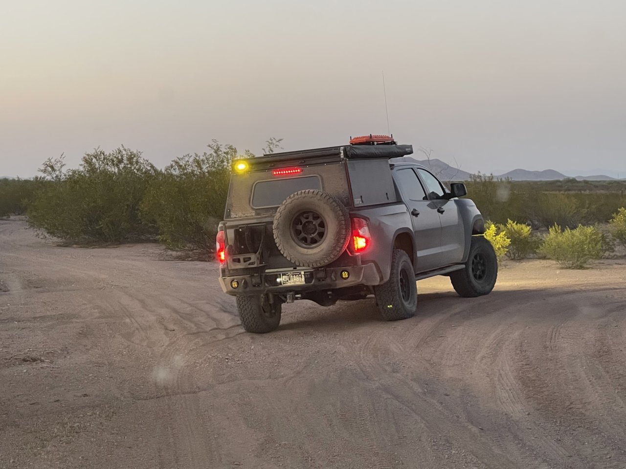

    What deaver springs did you add? They can make a custom pack for the weight you’re carrying. Did you add shackles also?
    This setup attached has full decked system packed with tools, second battery, compressors etc.

    I asked Deaver to customize it for what I was doing. I brought it there fully loaded after they did the initial ad a leafs (2) and they recommended not doing anything more to the leafs. They did recommend airbags but I wanted to do research before doing anything more.
    I like the way your setup looks

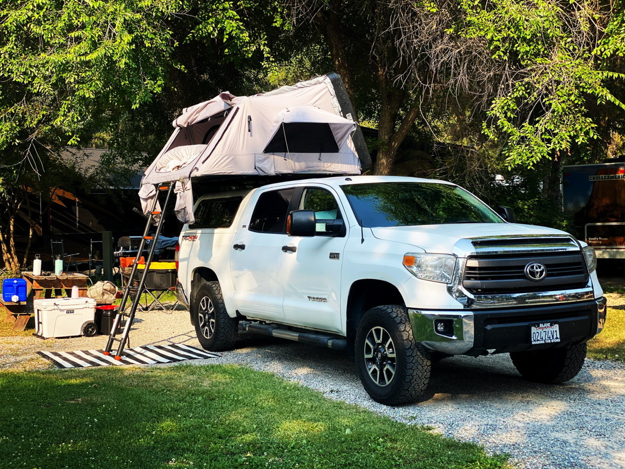

  13. Sep 10, 2022 at 9:04 PM
    DylanT
    DylanT [OP] New Member
    Oct 20, 2020
    #53846
    13
    Dylan
    this is how she sits now fully loaded. I will update when I get shackles done
