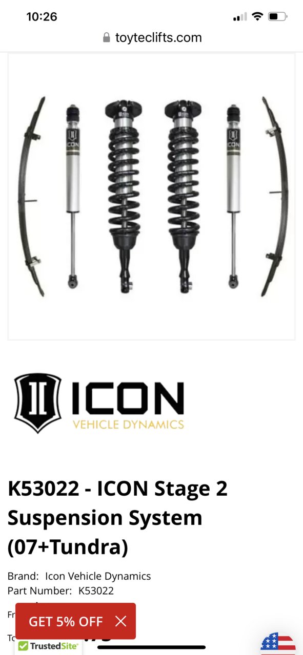

    My truck is currently in the shop for a suspension upgrade. I am going to run Icon stage two up front. Some folks recommended to go with icon RXT leaf spring kit which would replace the existing leafs. The shop has mentioned just adding ICON springs to what I have in the rear which is the OEM springs
    I do not have heavy mods on my truck. It is stock weight front and rear.
    Does any one have suggestions on what to run in the rear or are you running ICON up front and something different in the rear?
    Would love some opinions.

    Would you suggest completely replacing the leafs in the rear or install a mini pack? My truck is all standard weight. Trying to make best decision for ride quality on longevity on my truck. Truck height im aiming for is 3".

    This is where I get confused a bit. Is the mini pack what typically comes with something like a stage 2 icon front?

    Think I may go mini pack just in case the need for any tow or load in the bed. Not sure how much rake I will have but it seems like it may be unavoidable with these setups. Though maybe a little rake is necessary for those just in case moments.

    ICON stage 2 comes with mini add a leaf

    Yes, this is what the shop recommended me install. Then I got to reading and pretty much confused myself and unknowingly spend more money or install things I don't need. :rofl:
    Precisely the reason I asked the question to the forum. Trying to learn and pick out what I need while it's in the shop being worked on. They are going to call me when time to install rear to see which route I want to go. Im pretty sure the shop, who does A LOT of off road installs etc, is rolling their eyes by now. But hey, just trying to get what I want/need now not later.
    btw, i am a noob at this stuff if you can't already tell and Im learning everyday I read this forum and ask questions. I am also finding myself wanting to spend more money too. :spending:

    Where I get confused is when the RXT came into play over the mini pack which what comes with the stage two already.

    RXT comes into play on stage 8

    Im thinking for my use and set up the standard Stage 2 with mini pack will be fine. Has to be an improvement over what I am currently running which is/was OEM TRD-off road billsteins with pro-comp spacer leveling kit.
