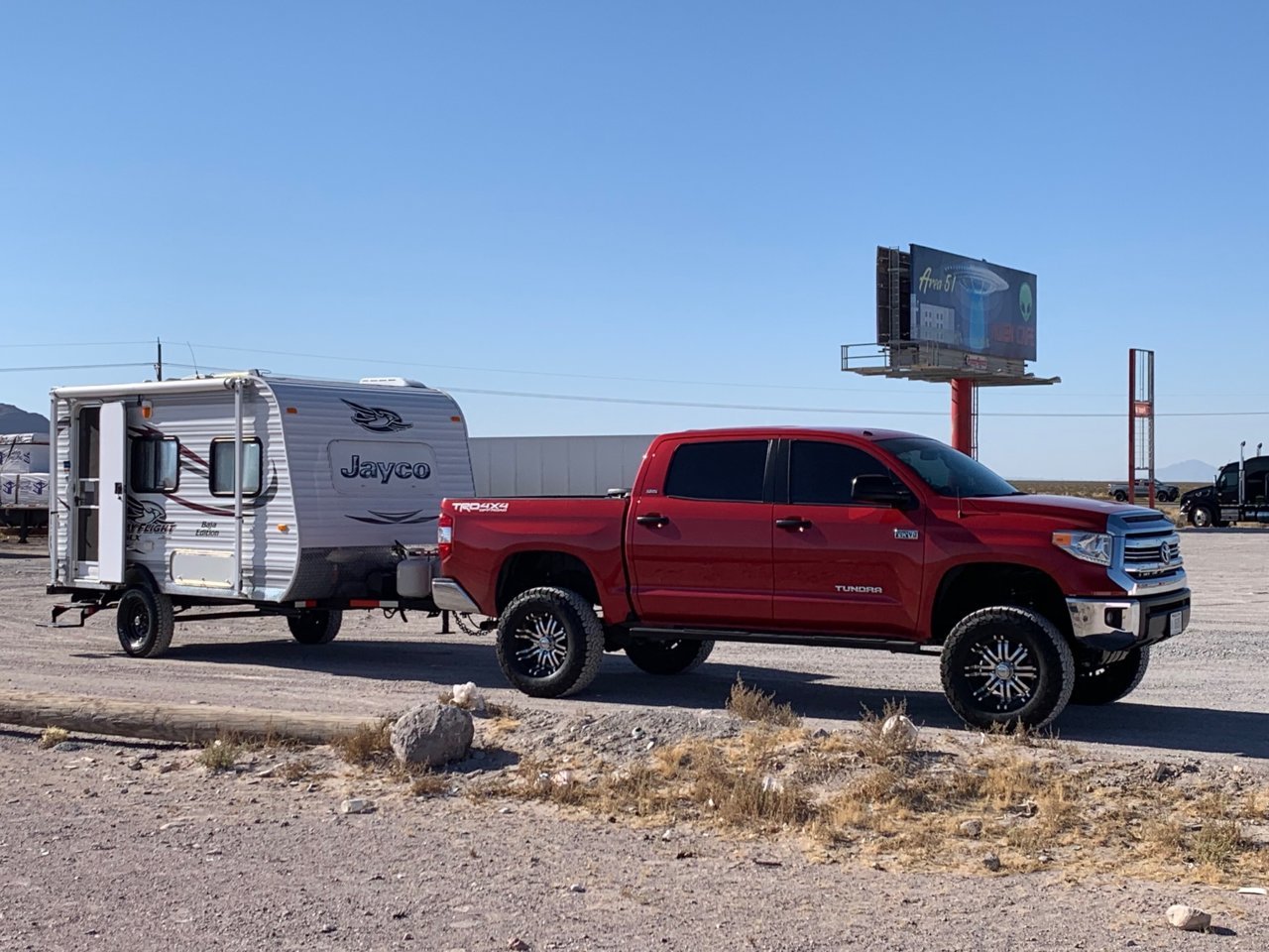

    I use Firestone ride rite air bags with good success, but I'm only towing approx 3000 pounds.

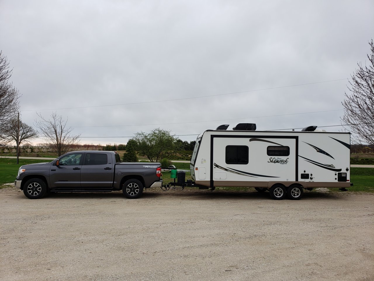

    I use a weight distribution hitch along with Timbren bump stop helper springs to help lessen sag and sway when I tow my camper. They work very well and require no maintenance.
