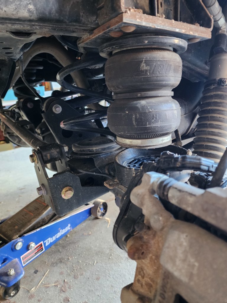

    I have airlift 5000. Installation is very straight forward and it works great. It did give the rear of my truck lift, but I was lifting anyways. Handles heavy load well at the push of a button.20241105_112405.jpg 20241105_112311.jpg
