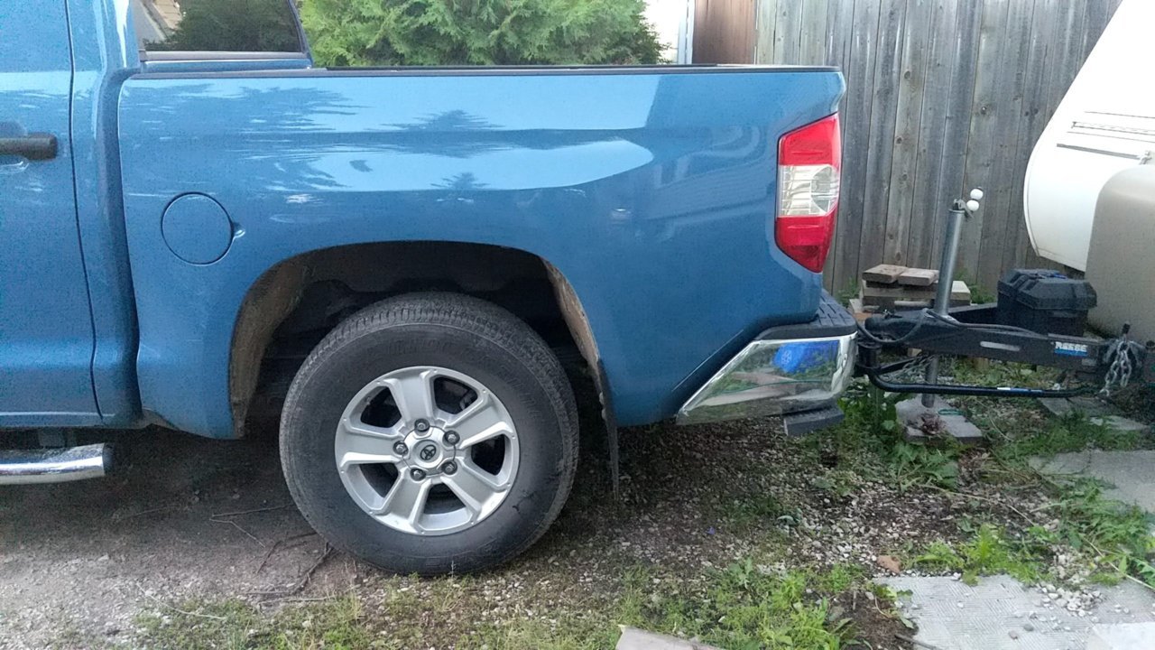

    Last time I loaded it up with River Rock, I watched it go down, down, down. I still had lots of clearance compared to when I loaded up our Sienna and trailer.
    And yup, if you tow or load your bed, keep at least some rake if you don't want nose up.
    Here is the first time I loaded up our stock tundra with our 3500+ trailer and wdh.

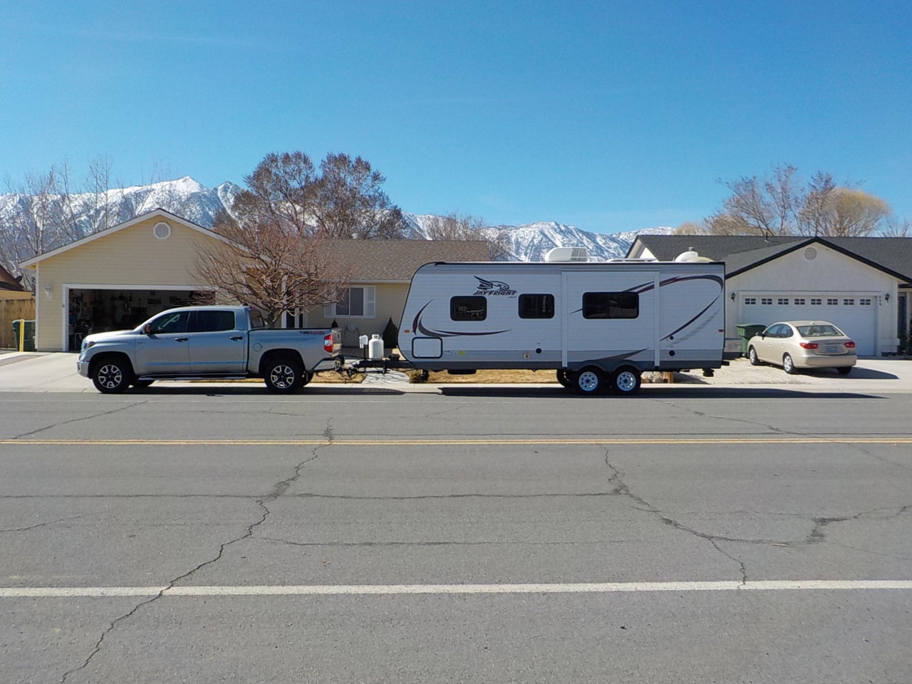

    My trailer's tongue weight is 550 lbs (dry weight), but 750 lbs loaded. My trailer dry weight is 5,500 lbs and loaded weight is 6,500 lbs. Get a good WDH, and firestone air bags. I run 40 psi in the air bags , when loaded.
    This is my setup. Tows great.
