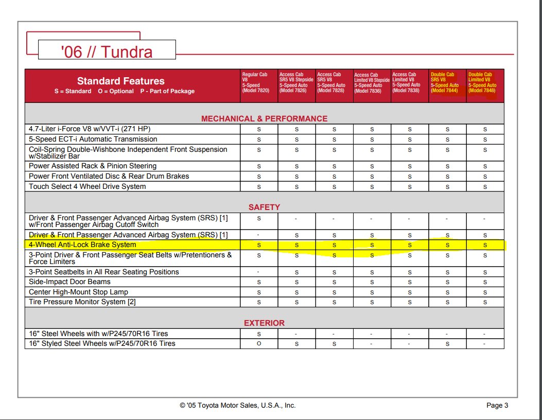

    All 2006 Tundras have ABS from the factory...
    https://cdn.dealereprocess.net/cdn/brochures/toyota/2006-tundra.pdf

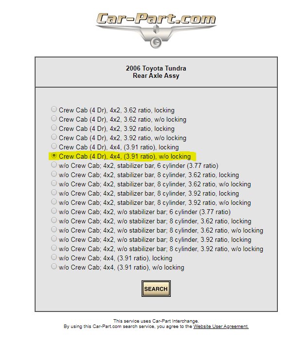

    Try here...and put in your zip-code.
    http://www.car-part.com/
    Then choose this...
    If your 2006 has vehicle stability control (VSC) make sure the axle you buy does NOT have a limited slip differential in it (LSD). Good luck.
