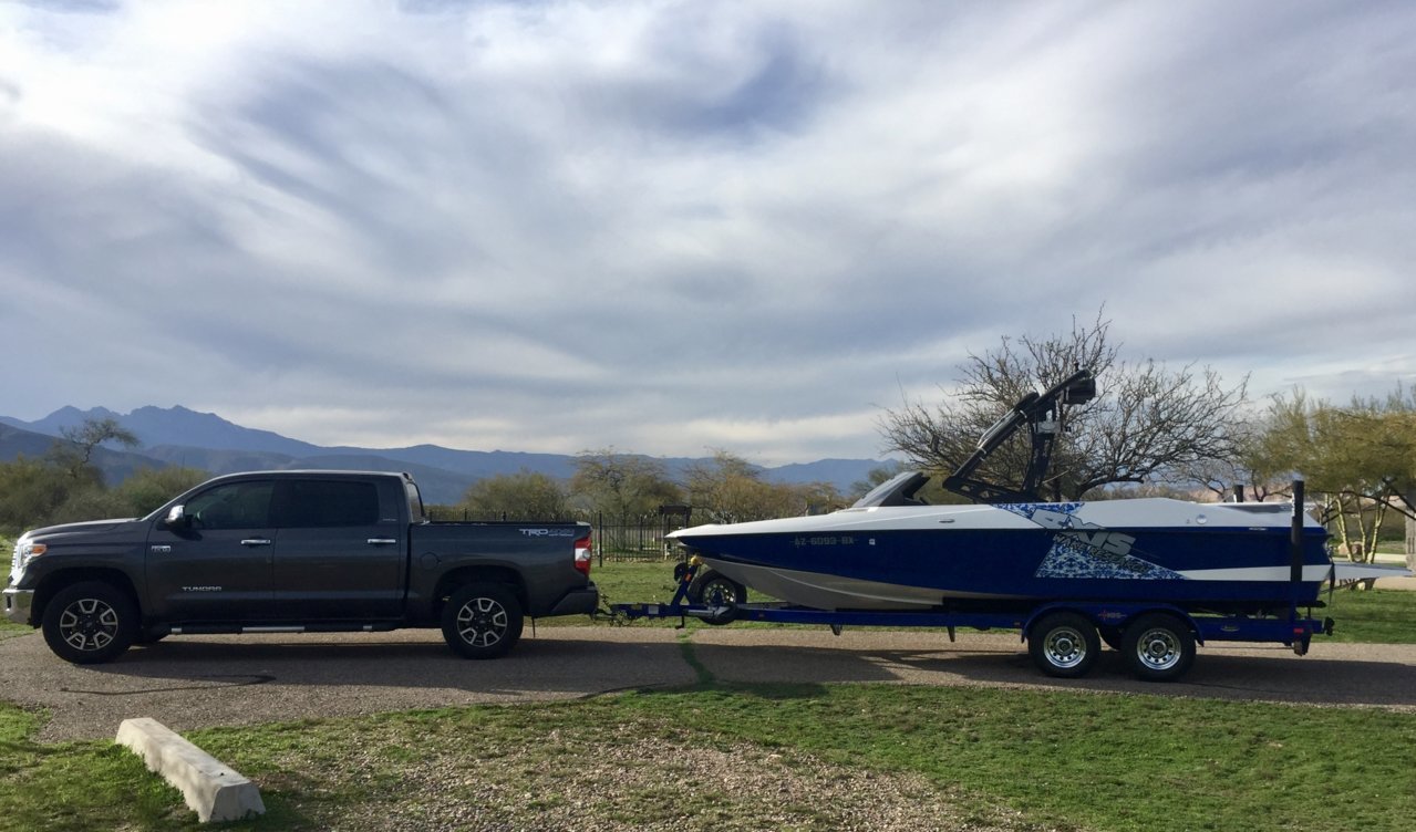

    My experience is that the TRD off road package squats less with a load than trucks with the black OEM shocks (like the 1794 and platinum). Aren’t the shocks the only difference? What am I missing?
    this is stock with 6,000 lbs of boat and trailer plus gear for the day.

    Not saying they provide lift but I do believe they can help prevent squat due to a heavy load.

    Cool. I’m not an engineer, just basing my assumption on observation and experience.
