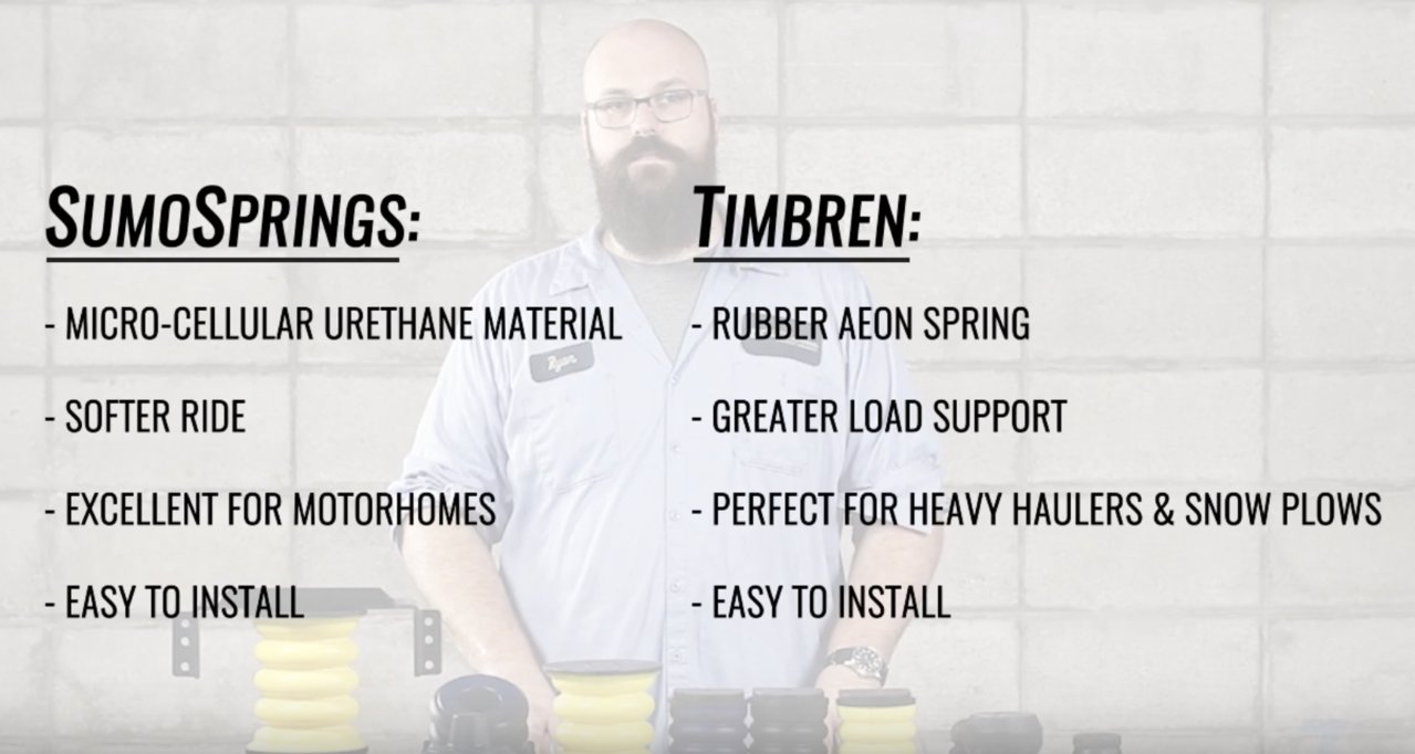

    OP, that's a permanent load, I'd do custom leafs like Alcans. Someone had your exact question a few months ago, did that and they loved it.
    Airbags and these are more for off and on hauling/towing.

  30. Oct 25, 2018 at 8:31 AM
    #30
    15whtrd
    15whtrd Mr. Blonde
    Sep 20, 2015
    #1829
    9,375
    Sean
    SoCal
    This has been my thought all along. Changing out the leaf pack or doing and add a leaf is going to change the way the truck rides unloaded no matter what IMHO. Bags will still limit your travel when unloaded or loaded. There is no 100% answer other than completely changing set ups when towing. If you want to be able to tow heavy loads and also have a flexible truck when I unloaded, it’s almost impossible. Now if you always have a static load you can set it up for that, but if you have inconsistent loads it’s hard to adjust. I feel that your solution was a good compromise all the way around, for what you and I use the trucks for. If I was set up with overland gear I would think a leaf pack would be my first choice and I would still add that timbren if I was going to tow something.
