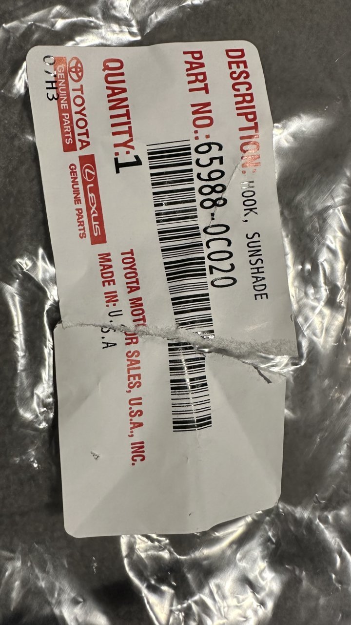

    the part number for the clip is
    65988-0C020 with description of hook, sunshade
    paid $19 apiece for 2 of them to have one spare
    used a skinny flathead screwdriver and was able to easily remove the old one. The new one just slides in and locks into place

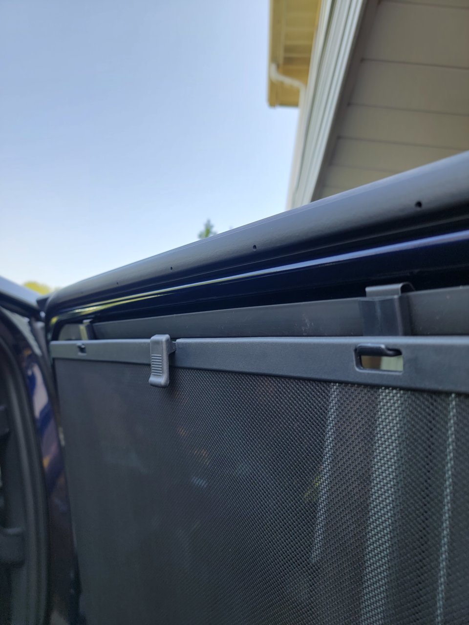

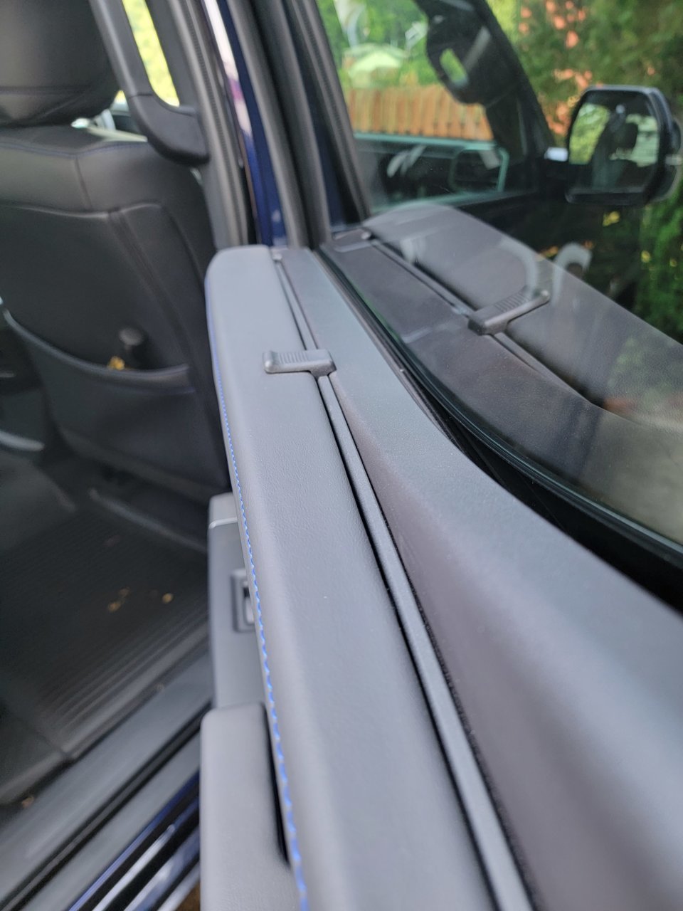

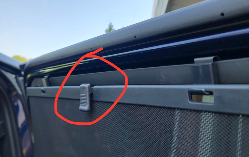

    The plastic handle was broken (the guy with the red circle in the photo) and the shade slipped inside the door. Do I need to remove the whole door panel to fix it? Any recommendation?
