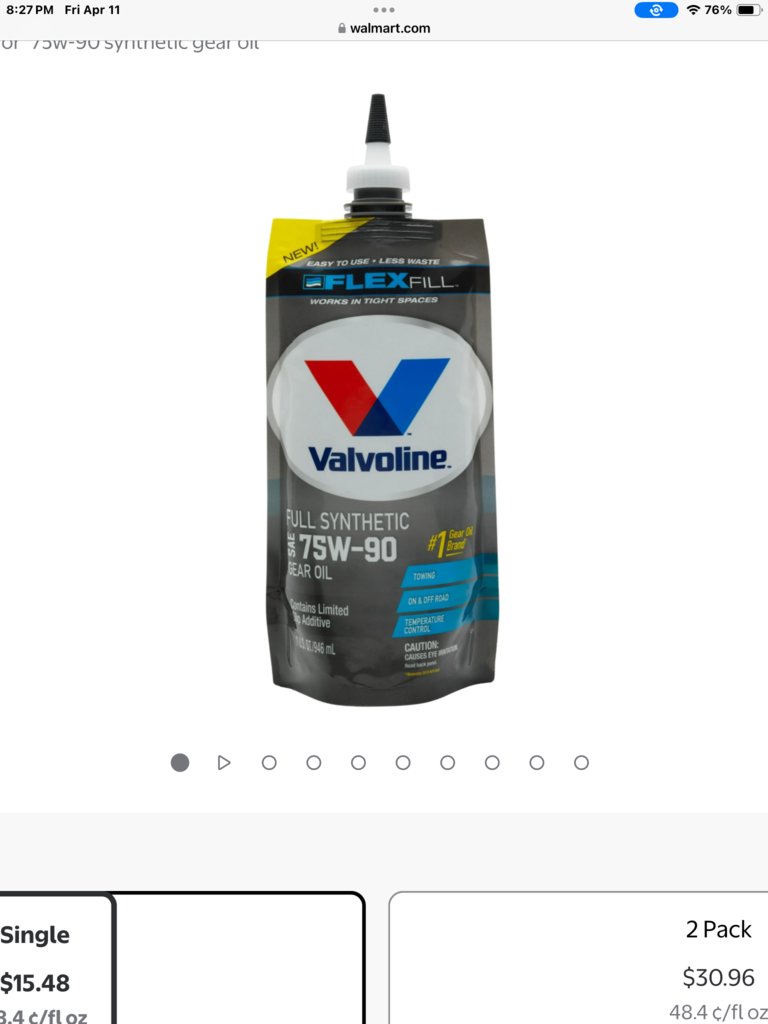

    I took your advice and pulled the fill plug off, on a level surface, and let the truck sit for about an hour. Roughly 1/4 a quart ended up draining out, leaving my rear differential at about 5.25 quarts, if my math is right. I’d say that helped ease my mind a little bit. Still a little weird how I can’t find any information that aligns with my experience, and I scowered the whole internet looking.
    Hopefully someone can chime in about my other question. If 75w-90 is an appropriate viscosity for my truck. (2002 RWD sequoia with the tow package). Although the owners manual called for straight 90, it was next to impossible to find, so I thought the next best thing would be 75w-90. (I mean hey 90 is still in the title, right? I might be wrong with how I think oils work so call me out if im a dumb dumb)

    I think the level and viscosity are good. No more worrying about this, is my opinion. .
