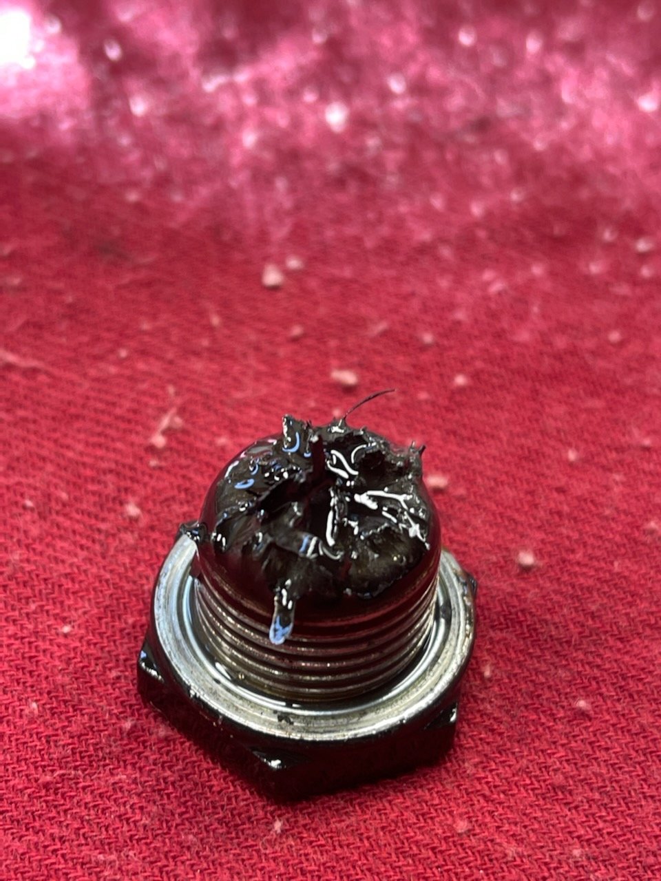

    This is drain plug picture.
    Dr Doobie likes this.

    Nothing surprising there IMO given mileage and dirty sevens. Should be cleaner next time.

    Looks normal to me

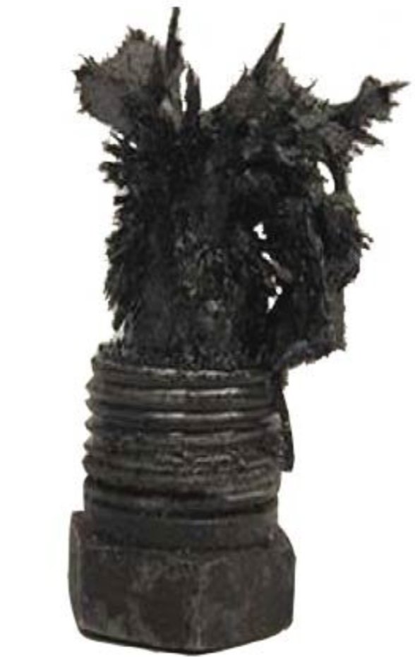

    You definitely don't want this
    Screenshot_20220211-160353_Edge.jpg Screenshot_20220211-160611_DuckDuckGo.jpg

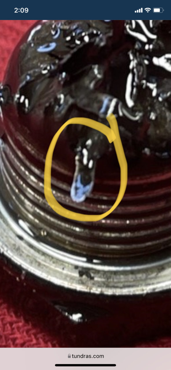

    looks like a reflection.

    That is most likely from manufacturing. I wouldn’t worry about that drain plug magnet finding.
    NWPirate, AZBoatHauler, alb1k and 2 others like this.

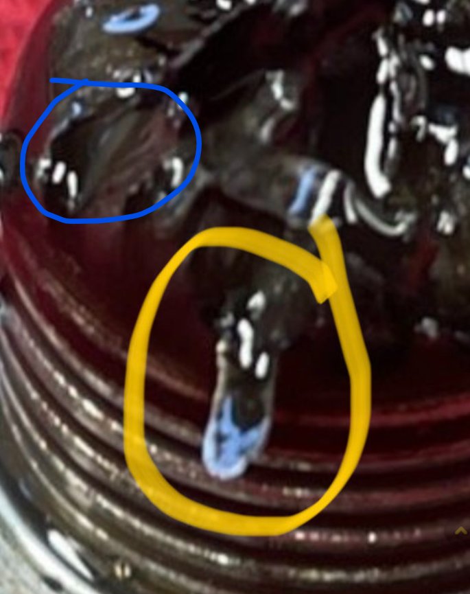

    Looks like this but from a different angle
