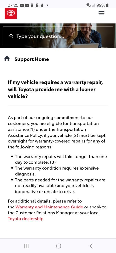

    If they are going to have it for a day...
    FYI.
  9. Apr 10, 2025 at 9:52 AM
    Rockpig
    Rockpig You did what?
    Apr 11, 2022
    #77029
    420
    08 Limited
    He mentioned he was getting a loaner.
  10. Apr 10, 2025 at 10:12 AM
    Blufin
    Blufin Seasoned member
    Feb 27, 2023
    #92850
    1,293
    Bob
    23 Capstone
    Thanks man,I kinda missed this thread from the start,and after I had posted it I had then realized I was a little late to the party:facepalm:
