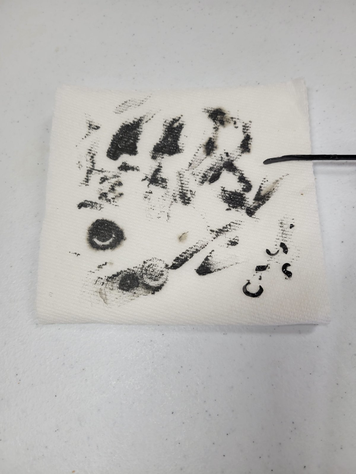

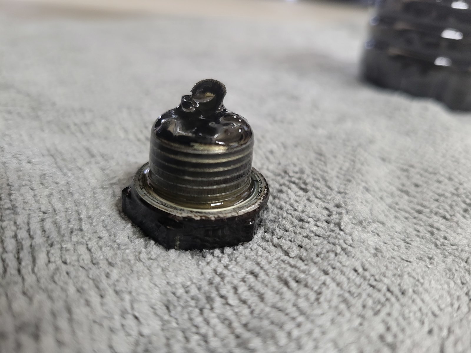

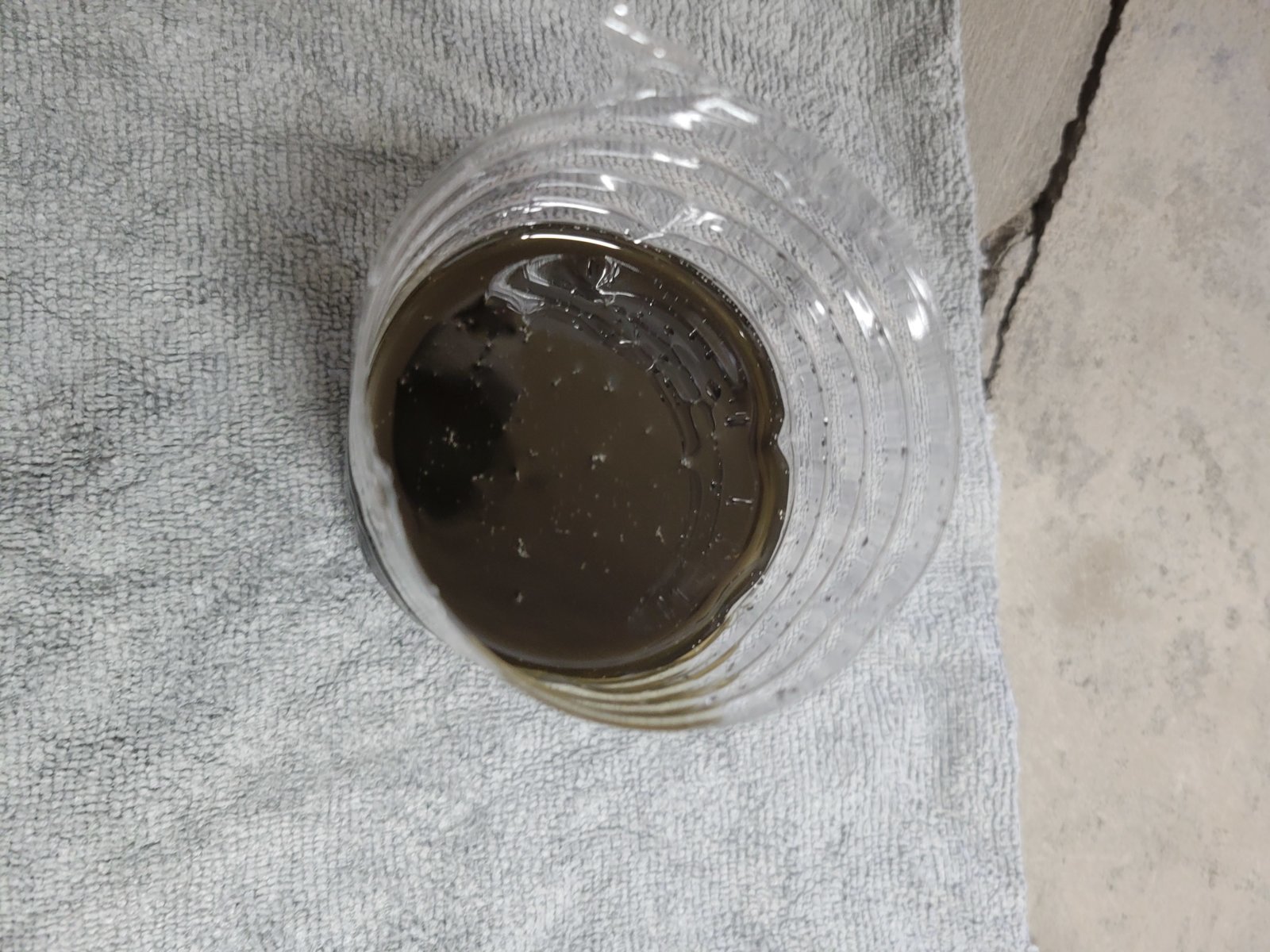

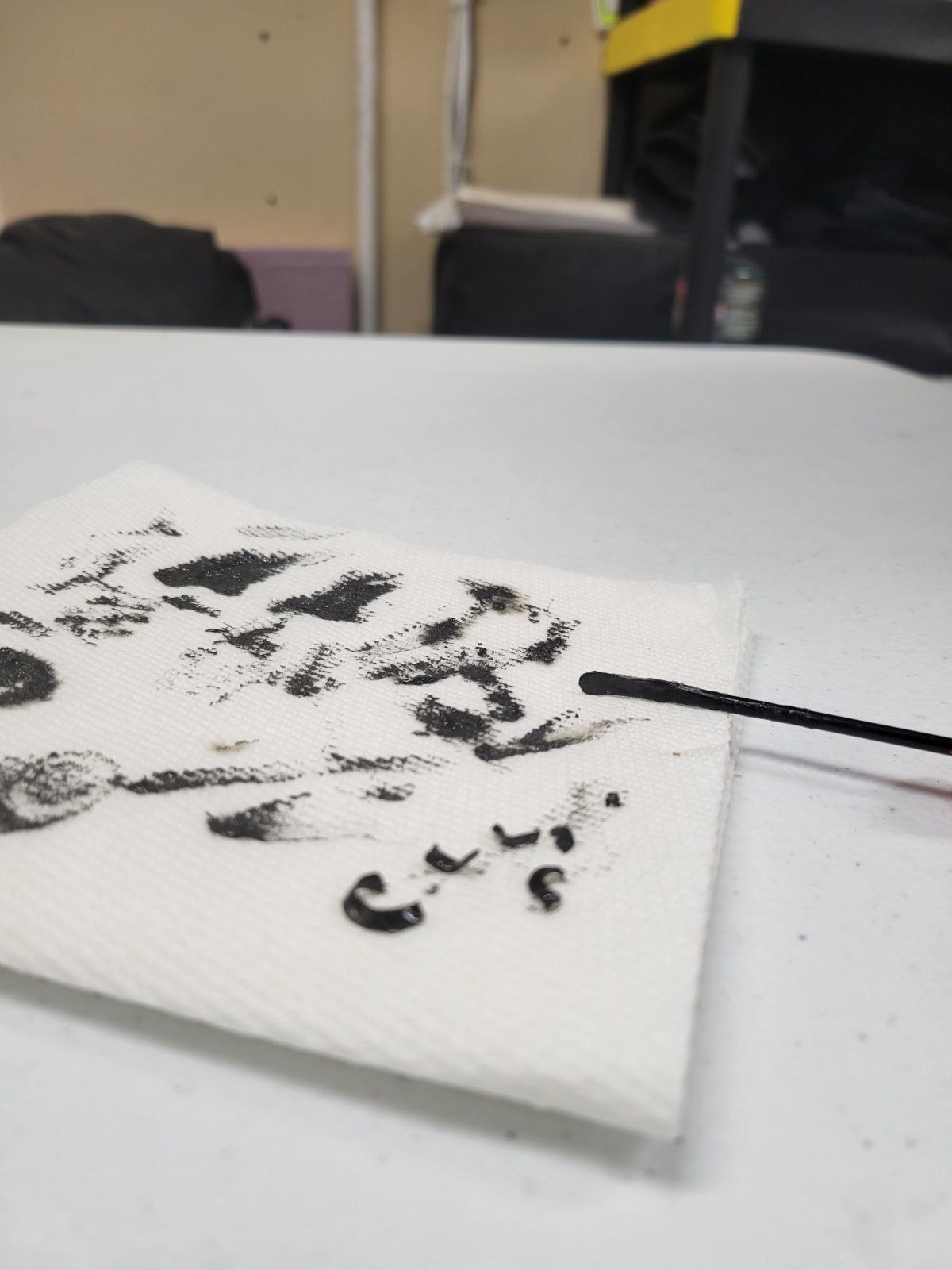

    I just performed 1st rear diff fluid swap
    Found metal chunks on the magnet
    Looks like a rivet to me
    Fluid seemed pretty good for 93k miles & did not smell horrible surprisingly
    5.5 qt out & 5.5 qt back in
    Does any one know the exact torque specs for fill & drain bolts?
    I set them to 40 both
    Also the valve line flex fill fluid containers make it so easy & fast to refill the pumpkin....no more pumping the pumpkin for me...20240414_124228.jpg 20240414_123410.jpg 20240414_123413.jpg 20240414_124221.jpg 20240414_131304.jpg

    The good news is that nothing is failing in your diff. Those pieces are leftover debris from when the axle housing was machined. Although alarming to find, it’s not a big deal, and not all that rare on the first fluid change either.

    Looks very normal for the initial drain and fill, those are shavings from the milling process.
    I saw the same material in my '17 40k miles ago. Do a search, there are several threads on it.
