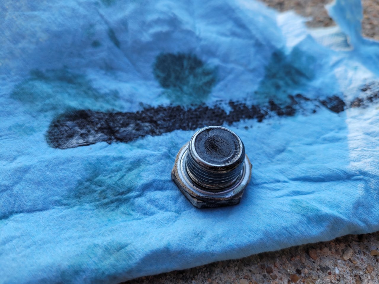

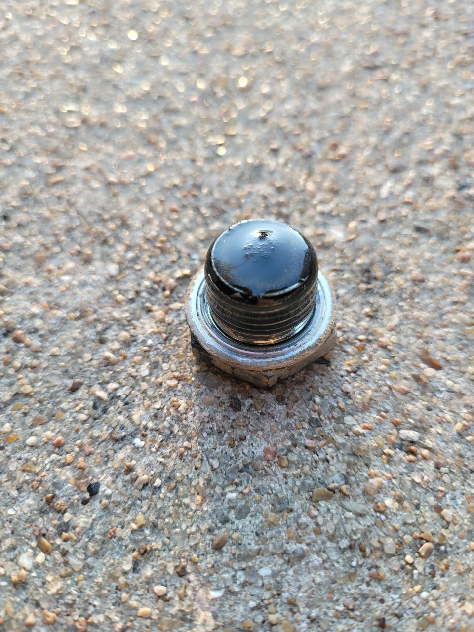

    Just changed my rear diff fluid, I was running Schaeffers 75w90 full synthetic. 58k miles on fluid, 234k on truck. I did tons of towing during this interval, and I'm pretty hard on my truck. Lots of offroading too. The fluid smelled just like it did whenever I poured it in, and didn't seem to change color much, the Schaeffers has a slight green tint to it from the bottle, which I can still distinguish. The magnet had fine particals on it, zero chunks. I took a sample to send to Blackstone, but after seeing how good the fluid looked and smelled, I'm certain it will be a waste of money.
    I switched to High Performance Lubricants 75w90 for this interval.20220130_172407.jpg 20220130_172436.jpg 20220130_180306.jpg 20220130_180418.jpg

    Once you use some good quality gear lube, hard to go back when you get great results like this.

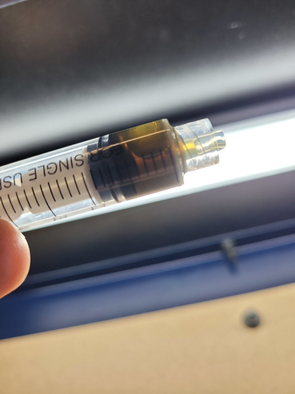

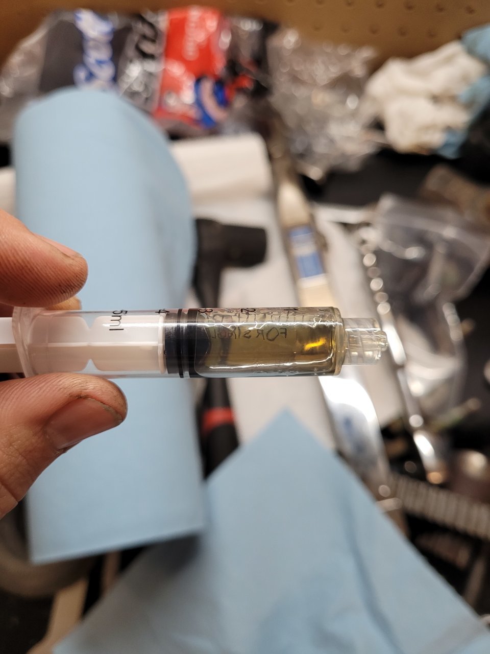

    If you want to get a good idea of how long your diff fluid will last, take a sample from the fill plug and send it to Blackstone, just refill whatever you take out. They'll tell you if it's still good to run or not, and give you a mileage at which to send another sample for testing. I'll post one of my random UOAs so you can get an idea.Screenshot_20210809-090229_Acrobat for Samsung.jpg

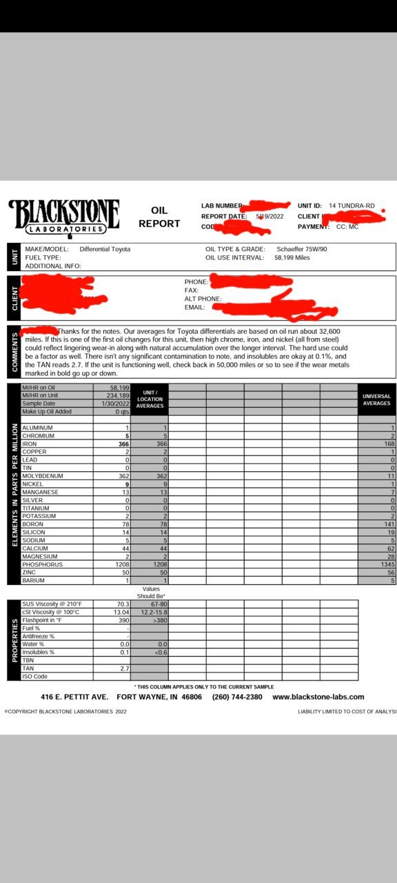

    Sounds like a good report!

    I'm gonna be curious about the next report. I might sample it at 50k, so gimme a couple years lol

    Interesting. Guess the additive pack held up and the wear is about double the average. Which makes sense given the average sample is half as many miles.
