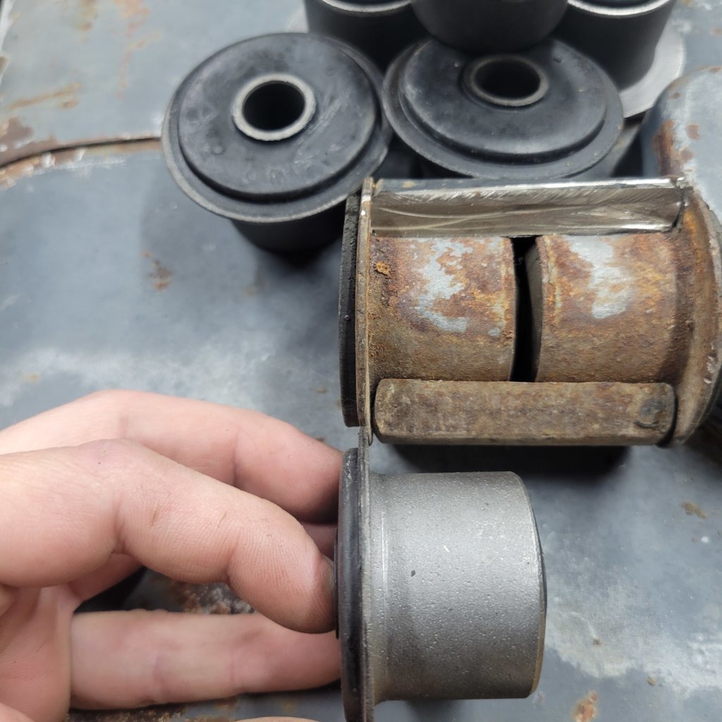

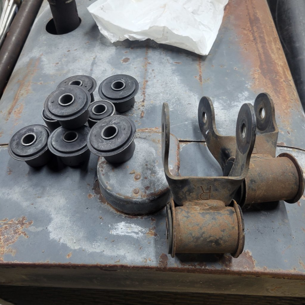

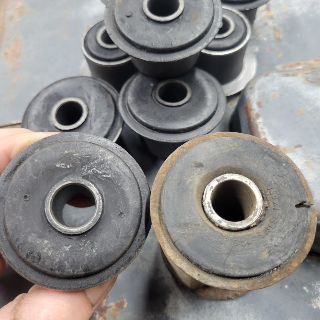

    RB-260 comparison pics to OEM
    Looks like I have these in the need to find a good home pile too.

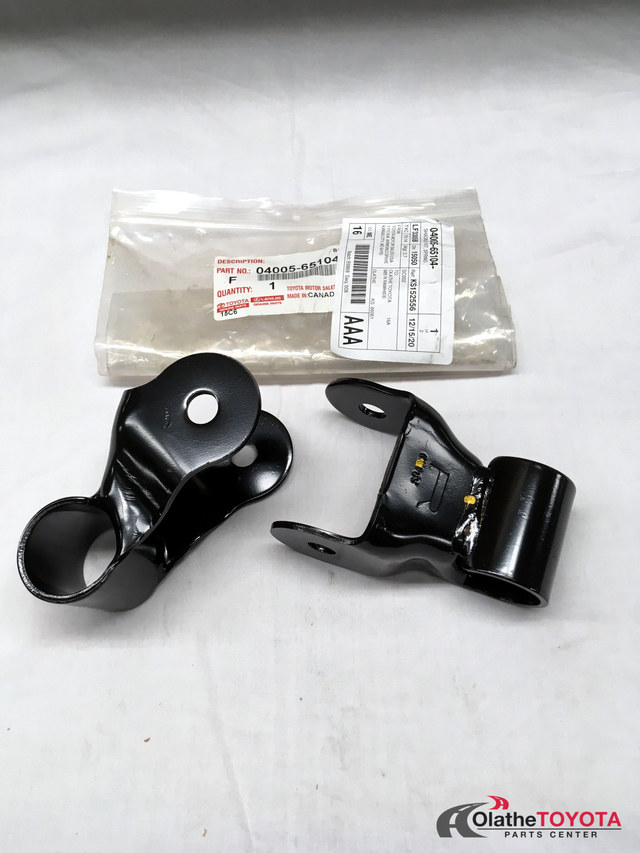

    I came across this part number, but I'm not sure if this is compatible with our trucks. It looks to be the shackle but without the bushings. For the price ($24.81), it's probably worth the risk.
    Toyota part 04005-65104

    @empty_lord or @shifty` do either of you know if the shackle part above (Toyota part 04005-65104) will work on our trucks?

    Honestly, you'd need to order one and compare the width at both ends and caliper the inner diameter of the bushing end to see if it is compatible with the bushing for our trucks. That said, you'll need to buy and press a bushing into the bushing end before you can use.
    FYI, ATS does sell a replacement hanger kit and shackles for our trucks. Here's the shackle kit, with bushing pre-pressed: https://www.autoandtrucksprings.com...-shackle-kit-oem-044830c030-480420c011-bt-t9/
    Currently at $70/side, which is potentially close to what you'll pay for two of the ones you're showing, and the bushings and hardware?

    Thanks for the suggestion. I'm tempted to test it out.
    I already have bushings on the way. Thanks to the post by Eric at Archive I got the bushings for about $3/each.

    Looking at @JakeJake's cutaway pics up there, I wonder how fruitful or helpful it would be to pop a zerk in the ass-end of that hanger to lube up the bushings?

    I think the rubber will be long gone by the time that the outer shell of the bushing causes any issues. Drilling spring steel is rough even with an ideal setup.
