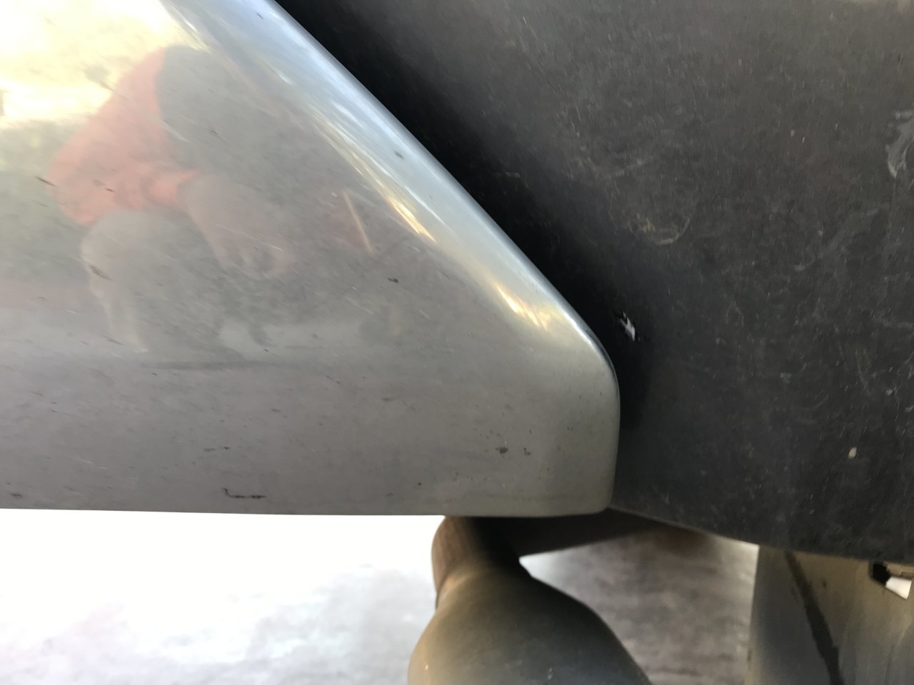

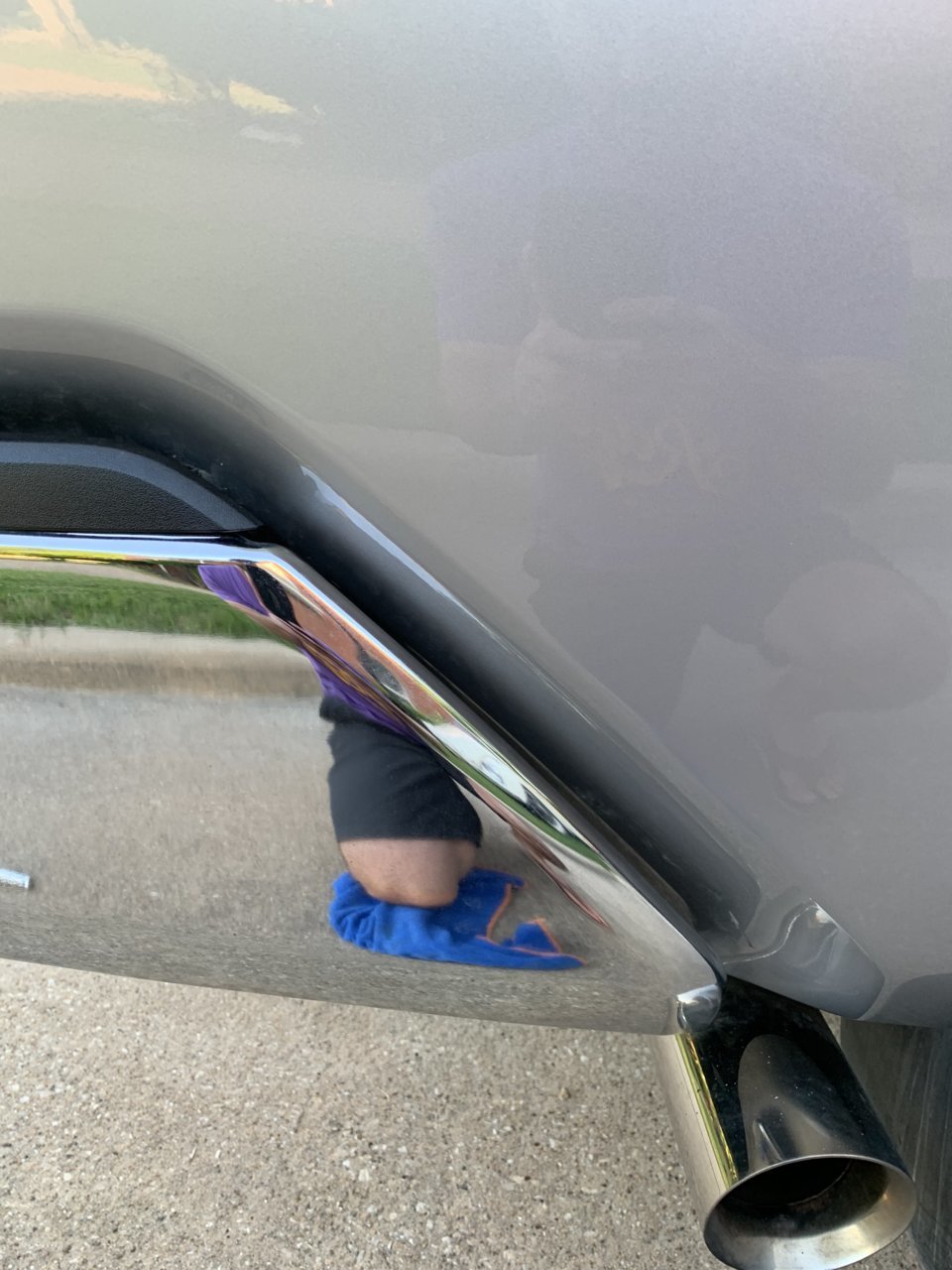

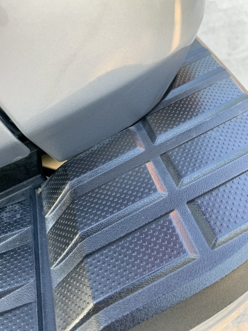

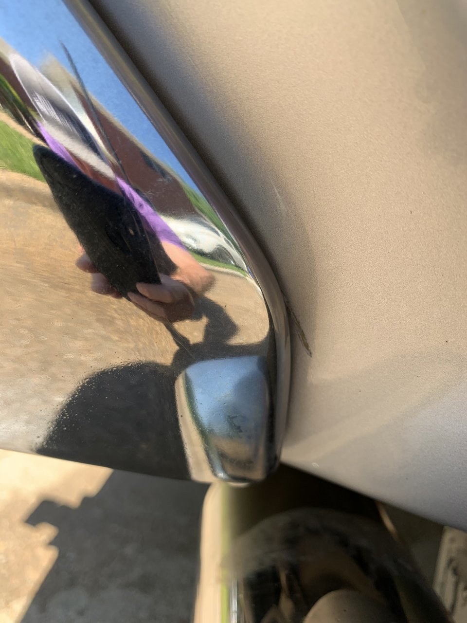

    anyone ever heard of or seen the rear bumper shift on one side? Was just washing my truck and noticed on the passenger side the bumper is all the way up into the truck body and paint. Haven’t gone hardly anywhere in weeks and when i do I park at the very back, backed in a mile away from everyone else. I’m baffled because there are no scrapes or any markings to indicate I was hit.. nothing appears bent...? It’s pushed in so far it cut into my paint on the outside edge. Pics attached along with a few shots of driver side for comparison. Driver side still has the normal spacing.

    Looks like it’s been hit.same exact thing happened to me. Check under the bumper. There is a metal strut that stabilized the body panel of the bed just behind the bumper. Mine was bent on the side that was touching the bed. It’s like 4000 dollar fix since they have to replace the bumper and paint/ clear that paint damage. If you go through insurance...

    Looks to me like it was pushed in. Hard to believe it moved that much on its own

    It looks to me like a dent in the very bottom of the right side bunper

    Something had to have pushed it in. What's it look like underneath in regards to the brackets etc.?

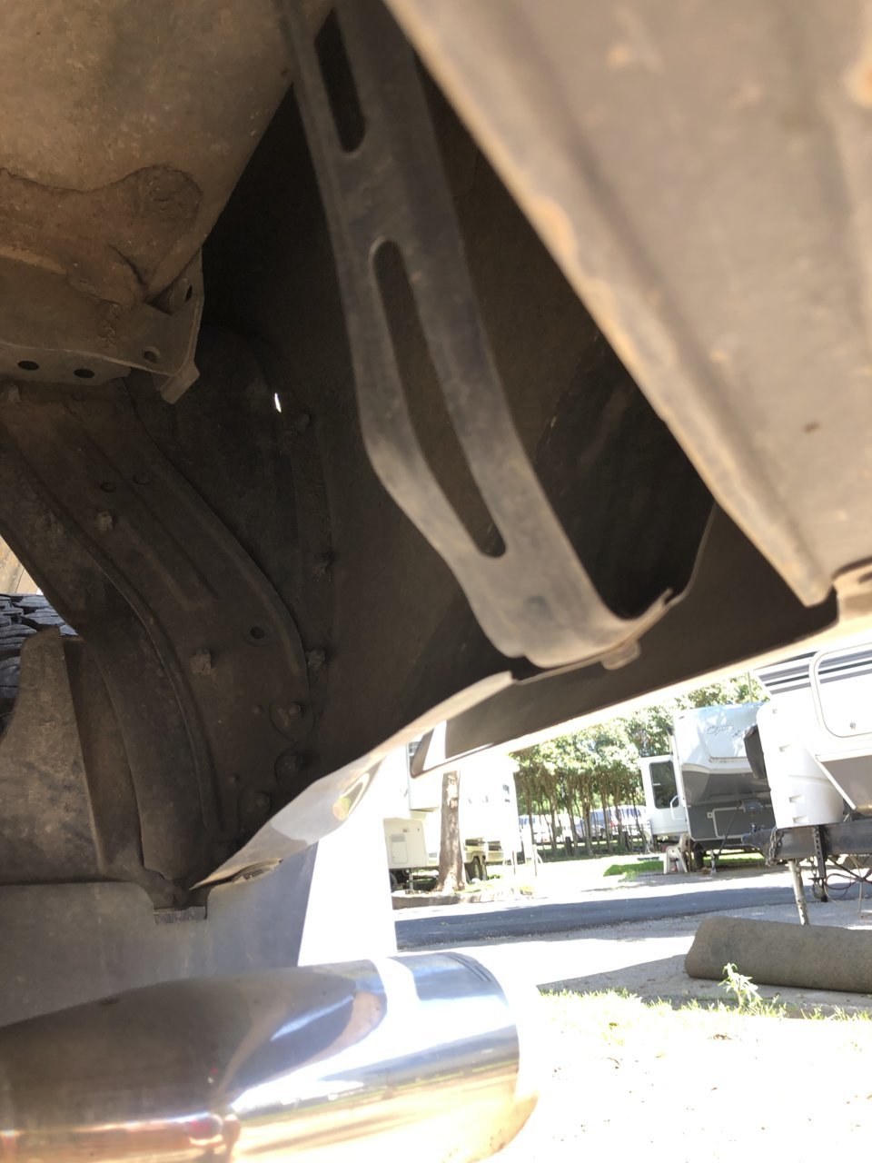

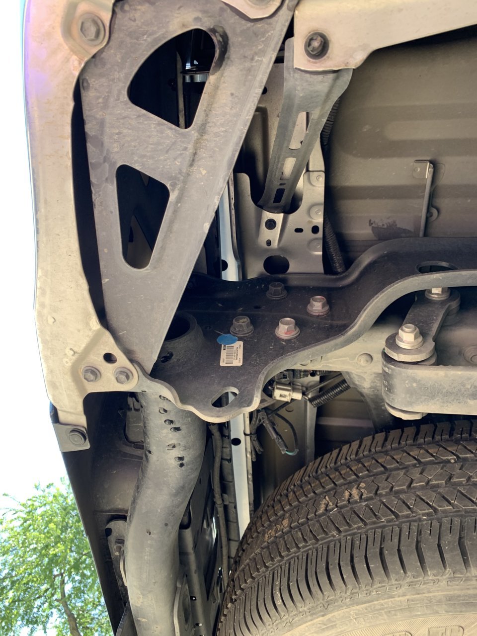

    Guess someone popped me at the grocery store, I took some pics from underneath and don’t see any bent pieces

    This is the piece that was bent on mine. Check the trueness all the way up to the bed and compare it with the other side. Sucks man. Sorry this happened to you.

    Is that piece able to be pulled off and straightened out any?

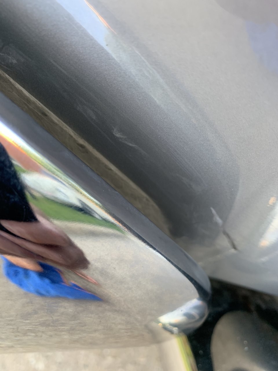

    Looks like the OP just needs to replace the bumper end cap. So not including the paint it is hundreds not thousands.

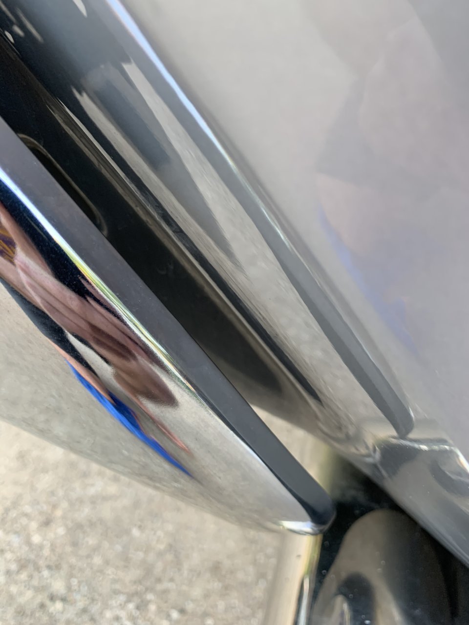

    End cap not damaged at all though, I’m wondering if I can RE adjust it.

    Something’s tweaked. It was bolted in place and has been forced out of position. Metal has been bent. Not the bumper cap, the bumper most likely. You can most likely repair it but it will never be as strong again. Seems to me like that’s a bad thing for a rear bumper.

    Pain in the ass!! Thanks for the help guys. I’ll pop the cap off the top later and look in more detail. The sun is beaming right now so hard to see way up in there

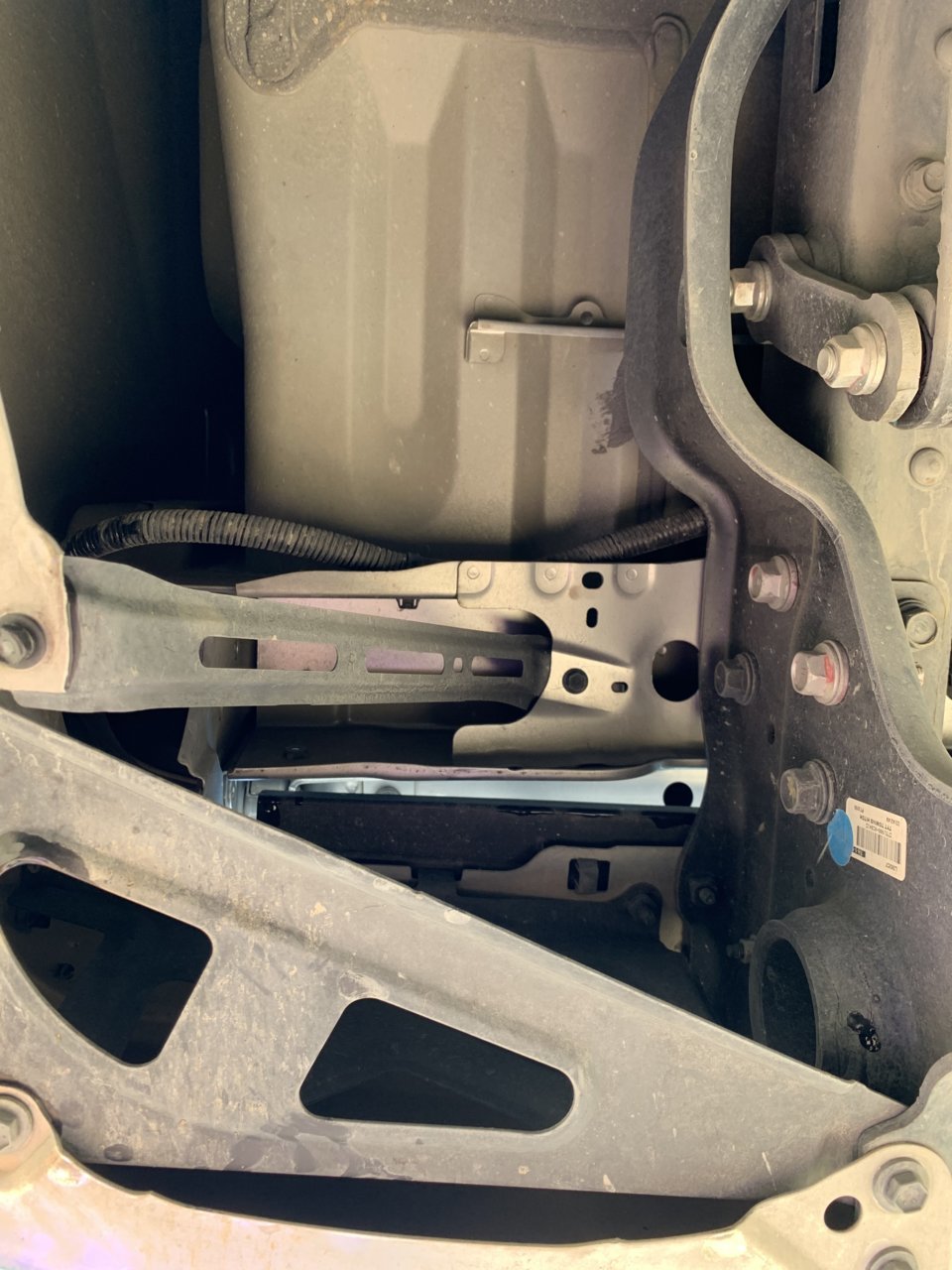

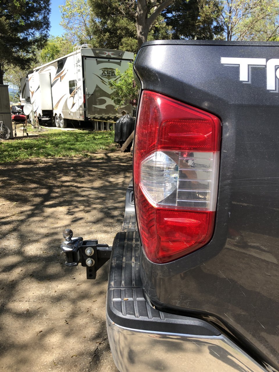

    Here’s mine
  15. Apr 15, 2020 at 1:04 PM
    Tundyfundy
    Tundyfundy Petunia The Tundra, and her sidekick Colbie
    May 5, 2017
    #7567
    2,705
    Bay Area, CA
    Magnetic Grey DC SR5 4x4 2016
    SUSPENSION: Bilstein 6112 coilover (1.9") w/ Powder Coated Springs and Spring Perch (TRD Red), JBA Upper Control Arms, Bilstein 5160's w/Billet Aluminium Reservoir Brackets, +2 Coachbuilder Shackles, Diff Drop Kit, Carrier Bearing Drop Kit, Brakeline Extensions, ABS Extension, Poly Bushings for Leafs, Coachbuilder Shims (2 Each Side), Coachbuilder Bumpstop Extensions, TRD Rear Sway Bar, TRD Front Sway Bar, Air Lift 5000 airbags w jounce bumpers, Daystar Airbag Cradles WHEELS AND TIRES: BF Goodrich KO2's 275/70/r18, BORA wheel spacers 1.25", TRD Wheel Caps,TRD Valve Stem Caps, Spare Tire Lock PERFORMANCE: Bullydog GT Tuner(Performance Tune), TRD Intake, TRD Dual Exhaust (with Modified Exhaust Hangers for Levelling Tail Pipe),TRD Brake Pads, TRD Oil Cap (US), TRD Radiator Cap, TRD Oil Filter, Optima Yellow Top Battery,GP Battery Distribution Blocks, StopTech Slotted Cryo Treated Rotors, Goodridge G-Stop Steel Braided Brake Line Kit PROTECTION: PNP Engineering Type 4 Rock Sliders (With Full Dimple Plate) ,ADD Stealth Fighter Rear Bumper w Red/Blk Shackles and Custom Stomp Pad, TRD Skid Plate with ReadyLift Spacer Kit, Victory 4x4 LCA Skid Plates, JOMAX ABS Sensor Armor, Rear Diff Breather Mod, ARK splash guards INTERIOR: Husky Liners X-Act (Front and Full Coverage Rear and Front Weather Beater Trans Hump), Interior LED Bulbs, WheelSkins Genuine Leather Steering Wheel Cover(EuroPerf), Clazzio Genuine Leather Seat Covers(BLK/DRK GRYwith custom stitching and embroidered headrests), Clazzio Seat Heaters (Front and Rear), Entune Startup Screen MOD, Entune Off Screen Mod, Tinted Windows with Windshield Visor, AJT Key Fobs,Eagle Claws Floor Mat Clips, Bodyglove Visor Organizer,Custom Door Cup Inserts, Glass Break Sensor,AJT Radio Knobs, Custom Dior Cup Inserts EXTERIOR: Full Debadge, LED Brake Light Bulbs, LED Rear Turns, LED Reverse, LED Plate Lights, LED Cargo Lights, LED Third Brake Lights, LED Front Marker Lights, LED Fog Light Bulbs, Lamin-X Fog Light Covers (Amber),2018 OEM LED Headlights, iHacker harness, VLED Universal Puddle Lights, VLED Interior Footwell Lighting (Front and Rear),VLED Extreme Amber Fornt Turns, NSV Knight Rider Light bar, Baja Designs Sport Squadron Pods in Rear Bumper (Driving/wide), Painted Red Tow-hooks, Bed Rail System, Blind Spot Mirrors, Hitch-safe, Tail-gate lock, EAG Raptor Grille, Custom Grille Badge,Full Vinyl Wrap (Matte Black/Matte Pine Green Mettalic), Charvonia Designs Tie Bed Tie-Downs, Bull Ring Bed Rail Anchors, Line-X, Tundra Bed Mat, Bakflip F1 Bed Cover SOUND: Noico 80Mil Sound Deadening and Noico 170 Mil Thermal Insulation (All 4 Doors, Roof, Floors, Rear Panel, Dash). Hertz Uno K170's Component Speakers (Front Doors with Upgraded Sail Panels), Hertz Uno K170 Coaxial Speakers (Rear Doors), JBL C1-075ct Tweeters (Total 4) in Side Dash and Center Speaker, JBL Stadium 5 Amp w/Remote Bass Adjustment Knob and Amp Rack, 12" Infinity Reference Subwoofer in Custom Enclosure w/ “TUNDRA” Logo, Fast Rings Foam Speaker Rings System(4 Doors), Fix 86 DSP
    Granted you don’t have to replace that strut. Also when mine was hit it tweaked the tailgate so make sure you’re is straight. You can see the difference on each side. First pic is bad side, second pic is good side.

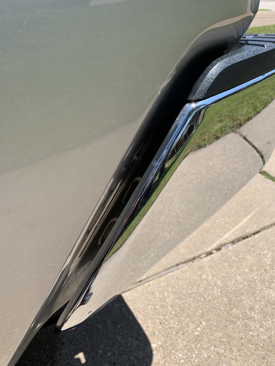

    Update:
    loosened the bolts underneath, grabbed the edge of the bumper and pushed my feet into the spare tire for leverage. I was able to pull it back enough to get it off the paint.
