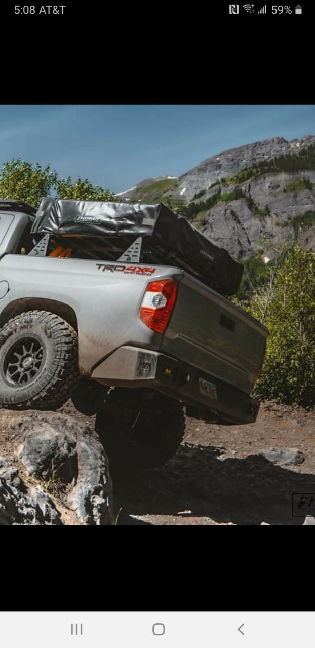

    I purchased a C4 Bumper and I will be putting S2 pods in them like the picture shown. I will be running a switchpro 9100 in the engine bay and I was wondering what y'all recommend I use for a harness to reach all the way to the bumper. Baja designs doesn't make anything that long that I can see. Any help is appreciated.

    I sure hope that bumper only fits like that because he got yanked out of a mud hole or something. o_O

    @C4 Fab. Did this bumper get yanked out of a hole?It doesn't line up with the truck.
