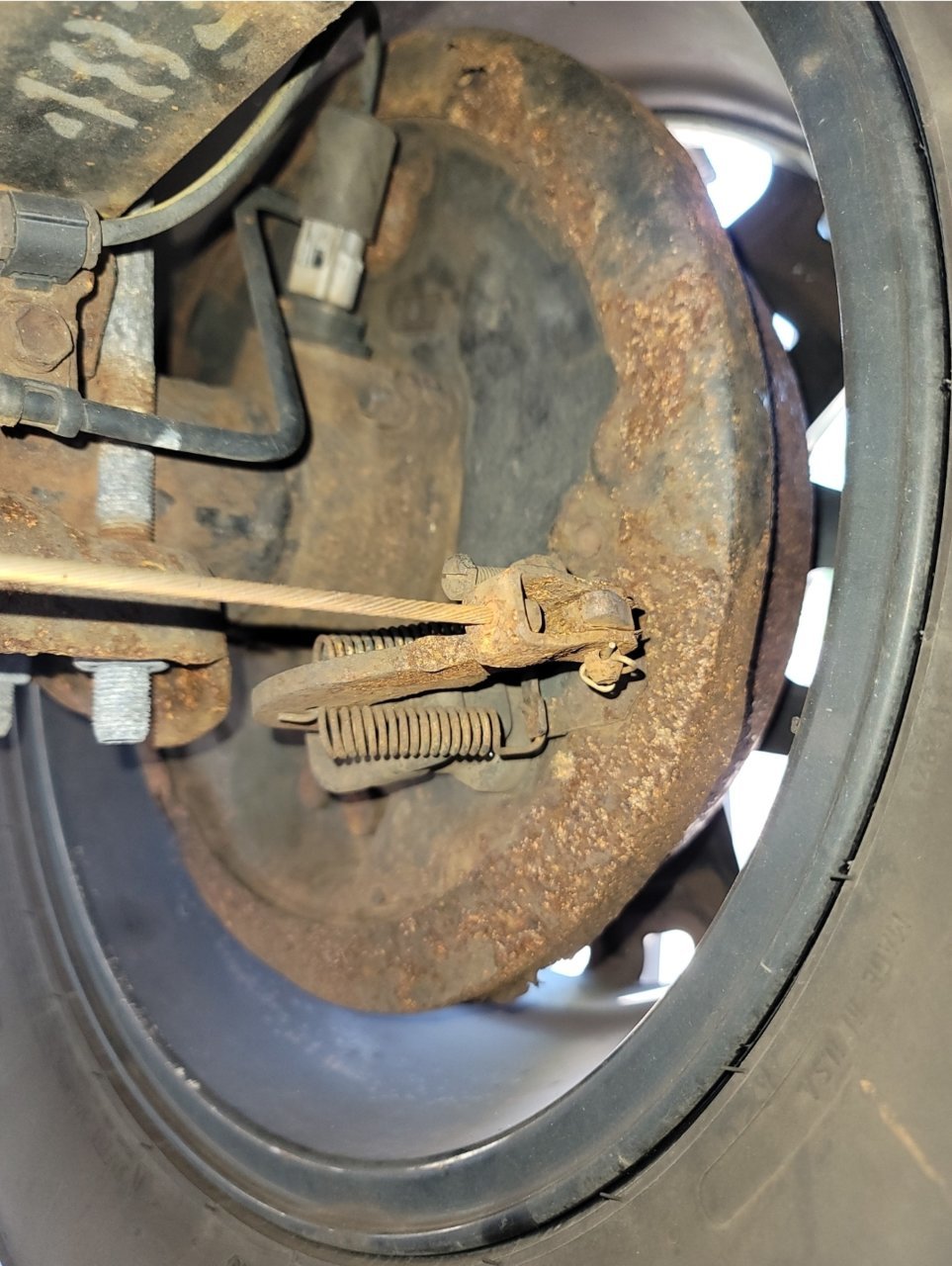

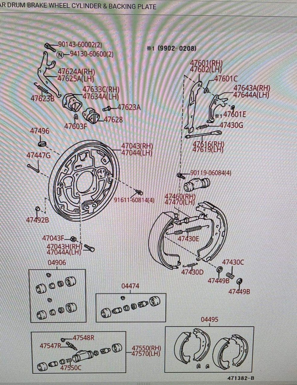

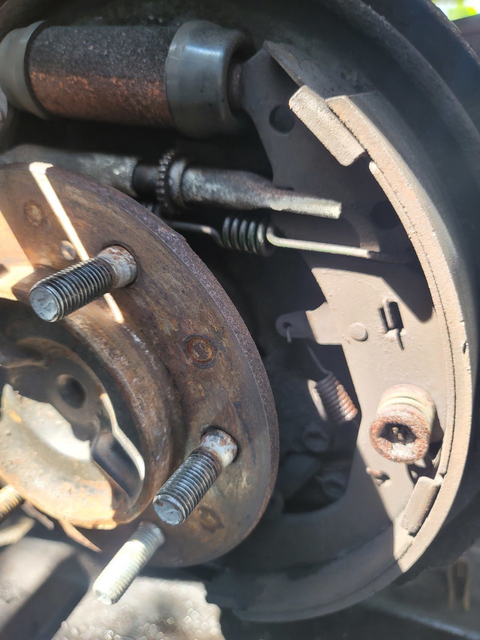

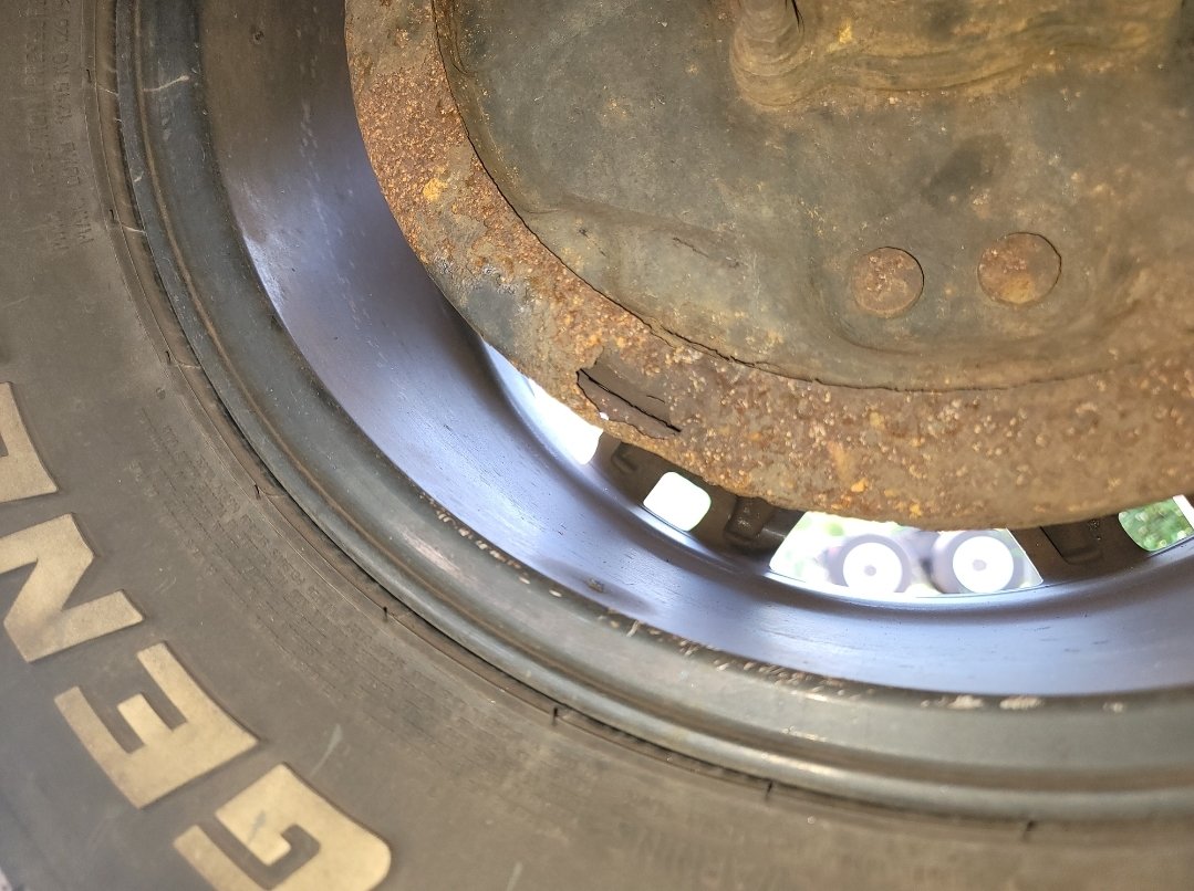

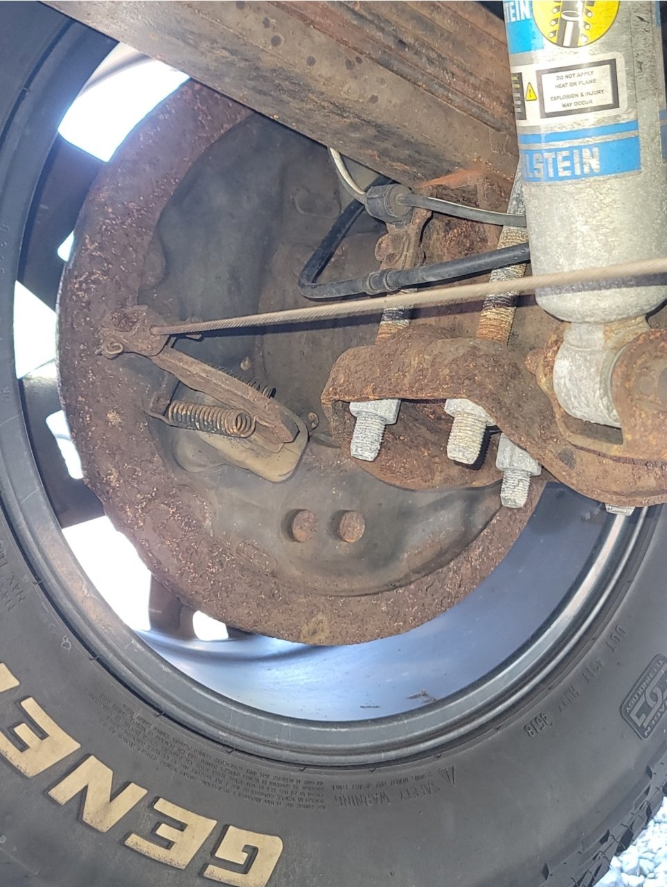

    So to make a long story short I'm in the process to redo my rear drum brake. I ordered everything directly from toyota to rebuild the rear drums including the parking brake cables. Now the issue is I was going to rebuild everything without changing the backing plates because I don't have a press and didn't want to deal with removing the axles.
    The issue I was going to start the project today and noticed that 1 of the backing plates has a hole and not sure what to do.
    I have spent approximately $1000 on parts now I'm thinking if I have to replace the backing plates should I just try and sell the Toyota parts and do a disk conversion kit for around $1200?
    https://www.silverminemotors.com/to...e-upgrade-swap-kit-backing-plate-with-e-brake
    Any suggestions are appreciated as I'm kind of screwed snice I definitely did a rookie mistake and didn't evaluate the situation first.

    Take the inside brake parts off, use metal epoxy to cover the hole
    , reassemble and call it good?
    YardBird and Mr Badwrench like this.

    Was thinking in that option also but wasn't sure if the backing plates wear down after the years of the shoes rubbing on them.
  4. Jun 25, 2022 at 8:10 AM
    SouthWestGA
    SouthWestGA New Member
    Oct 1, 2018
    #20074
    1,424
    2007 Tundra CrewMAX and 2014 Nissan NV3500 Passenger
    Patch on both sides
    inside and outside

    I'd probably try either of these. I don't know that I'd spend 1000 bucks on a 18 year old truck for that little hole. The upgrade sounds nice though if you have the $$$ to make it happen.

    Then I would fix the hole with SteelStik and put the disc money towards the van. If you sell the truck, you most likely won’t recoup your money on the disc conversion.

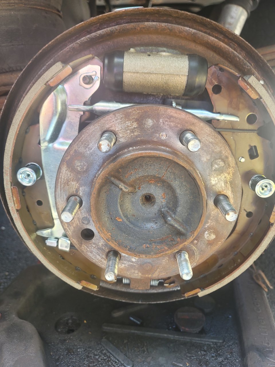

    I have everything in the picture except the backing plates. Also have toyota drums

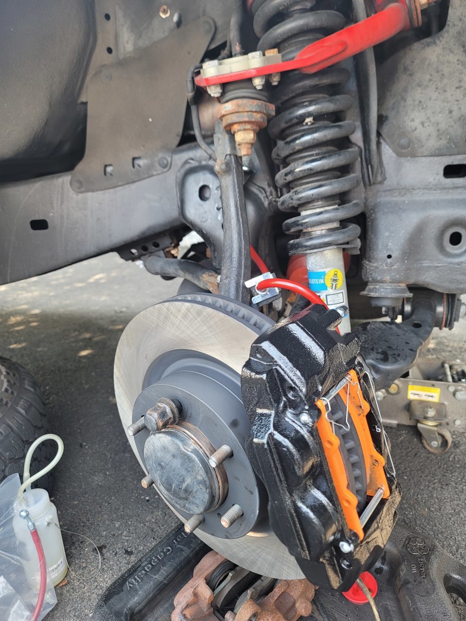

    Ok so a little update I just want for it a did the Gx460 upgrade and also rebuilt the rear drums with all new components. I'm in the break in period but it feels great feels like a new car brake system.

    How does the pedal feel? (For @FirstGenVol )

    Feels great I do have the T100 M/C and Booster. But I really haven't tested it snice I'm in the break-in period.
