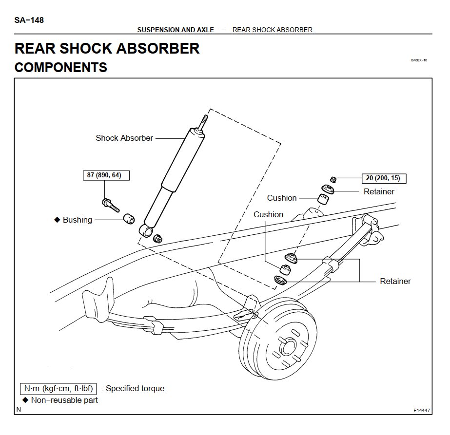

    Here's from the '05-'06 Field Service Manual which isn't your year. But of course, this is for OEM equipment, and is also not for your year. It just goes to show my earlier comment: Not much torque.
    Just like with swaybar links or about anything else with a bushing, it's all about how much the bushing is being engaged. Too much engagement will lead to premature wear/failure. Just want the washer just snug on the bushing, starting to engage the bushing. And if you lift the rear later, remember to readjust the shock bushing.
