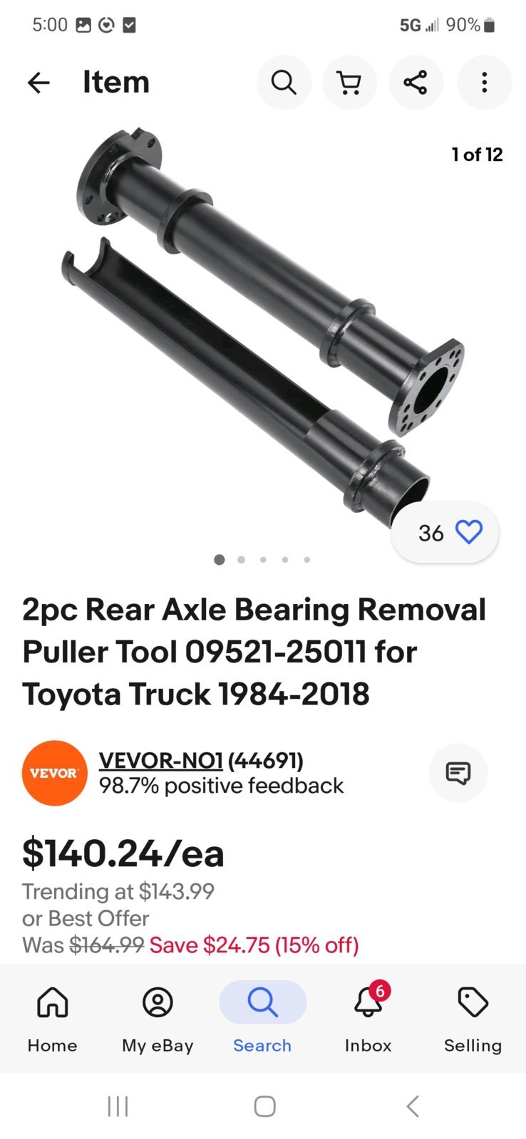

    Anybody have a link to the tool to change these?
    Will this do it?
  8. Feb 5, 2024 at 2:19 PM
    FrenchToasty
    Sep 15, 2019
    #36156
    18,394
    Mo
    The SoAz….. big surprise
    Bone stock
    Yep, that’s what I used
    Half Assed[QUOTED] likes this.

    Curious but why the two piece design? The one we used at the shop was just a long pipe with a flange to bolt to the bearing and the other end had a flange that fit in the shop press.
  12. Feb 5, 2024 at 4:07 PM
    FrenchToasty
    Sep 15, 2019
    #36156
    18,394
    Mo
    Bone stock
    The non bolt flange one is used to press off the retainer and wheel speed gear. The one with the bolt flange is used to press off the bearing if I remember
