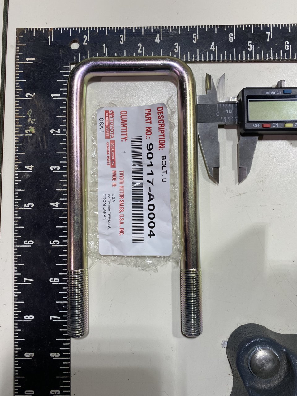

    Unfortunately, I do not have the extra time to visit a shop for a custom option.
    I measured the OEM at 7.5”x2” with a bolt diameter of 14mm. Picture below for reference.

    I just replaced them with stock ones from another member.
