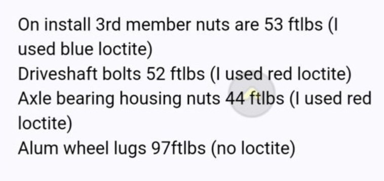

    Does anyone have any idea what the propeller shaft bolt re-torque even is? Nothing on here is really showing what the torque numbers are or what it even is lol

    Is it the four bolts that connect the driveshaft to the differential and transmission on either side?

    Just to clarify I meant the four nuts that hold the axles in on each side. Behind the brake backing plate. Making sure the drive shaft bolts at the trans and diff are tight is a good idea too though.

    Yea i get that. Would you happen to know the torque value for the axle bolts?

    Yea that's what I'm thinking they are cause in the maintenance manual it just says bolt not bolts.

    I don't know the value off hand. but for the drive shaft and the axle bolts, if you can't tighten them any more by hand with a wrench, they're probably tight enough

    Found some torque specs I had saved on my phone.
