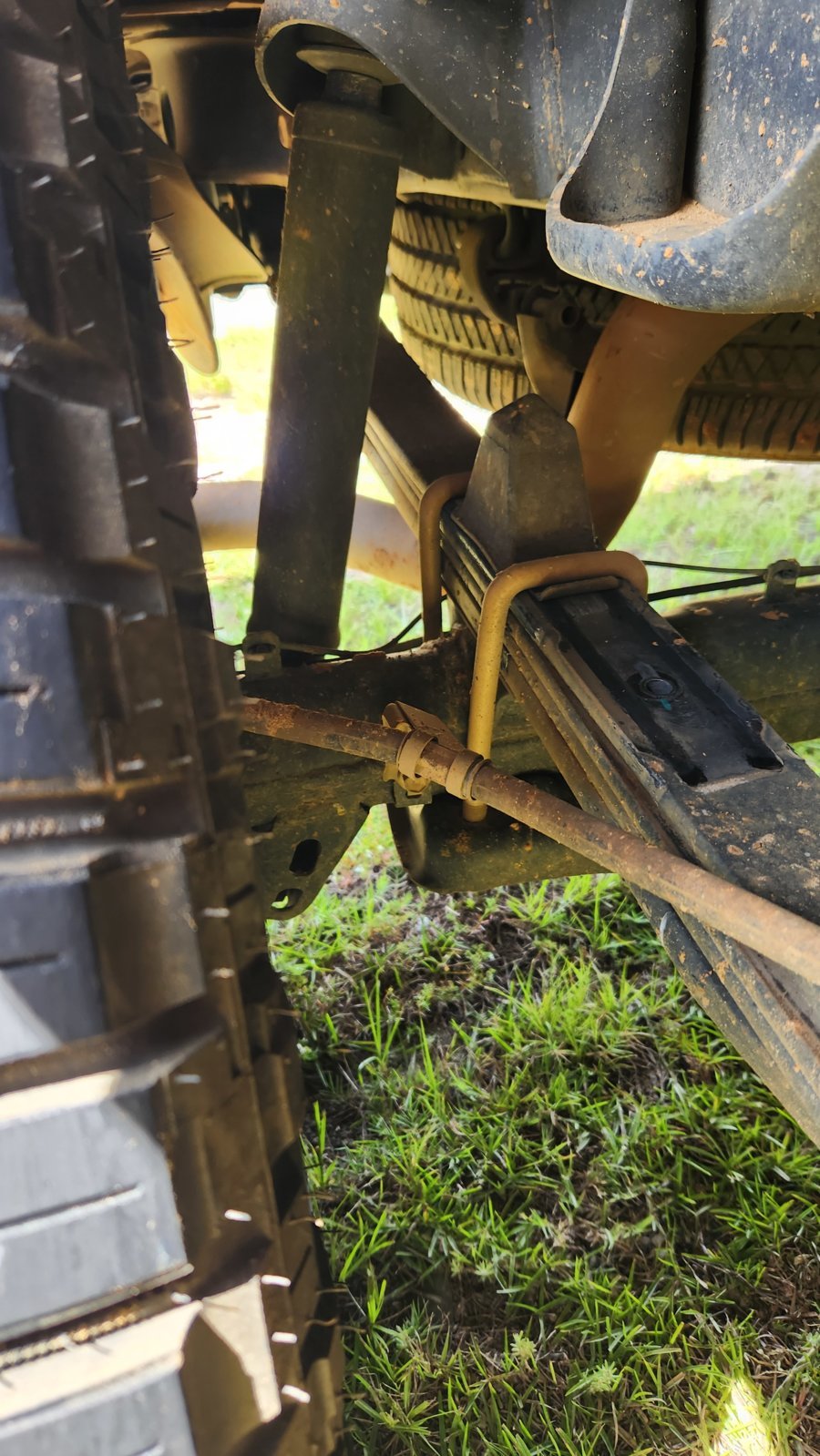

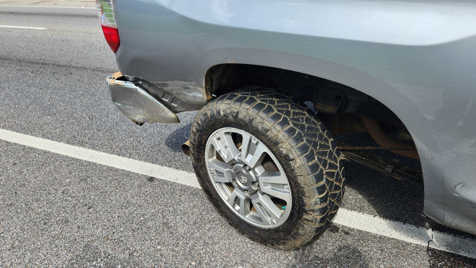

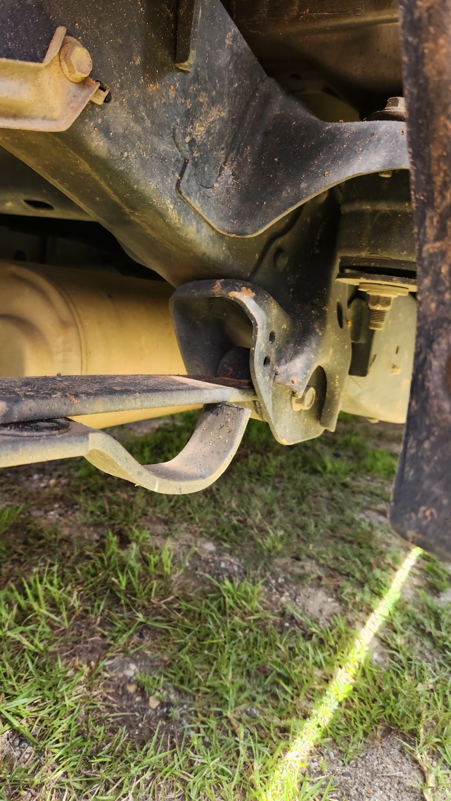

    Hello all,

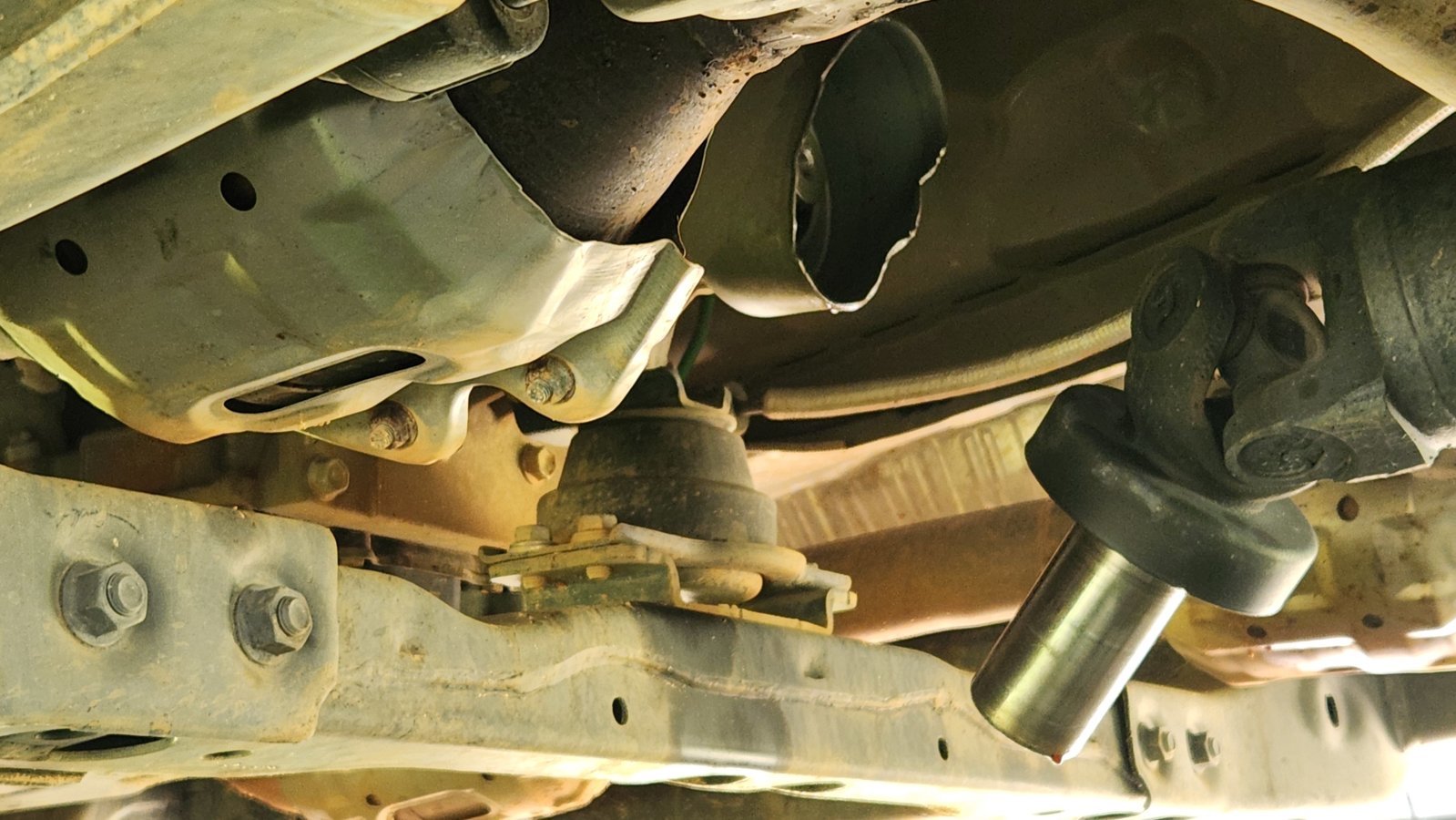

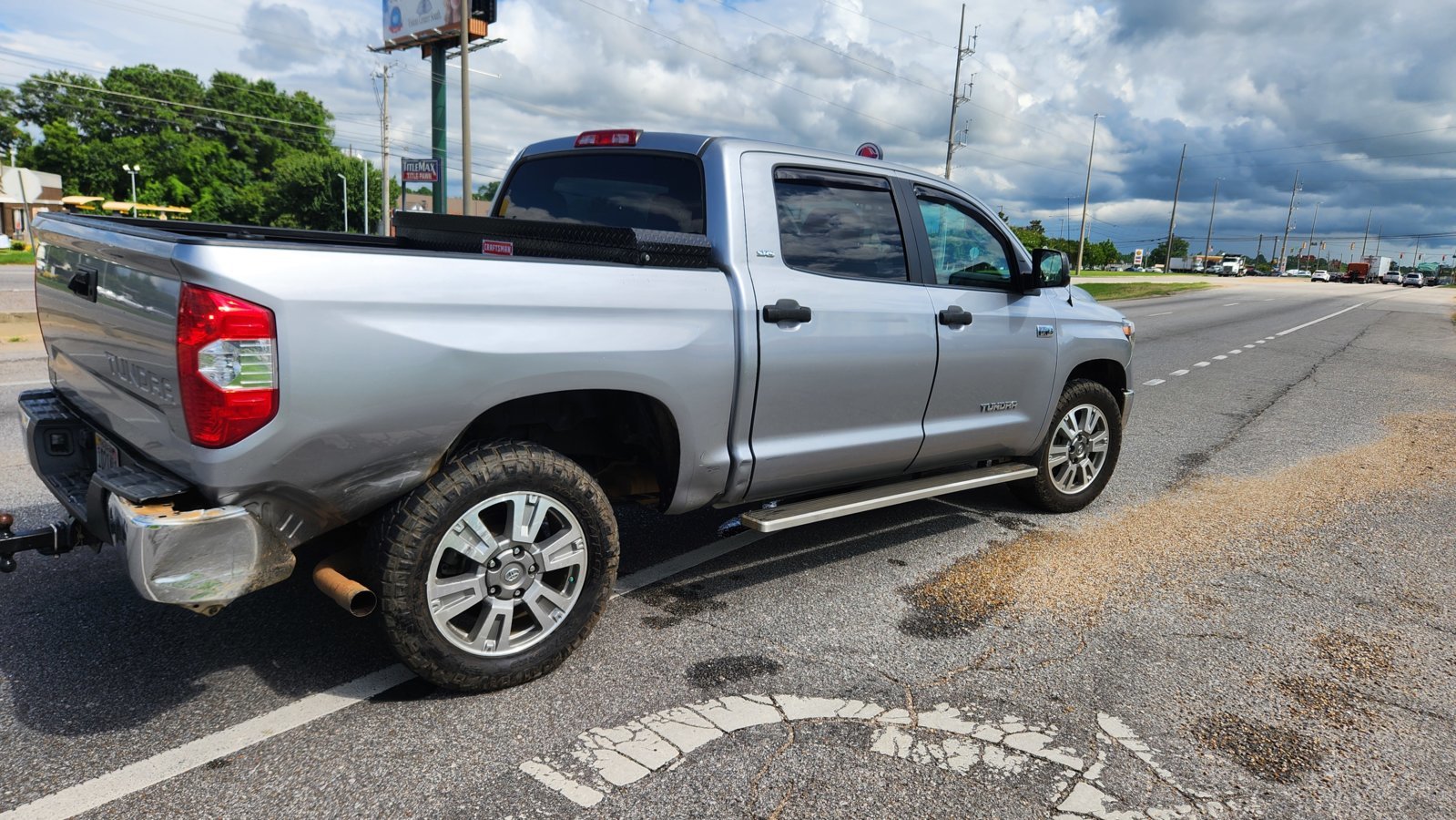

    Going home from work the other day and a lady pulled out and hit he side of my truck. I was running 50mph when she hit me and the wreck knocked the axel back about 6 to 8 inches. Enough it pulled my drive shaft out from the back of the transmission. Still waiting to hear back from their insurance (State Farm).
    My question to you guys is how concerened should I be about the impact to my rear axel. I have allready had to replace the passenger side bearing at a cost of $1000.00 to about a year ago. Im worried about that being damaged again from the impact and also what damage could have happened to the gears.
    What the chances I can get the insurance to replace my rear axel?
    TYIA
    Randy

    Ouch. This smells costly. I see replacements of driveshaft, at least one leaf pack (but they would have to change it in pair?) + shackles, possibly brake and ABS lines. Plus bodywork. Pinion bearings in rear diff and transfer case would need to be evaluated, too.

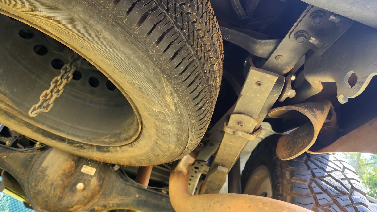

    is the pumpkin against the spare? If so, the chances of the rear end being tweeked are greater. These aren't made of cast steel anymore.

    Really not sure. Can't tell from the pictures and right now it's at the wrecker yard. Will have to take a better look at that.

    I had a hit between the back door and bed that sheared the axle clean off the leafs like that. Ended up cracking the transmission tail housing. Due to other damages the truck was written off so idk how much or involved it would be to replace.

    Might have a bent axle housing, don't take much

    That rear transmission output shaft housing looks broken to me.

    this...they'll have to tug at the frame, replace some hangers, springs, entire diff (Likely), wheel, bed side and bumper at bare minimum. Start saying your goodbyes

    I'd be shocked if the axle housing was still straight.
    If it's totaled I would buy it back, find a used axle housing (or complete assembly) and swap a few parts. Should be pretty easy to fix from the look of it.

    Got a call for the Body Shop yesterday. Their initial estimate is at $20000.00 plus so far. He said it will mostly likely be totaled by the insurance company. So far he said the Rear end, Drive Shaft, Tranmission, Spring Hangers, Springs, Rear Bumper, Exhaust all have to be replaced. Thats not including the Body repairs. Looks like I will be in the hunt for another truck. Still waiting to hear from the insurance company.
