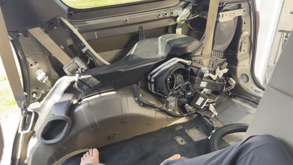

    I have a 2017 Toyota sequoia limited. The front A/C works just fine and blows cold air, however on last weekends trip to Valdez the rear A/C stoped blowing. I have full control with the rear control panel but changing between hot and cold and the three different fan settings does nothing. The unit will correctly display the set temperature and my selected fan setting but no airflow comes out of the vents. I have ensured that the rear climate control is on and that the vents are open. I have also checked all the fuses and they are good to go.
    I think it might be a rear blower issue but I can only find a video about a ~2006 LX470 with the same issue.
