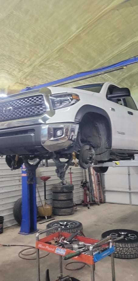

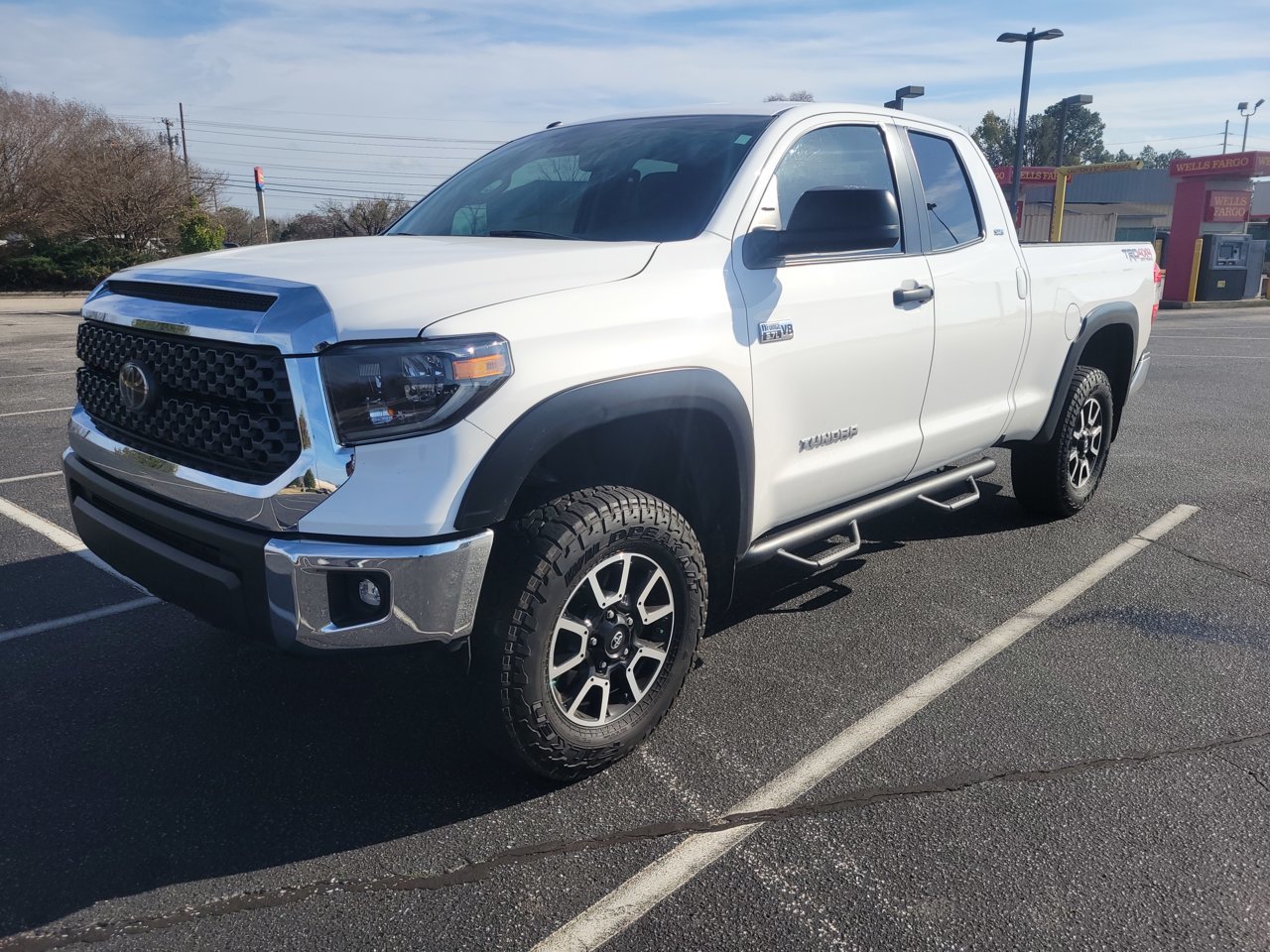

    Had my readylift 3/2 installed yesterday.
    Not bad looking. Next up 295 70 18sreceived_1944182909085469.jpg 20211229_115558.jpg

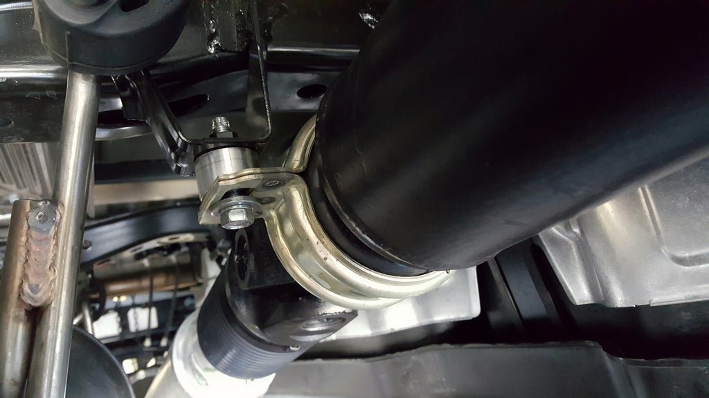

    I had that kit on my 2013 for a year and a half. Rode rough as hell on FL roads so I switched to coilovers and shackles. Make sure you install the carrier bearing dropdown spacer.

    Gotcha. I assume you bought the carrier bearing kit separately since they don't come with the Readylift.

    Yes you would be surprised at how many people have never even heard of it or what it is for. It should look like this if one is installed. If not, the good thing is that they are only ~$15.00 and the factory bolts are plenty long enough.
