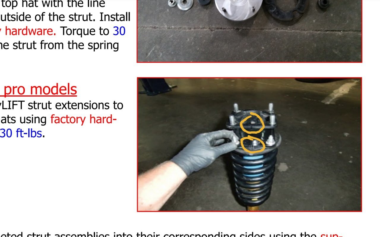

    Hi guys. I’m installing a readylift 4/2 sst kit next weekend. My question is the strut spacer is wedge shaped. Which way does it face? I’m sure I’ll figure it out but if anyone here has installed this kit please let me know. Thanks.

    Here are the instructions. Last picture on page 9 might help.

    This notch faces toward the wheel.

    Thank you Tundra234. That’s what I figured. I got in touch with readylift as well.
