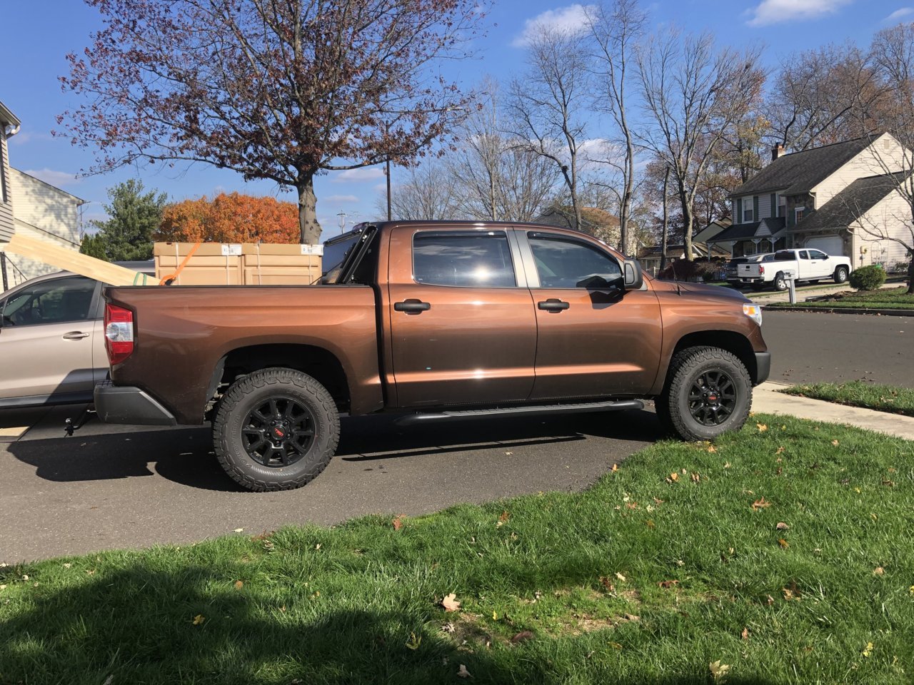

    I would run the 5100s at the middle or top setting and not use the spacer at all upfront.
    for reference I run 5100s on the middle setting with a 1” block in the rear

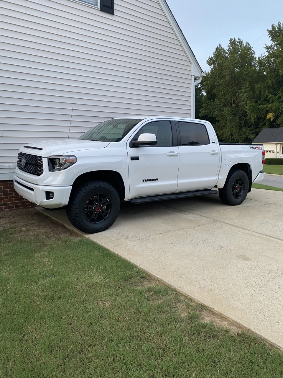

    My son and I were literally just talking about that lift level for our next truck adventure and this was what we were thinking too. I've heard 5100 on top is not the greatest, plus we want a bit of rake for hauling junk in truck bed and the occasional tow.
    Basically a 2/1 lift with Bilstein 5100 all around and using their lift and drop.

    I do not tow anything thus the reason I went top setting on my 5100s for a perfect level with 0 rake.
    BravoDeltaRomeo likes this.
