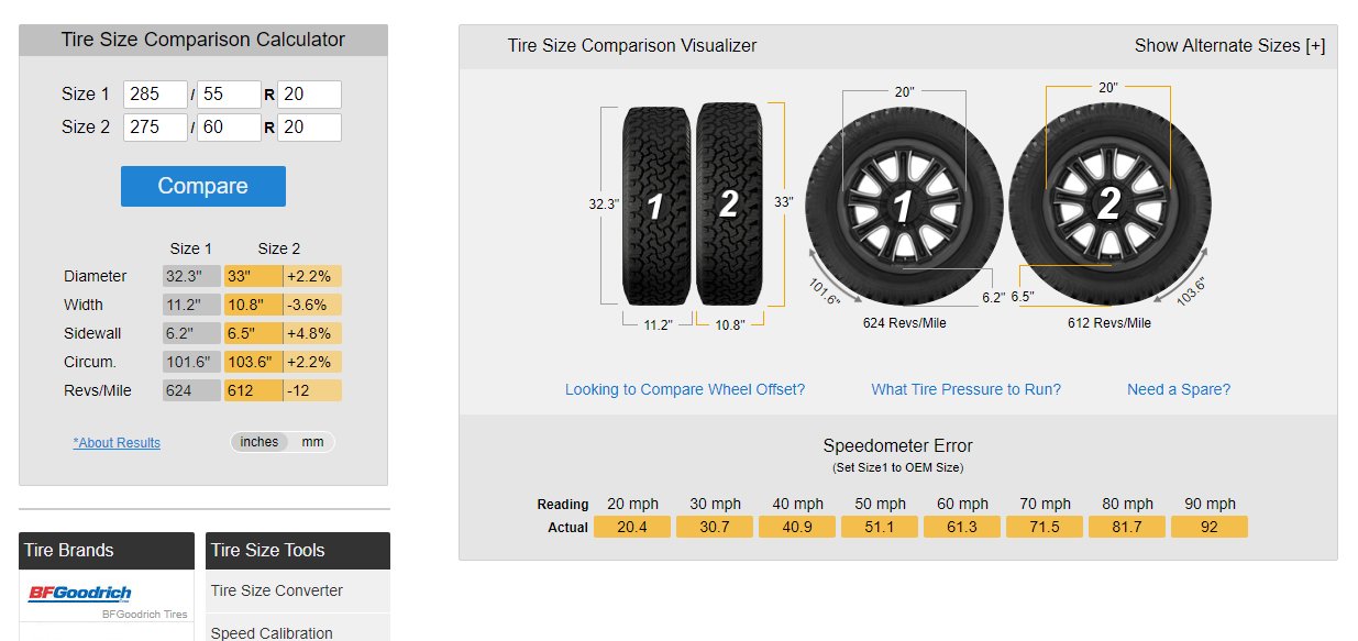

    I have the TSS gunner and there are +55.
    There is a stamp on the back of the wheel that will tell you for sure.
    A 285/55/20 tire will look a little short with a lift/level.
    I have 2.5" front and 1" rear lift on my 2014.
    I'm running 275/60/20 on my TSS wheels.
    A little taller and a little thinner than the 285/55/20 it came with.
    I honestly feel my 2014 drives better with the thinner tire..
    The calculator page @frichco228 posted can tell you the difference in the tire sizes as well. upload_2022-12-4_15-45-0.jpg
