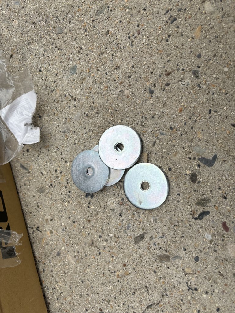

    These 4 washers came in the packaging and I can’t seem to figure out what they go to. Anyone have the same leftovers?
    The front struts and coils came pre assembled, and the rear leaf came with a new center bolt.
    The rear shocks were put together the same way the 4600’s were installed. (They were original and very tired, but not leaking)

    Those washers are for the front bump stops.

    Thanks Knabores! I’m happy that I don’t need to dissemble anything!

    Just spin the (can’t remember if it’s the forward most or rear most they recommend) front suspension spacers off and add the two washers, spin back on.

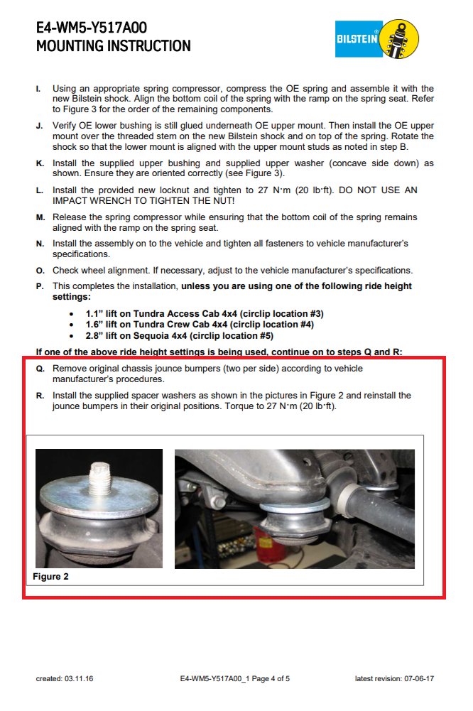

    Bilstein has copies of all manuals online, but I usually hit up Summit Racing any time I need one. Here's a copy, if you want to review your work just to make sure there's nothing else you missed: https://static.summitracing.com/global/images/instructions/bsn-24-261425.pdf
    The biggest issue people usually have is with the stacking of the washers on the rear. I believe your stack is right.

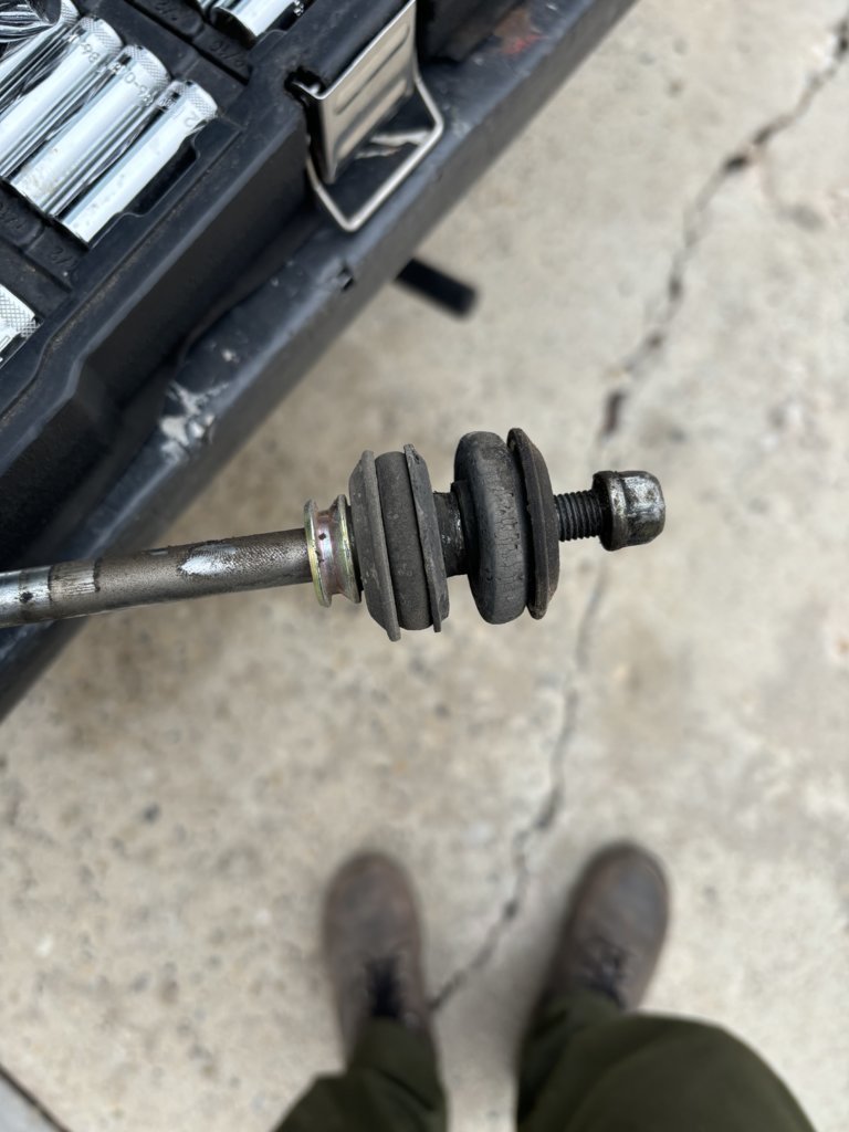

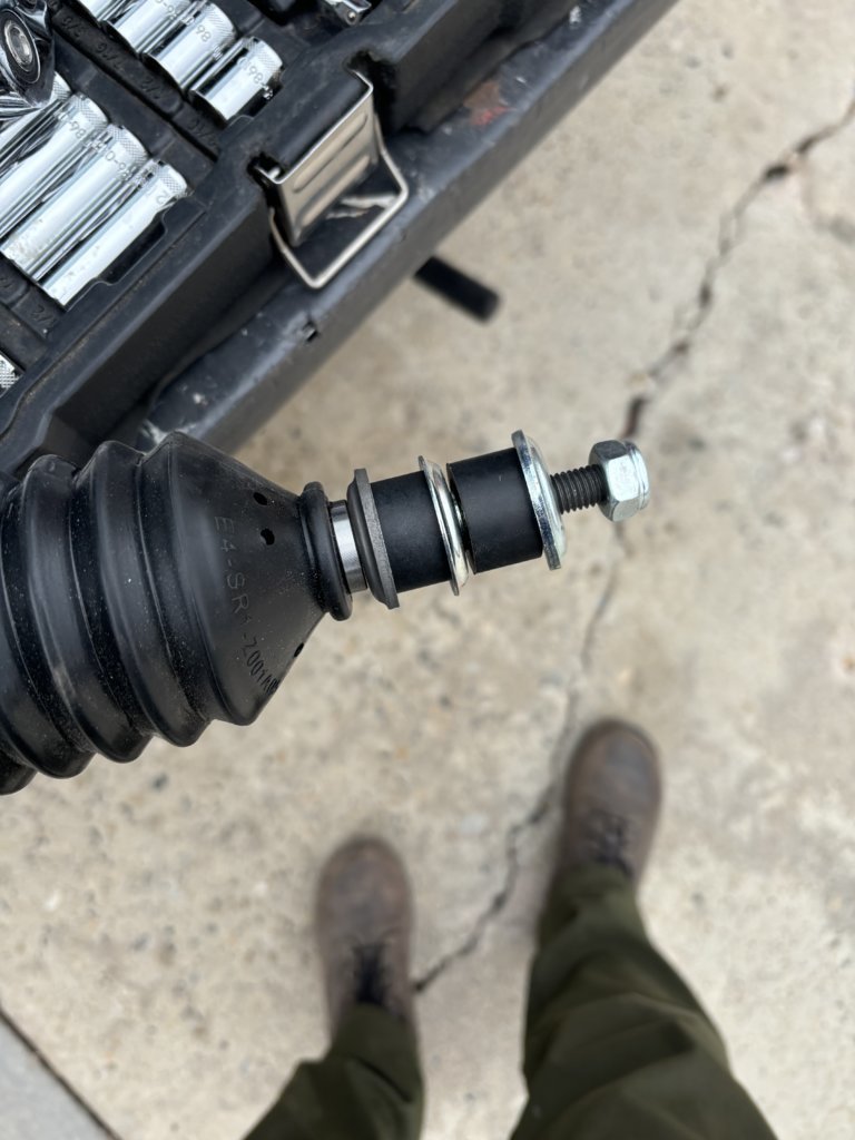

    Don't bother with torque. For both the rear shock upper bushings and your swaybar bushings (which are totally fucked, btw, someone compressed them waaaaay too hard for too long!), you pretty much want to tighten just to the point you start to see the sidewalls go from vertical | to bulge )
    And actually, If you get to the point where they're as bulged as these parenthesis (_) then you've compressed them too much. Somewhere about halfway between being that that squashed and being totally vertical is the limit of how far you want to compress. Over-compression with poly bushings will lead to them fracturing/tearing/disintegrating (especially if you don't use poly-safe lube anywhere the poly touches metal), and with rubber bushings it'll lead to fatigue/deformation/cracking/failure.
