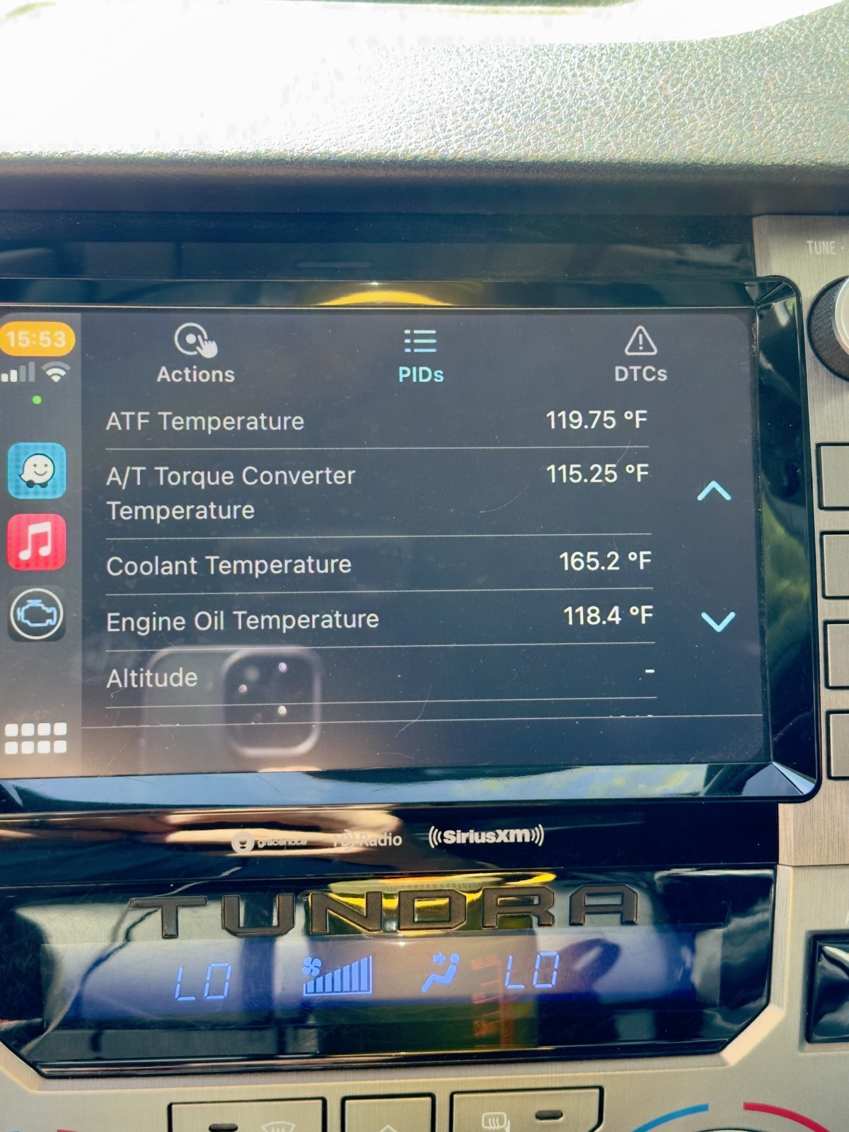

    @Terndrerrr , I very recently learned that the OBD Fushion app works with Carplay. And you can display probably everything to your head unit that you can to your phone, but only in a very simple written line display.

    I scrolled over while driving and saw that yes, it will display through CarPlay, but it was only coolant temp, vehicle speed, and remaining fuel.
    I keep forgetting to mess with it when I’m parked. I’d love for it to display all of the 2021 Toyota PIDs I paid for.
    BillyB[QUOTED] likes this.

    It will. Just have to set it up.

    Here's how the ODB Fushion app displays through Carplay. Of course you can set it up to see many items, these are just the one's I want.

    This is intriguing... Do you know if there's a similar function in Android Auto?
    How exactly does Carplay get it on the screen?
