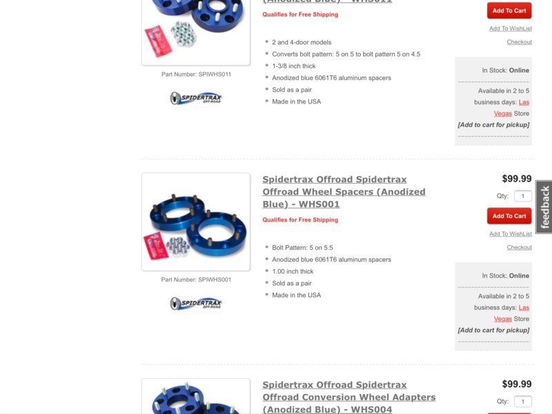

    I saw this.. thought it was 1 inch

    I found them on 4 wheels parts. Maybe they're new 1 inch Spidertrax

    Wrong bolt pattern. Think its for a different vehicle. I believe spidertrax only makes a 1.25 for the tundra
