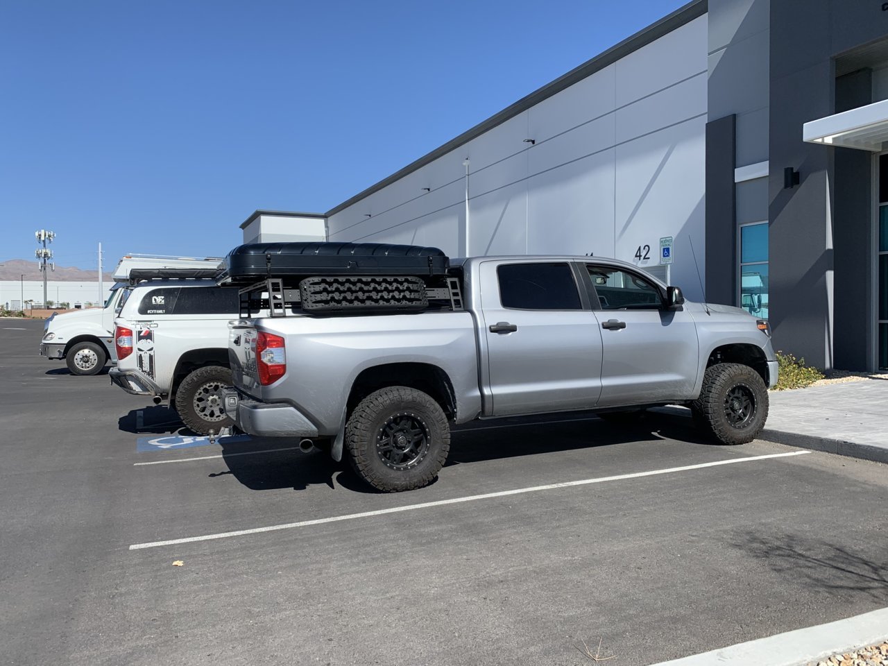

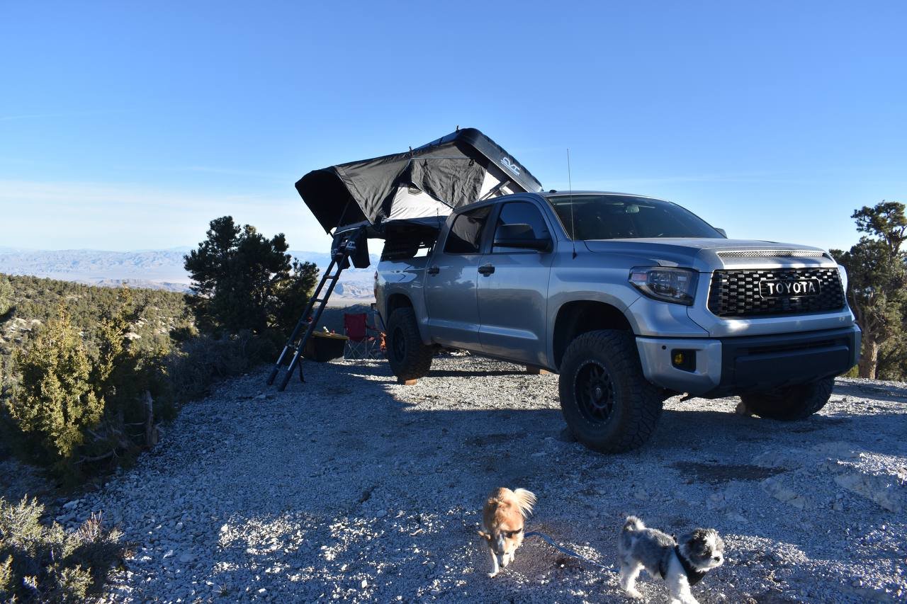

    Hey everyone need advice on gearing. Obviously we all know the frustration of the gear searching the 5.7 is known for so i bit the bullet and ordered nitros 5.29’s with the Eaton lsd looking for people’s experiences with them. I’ll be gong to 35’s once I wear down my 305-70-17’s (tad smaller than 35’s) I’d love 37’s but that might be later down the road idk. currently have a bed rack with a rooftop tent, will be getting added weight from skid plates, possible bumper in the future, rock sliders and truck gets fully loaded with all camping gear and with the whole family. Planning for future when I get grow outta this “overland” phase and a get a toy hauler adequate for the truck to handle, so future towing. How much did it effect mpg (hoping it would help a bit) I sit at 12.5 almost always. Any input would be greatly appreciated!! 0AD98EEB-83D3-4D83-B5A9-A99530DBF837.jpg223CC3E4-81BE-4DBA-AEE5-F4F59DF9719E.jpg
