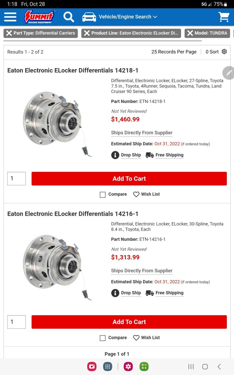

    5N0W808 likes this.

    3.90 with an open diff.
    Mr.bee[QUOTED] and Sunnier like this.
