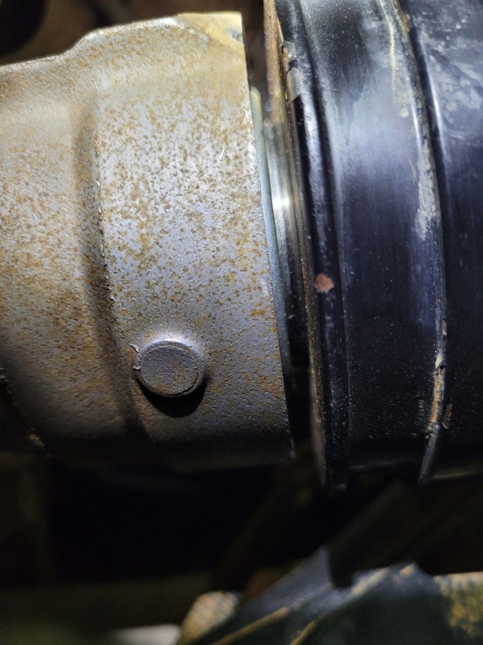

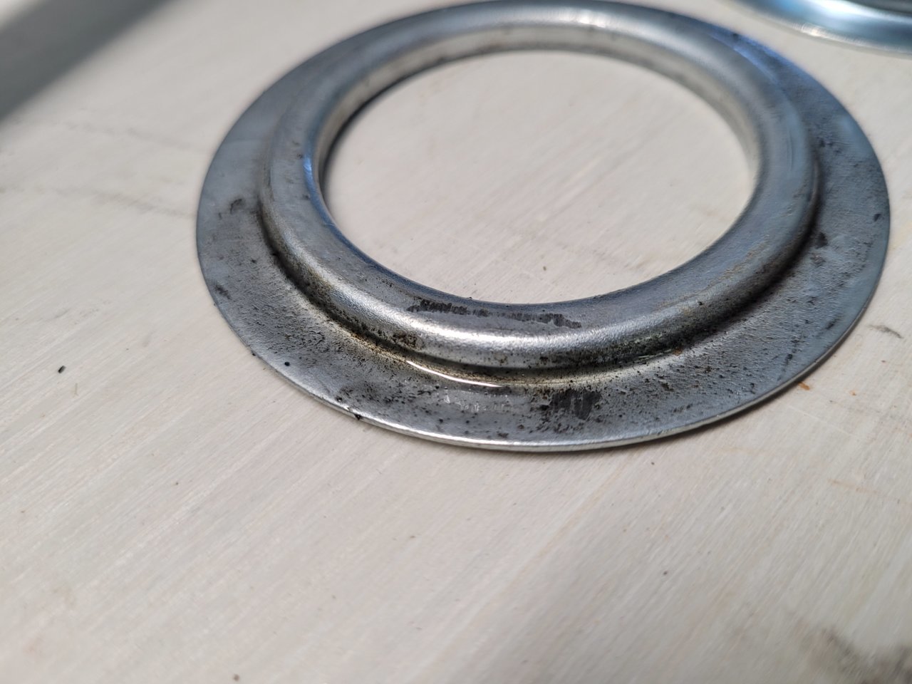

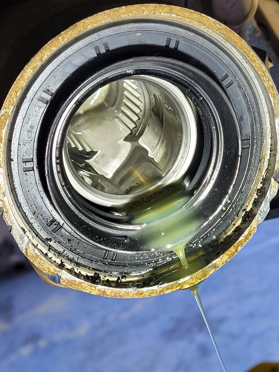

    Got the passenger side seal and dust shield replaced today. The bearing looked fine, zero play. The magnet had minimal metallic flakes on it. The noise was coming from the very loose dust shield rubbing the seal. It was slowly eating away at it.
    I called the owner of the shop and let him know everything. He said without proof they can't know if the diff was underfilled or not. I told him I had proof ( took a video as I cracked the fill plug) he didn't seem too concerned about making anything right on his own, no offers of help or anything. I had to ask him for it. Told him to just take care of anything that may happen in the future due to the underfilled diff. He agreed, but acted like it wasn't a big deal. I'm gonna send him pictures of the dust shields that were damaged and also the damaged cv seal and see if I can at least get compensated for the cost of parts.

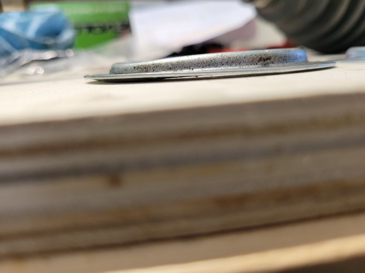

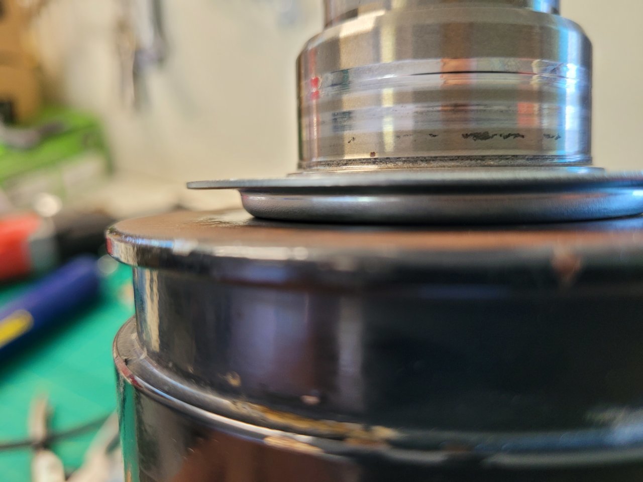

    Here is how far out the dust shield was pried away from being seated, and a picture of the correct installation done by yours truly20220923_130724.jpg 20220926_123209.jpg
