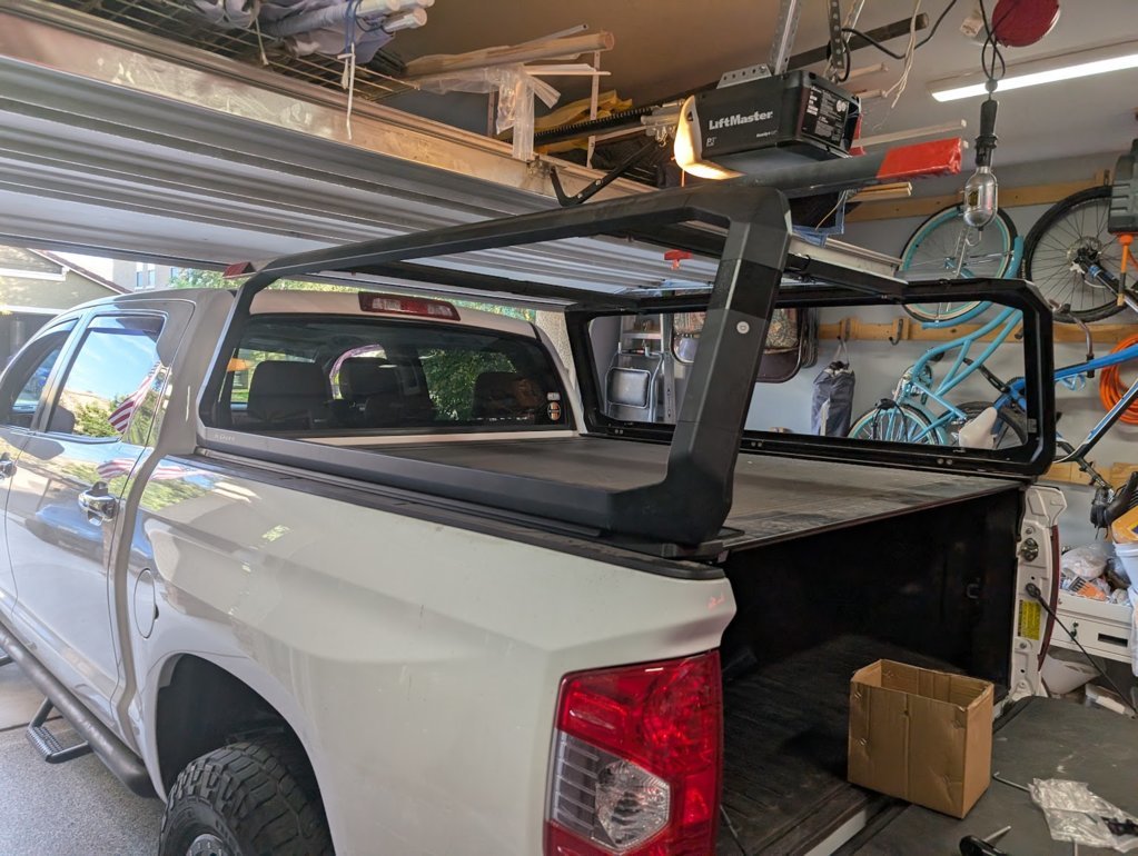

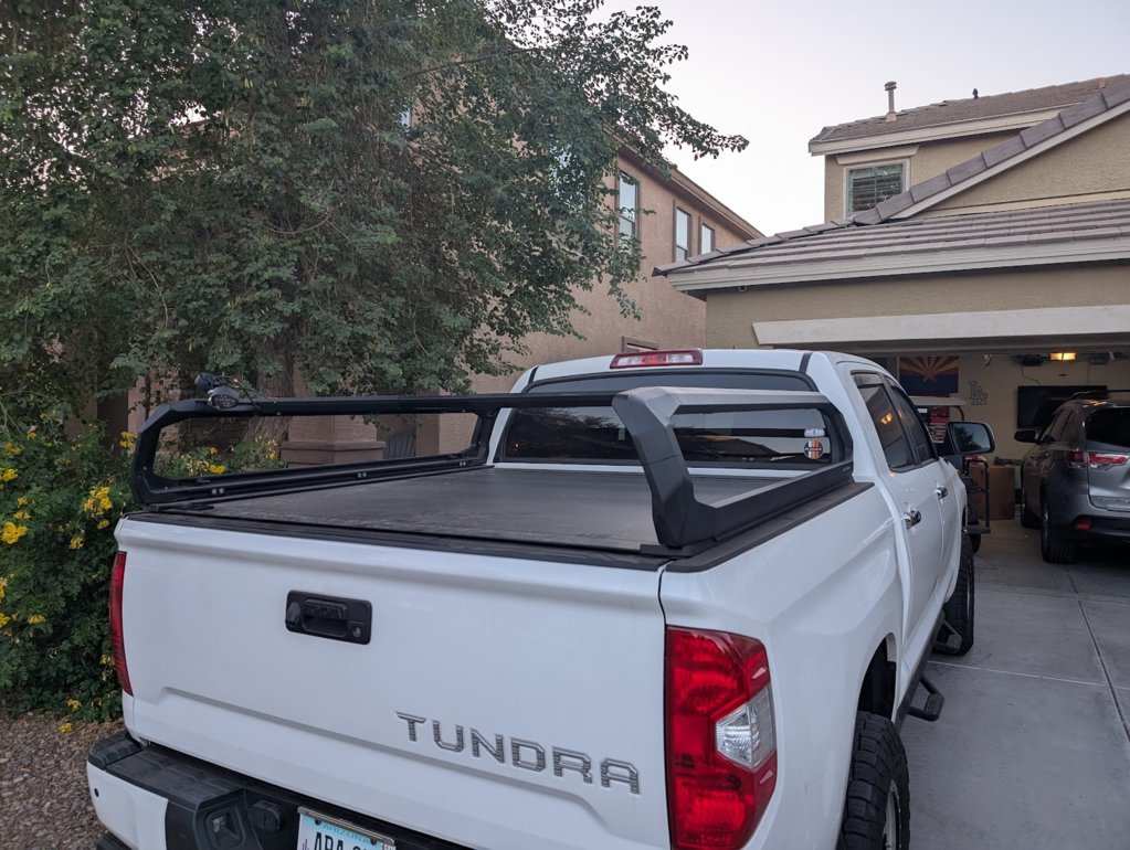

    Kuat Ibex truck bed rack installed.
    It's the Full sized, short bed IBEX-B2 model. Purchased the rack at REI (to earn those dividends), and the Tonneau kit direct from Kuat.
    Had to order the AIXRMFS IBEX Retractable Tonneau Adapter - IBEXB2 - Compatible with Retrax® that works with my Retraxone XR Tonneau.
    The box I picked up at REI was looking pretty abused, but all items were fine and well protected/packed.
    Instructions are via a QR code to a PDF that you can follow on your phone.
    Installation would be a PITA w/out an electric ratchet- so glad I had one. The allen keys they give you are sufficient- but many of the threads were SUPER tight on the aluminum struts and crossbars where doing this by hand would have taken 5x more effort. I spent about 2 hrs, given the fact that I am running it in MID height configuration and had to disassemble and reassemble some parts. The kit ships with FULL or CAB height configuration.
    Running the Retrax, and the tonneau adapter will increase your height by approx 5/8" - 3/4" or so. I found that the full height setting would be too tall for my preferences and needs at this time. Running a RTT would put it 100% above the cab height and into the wind.
    The powdercoating might be soft- it was easy to scrape and mark up. I did this on a clean epoxied garage floor and ended up with a lot of scuffs. The crossbars scuffed up the t slot bars as well. That's disappointing, but I do realize it will get dirty and scratched over time due to normal use.
    Initial impressions are that its very sturdy. Claims to hold 1200# static, and 600 dynamic, with 300# off-road

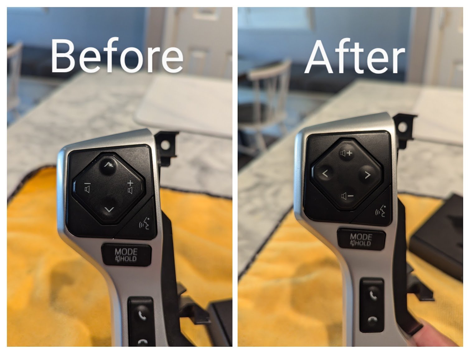

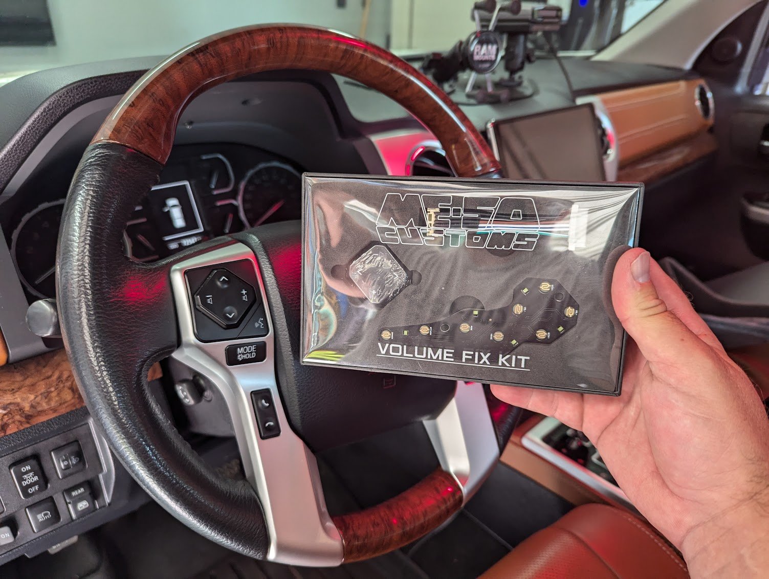

    Nothing major to report, but did knock out the MESO Customs Volume Fix kit, that switches the left steering wheel buttons around to a proper orientation. <20 min install.
    Requires a trim removal tool (or flathead), a T30 Torx, and a Philips screwdriver. I also needed small snips to cut a zip tie.
    PXL_20240731_152518697.jpg PXL_20240731_154952651.jpg 20240731_085201-COLLAGE~2.jpg

    Sold the Tepui RTT and ordered a new hard side tent. For now, and keeping this budget friendly, I went with a Top Oak Galaxy 1.0 tent off Amazon. I had a coupon code for $200 off. I thought about picking it up and saving $299 freight, but I would spend $299 just getting to socal and back-not worth it. I ordered on Nov 19, and I received a call that I could schedule delivery on Nov 27. Quick!
    I also raised the Kuat Ibex rack from the mid-height setting to the full-height setting. I was able to keep the lower half of the hoops on the truck bed, and insert the full height bars. May have stripped 2 of the bolts due to the thread tapping not being deep enough in the extruded aluminum of the full height bar inserts. Ugh. Everything is snug and put back togeher. I was heavily concerned that the full height setting wouldn't be high enough to cover the roof of the cab. Looks like I've got 1.5" of clearance. If you're not using the Retrax tonneau adapter with your Kuat Ibex then I think you'd be about .5" lower in height giving you 1" of clearance.
    mid-height setting
    full height setting
    Roof clearance

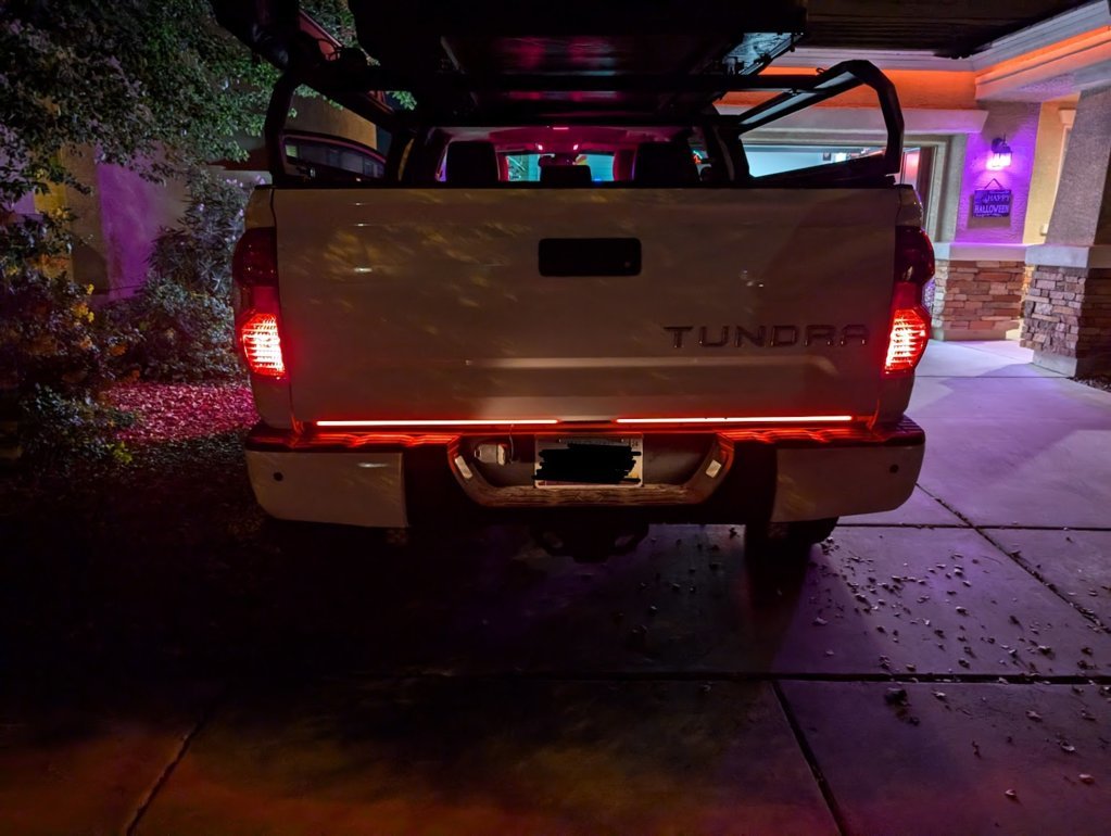

    Also from a couple weeks ago, removed and sold the Diode Dynamics hitch light pod. I still wanted a 3rd brake light, and got this tailgate led light bar with signals (for free). I like that it is 2 parts, so you can access the spare tire winch port w/out having to remove the light strip.
    Link to the led turn/brake light by True Mods
    I wish there was a way to set the brake light to flash 3x, but this is fine. I did not wire up the reverse light yet, as I still have the VLEDS license plate revese light- which is SUPER bright.
