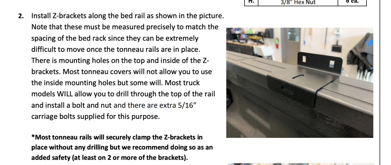

    The instructions say you can use the holes on top of the mount to bolt them to the bed. I'd do that if they work with your cover instead of mounting them to the bed rail.
    SC_TRD[QUOTED][OP] likes this.

    Yeah, just drill thru the rail. Easy enough and you'll be able to use your retractable tonneau.
    SC_TRD[OP] likes this.

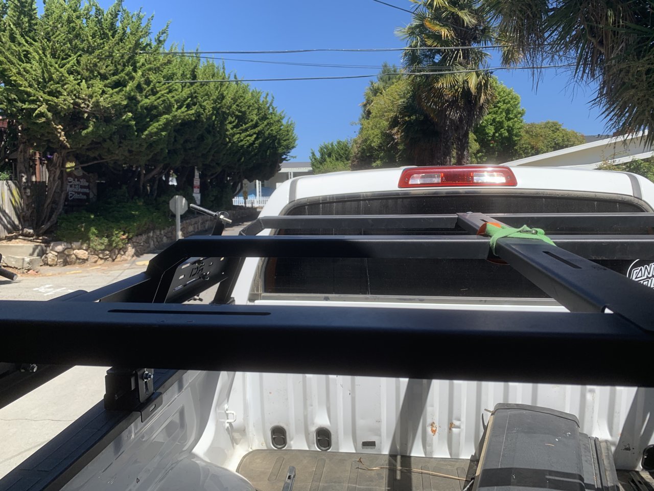

    Buy a rivnut tool Instead of drilling through. It’ll be plenty secure

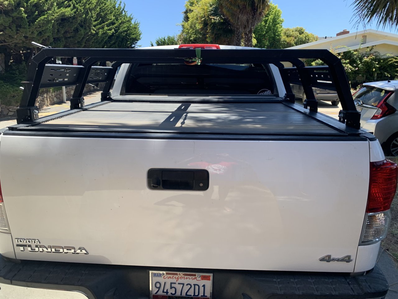

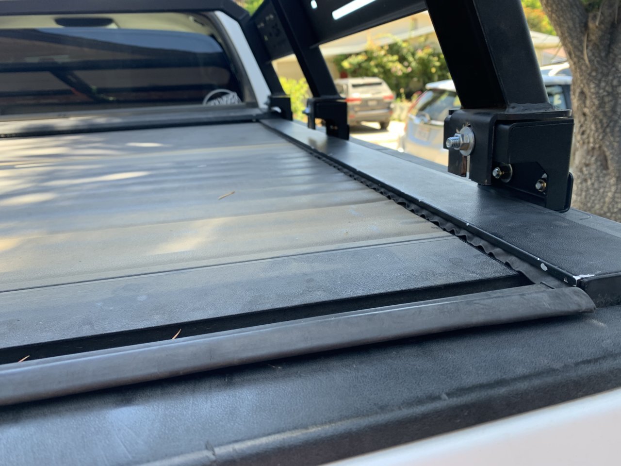

    Well I got everything cut and into place today.. good news it works, but running out of steam to get it bolted to the bedsides.. have the tonneau cover clamping it in place for now and barely moves... will bolt it into place next weekend.

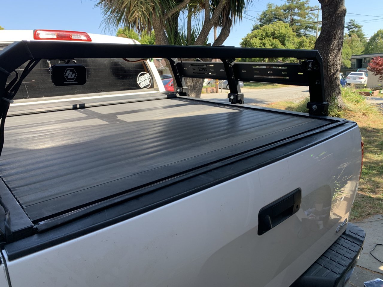

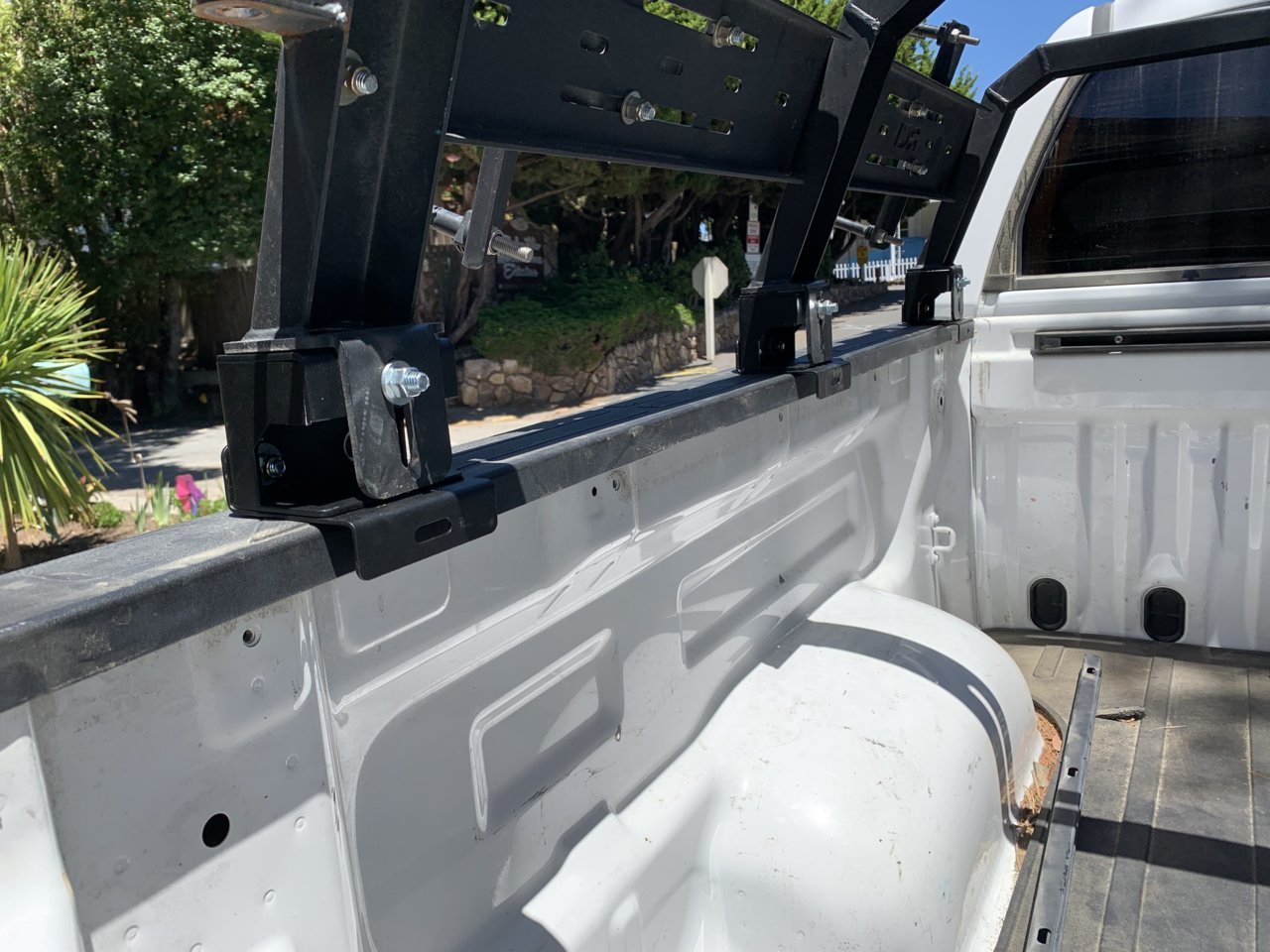

    Is this your build, or from the product website? If it's yours, how secure does the rack feel with the adapters? I have the X4 and I'm a bit concerned it won't be secure enough when loading the rack down with 200lbs+. Doesn't look like it's bolted to the bed rail here
  22. Jul 16, 2020 at 11:26 AM
    42,439
    Not my truck. Off RCI's site.
    itsmerh85[QUOTED] likes this.

    Got 4 bedside bolts in today. Didn’t see the need for the two closest to the cab as my tonneau cover box sits completely on top of them.
    I don’t think these are going anywhere now!
