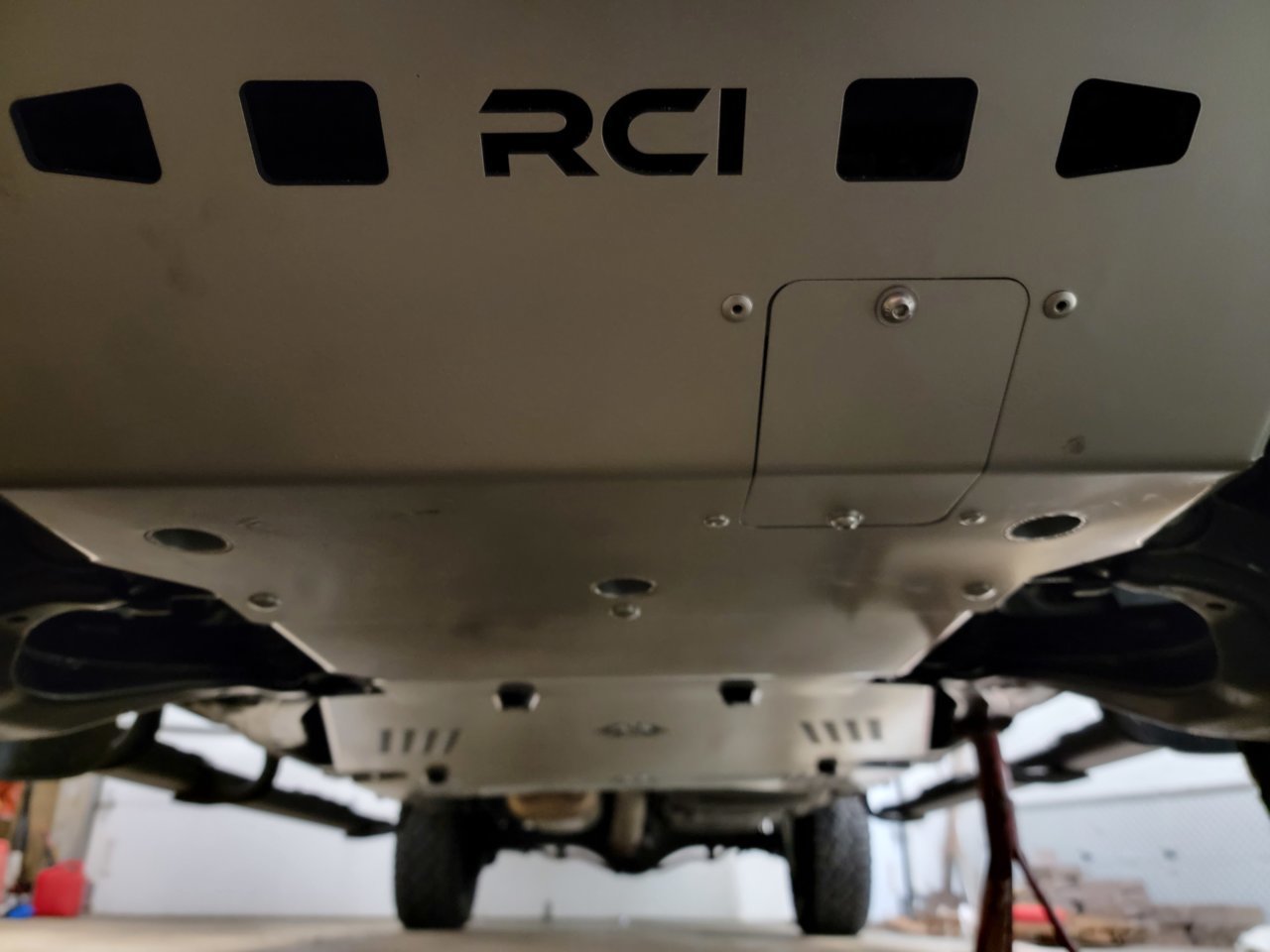

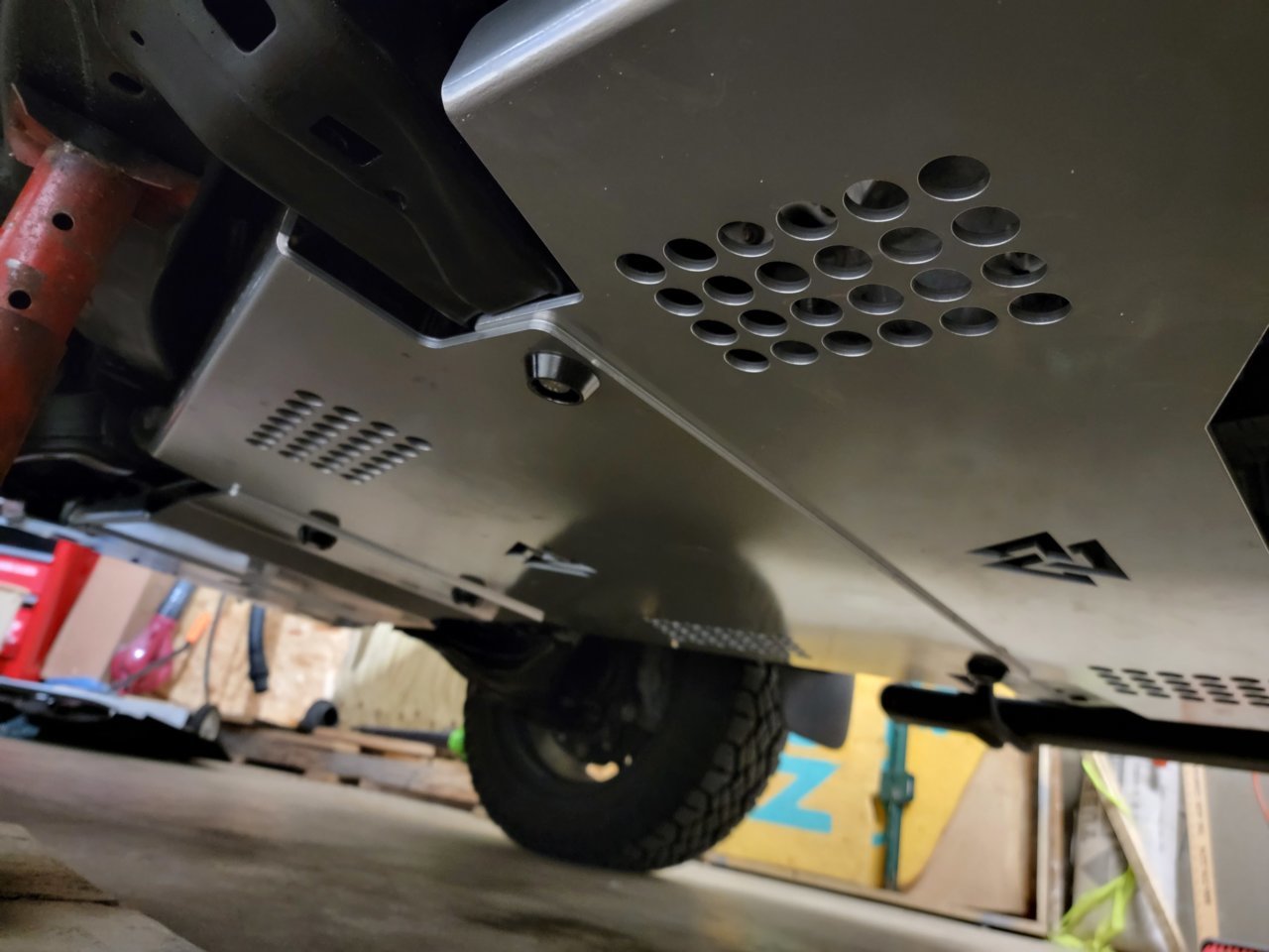

    I do not have a diff drop but I do have the aluminum 1/4 inch RCI front Skid and the Valhalla's shields 1/4 inch aluminum front and rear plates. Like said above, getting your hand up on top of that cross member is the hard part. If anything all you will need is slightly longer bolts and someone with a small hand to reach.

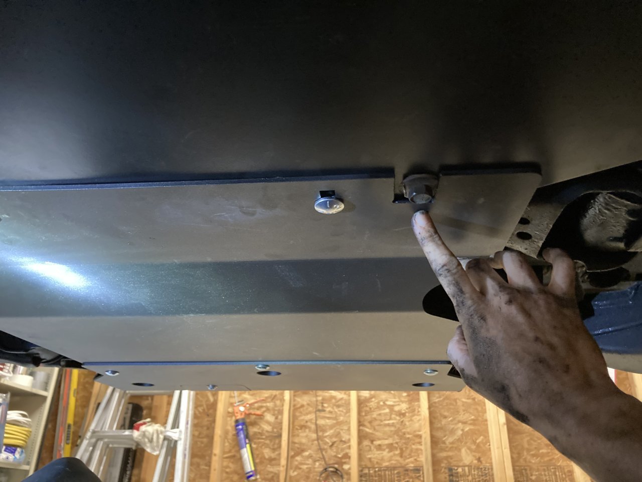

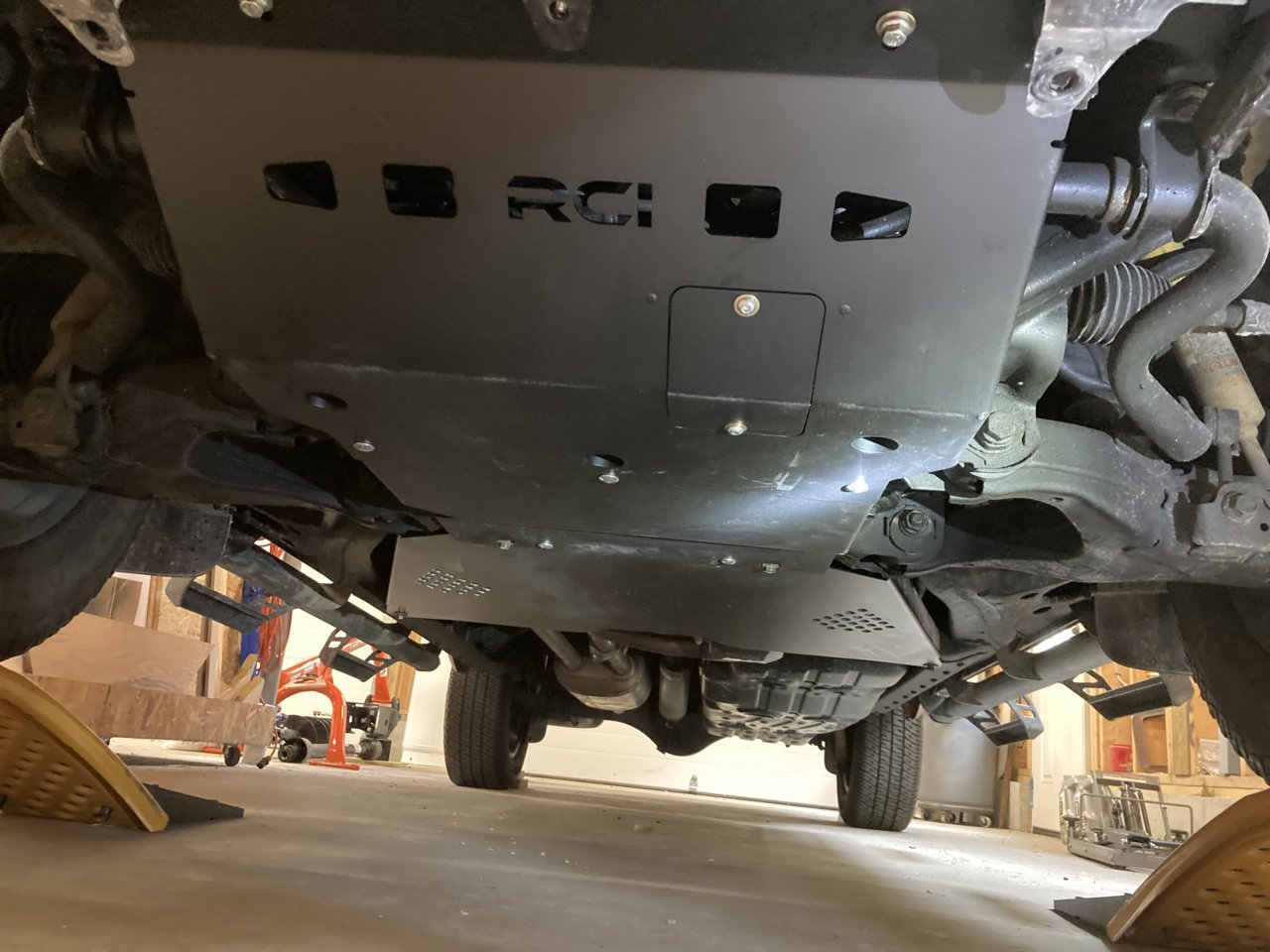

    I have an RCI front and Desert Eagle mid. I had to cut a notch in the RCI skid so the DE bolts would clear. Im a 5’3” 120lb chick with tiny arms and had bruises on my forearms from cramming them up inside to get a wrench on. It was a bit of a bitch but not sure if all the mids use the same frame holes..

    I bought the RCI skid plate before Valhalla had an aluminum option. Midwest salty winters. I probably would have bought it all from Valhalla's otherwise. I did powder coat them all to match as well in an aluminum colored prismatic powder along with clear coat.

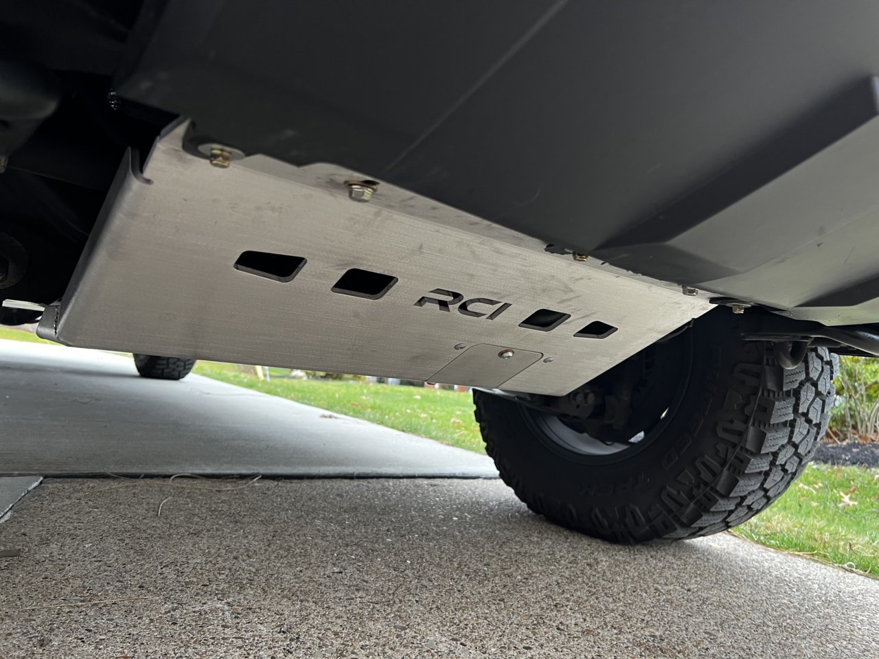

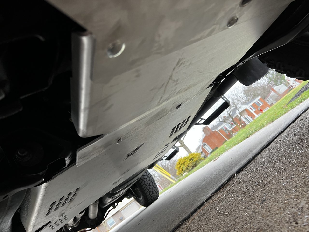

    So pulled the trigger on the RCI skid and was able to install it yesterday. Tight squeeze for sure trying to get those carriage bolts tightened through the shield and plate, and my forearms paid the price, but totally worth it. Now to figure out a way to get those greasy fingerprints off of that aluminum….
