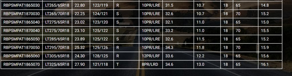

    So I'm looking at new tires, for a new set of wheels I got for my '23 and I see that RBP has a new all-terrain tire, the Repulsor A/T Plateau. Apparently, this tire only weighs 25lbs. How is this possible in a 10ply load range E tire? When their Repulsor R/T weighs in at 69lbs??
    Is the tire being this light a bad thing or an indicator of lower quality?

    While that would make sense because it would push the weight to 56lbs . Their other tires are listed in lbs not kgs on their tire charts.
    Maybe just an error on their end
