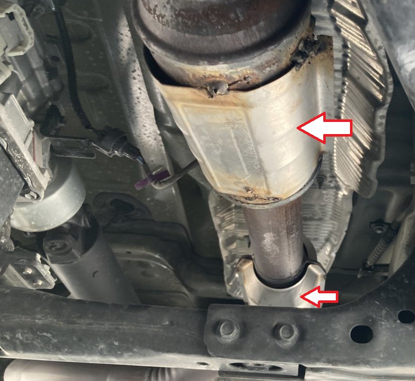

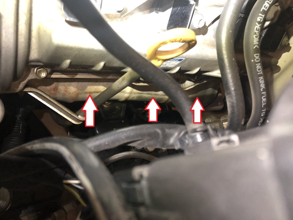

    Sounds very thin and metallic. No way it's the skid plate. But it's 5 bolts to remove the skid plate, so easy to remove that to confirm. But before you do ...
    If you look in your engine bay and up under the vehicle, you'll notice some thinner, shiny alloy looking metal stamped plates that cover the manifolds and other exhaust components and/or shield sensitive parts from the heat of those components.
    If your hands are sensitive to heat, put a glove on. While the truck is cold, start it up. Get under the truck where you're taking that video, behind the driver wheel. Listen around for the sound, and put your hand on the various heat shields you see on the exhaust pipes. If the sound goes away when your hand is on it, that's your problem shield. Tighten it up.
    Some examples of heat shields:

    The first pic reminded me. One of my shields had a failed tack and that's where it was rattling.
