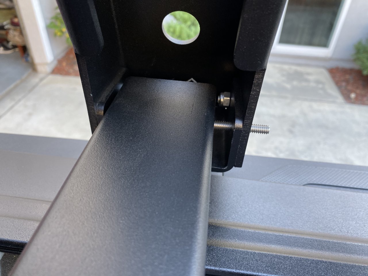

    An interesting saturday afternoon. After installing all the needed components for the cargo tray/slider. The crossbar end started to rattle. Tried emailing the support unfortunately they don’t know the solution.
    this is the part that rattles.

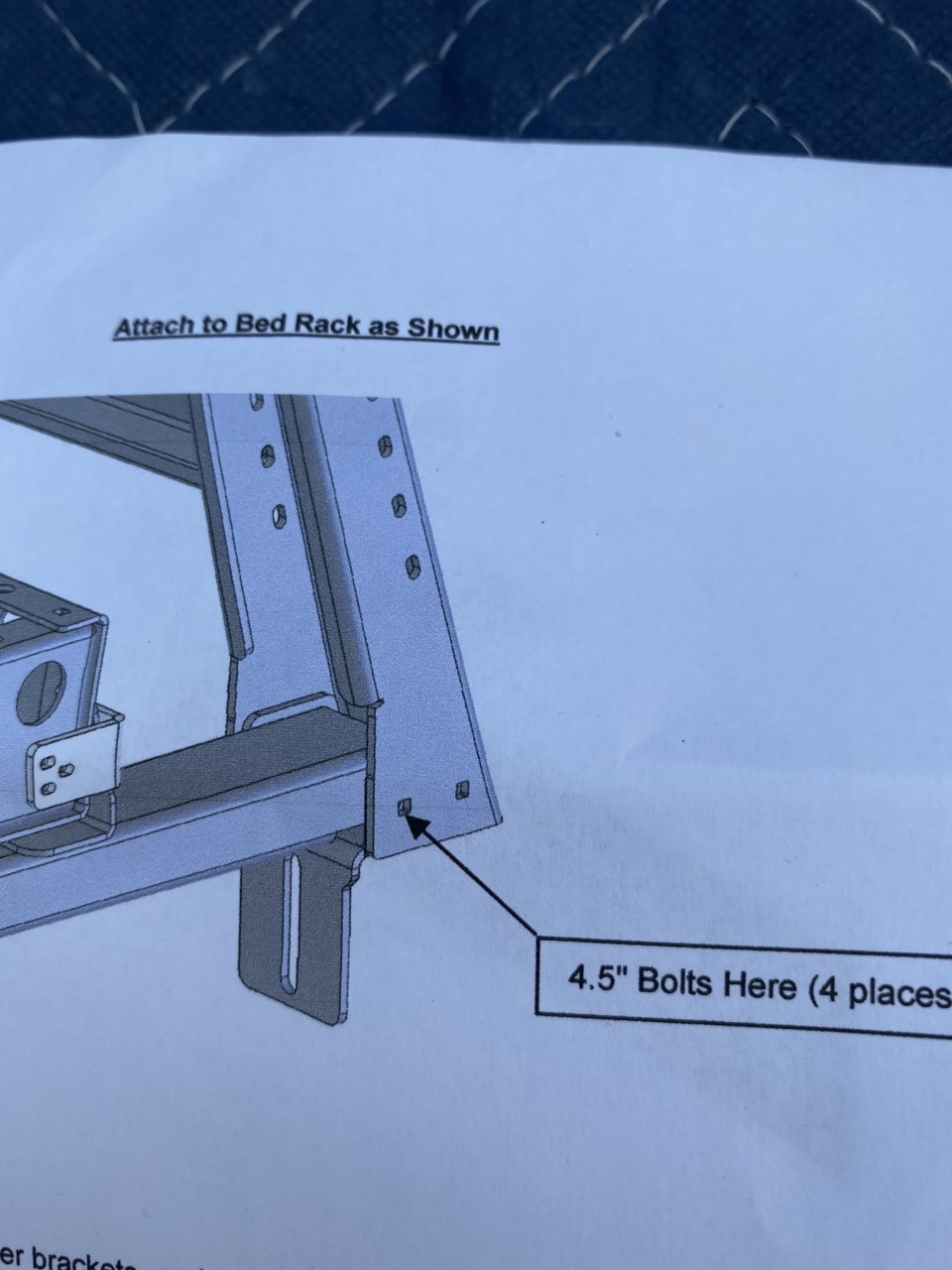

    Again, double checking the instructions but no use.

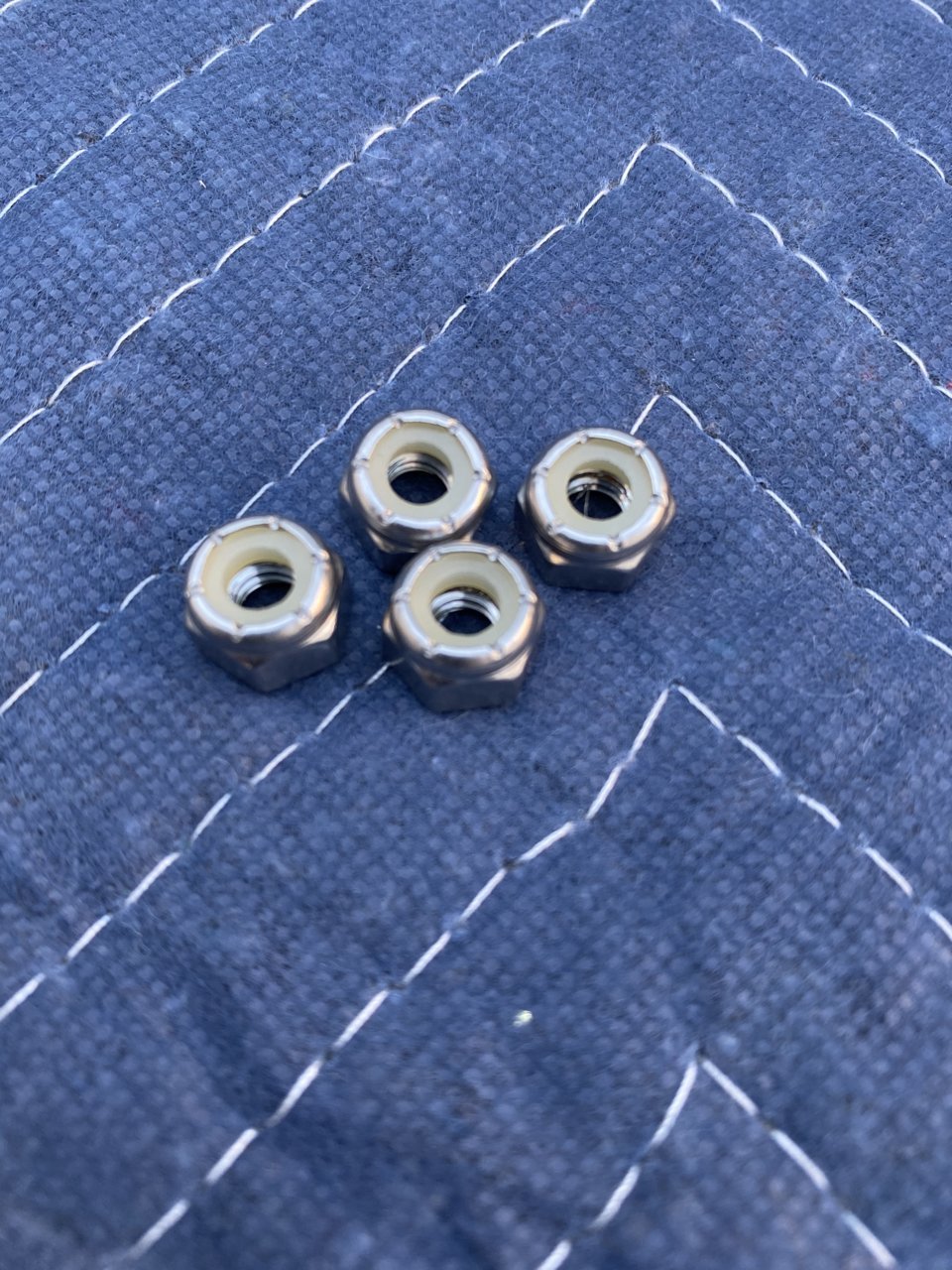

    Yup, thats right 4 on each corners.

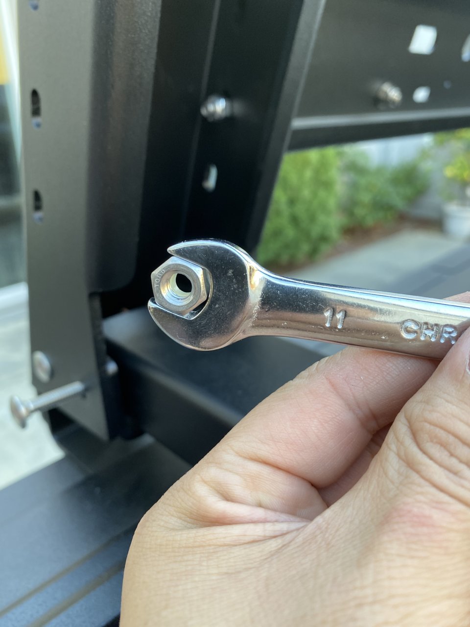

    got the needed stuff
    Now to do the trick its simple but tricky..

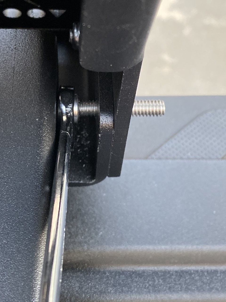

    tried to insert this little screw.

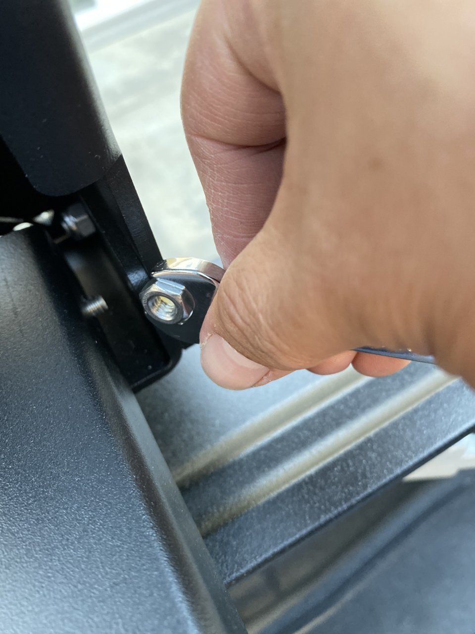

    Tightened it to snug and eventually the rattling goes off
