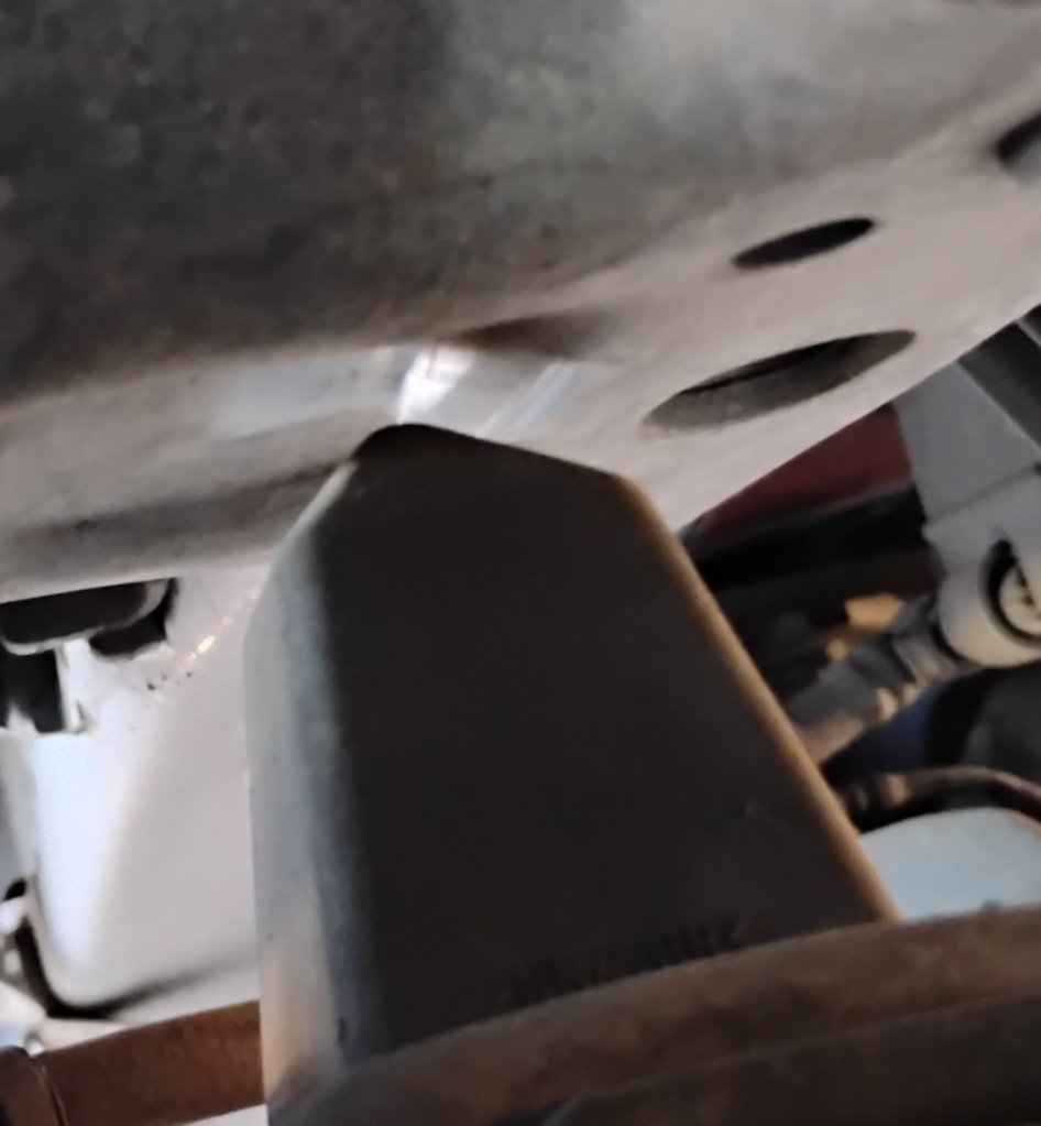

    I think you might be overestimating your weight. I carry a 1650# camper and I'm squatted to within an inch of the bump stops.
    I might be doing frame damage at this point.
