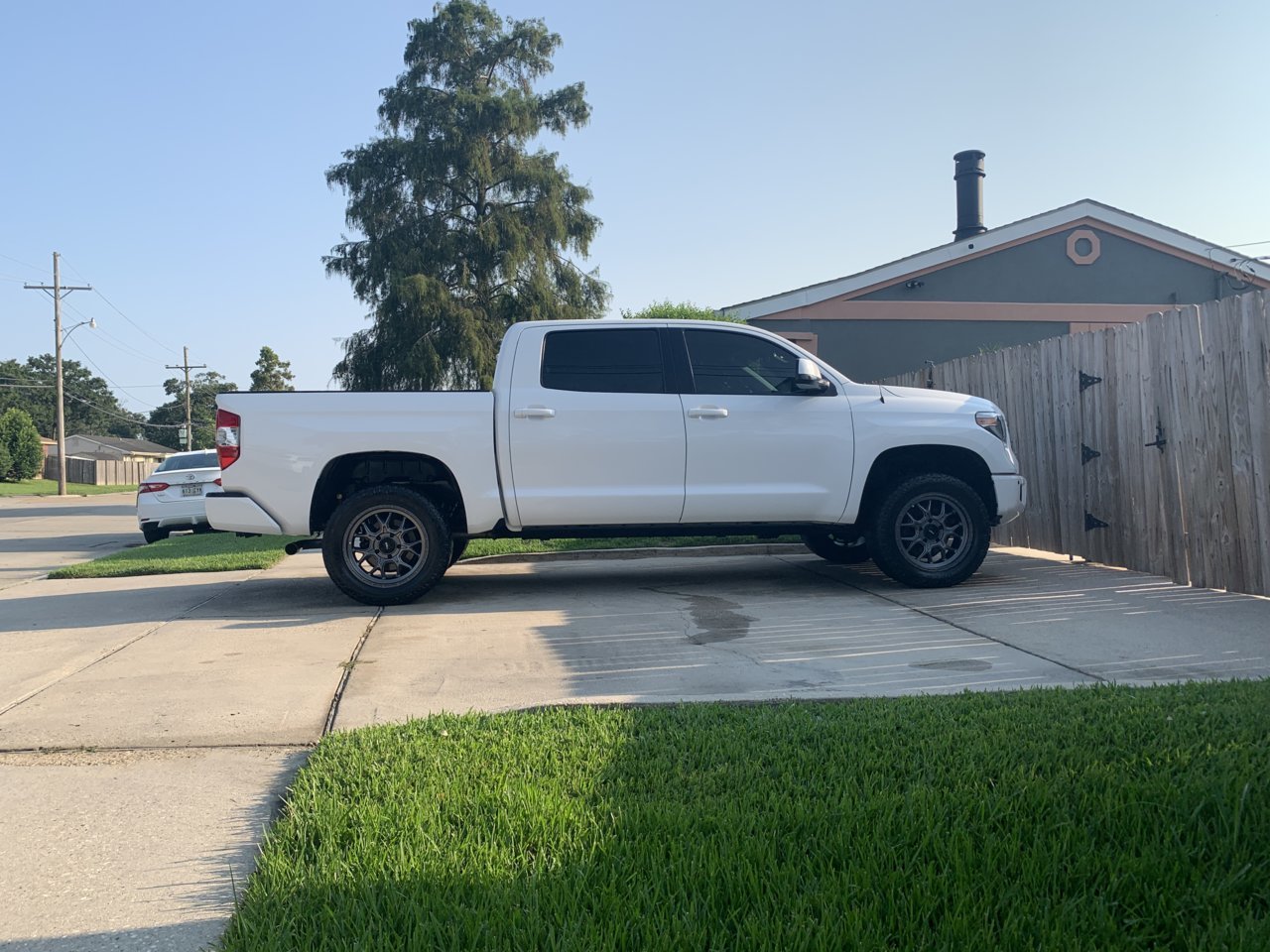

    VLED Interior VLED Cargo Light VLED Reverse Light Driverside Grab Handle Bilstein 5100 front 2nd setting TRD Dual Exhaust Black Chrome AJT Chrome Delete TRD Air Filter Tyger Side Steps TVD Vinyl Decals MGM Tundra Radio Decals TVD Vinyl Decals MGM Tailgate Handle Decals Tundra Tailgate Badge Chrome Moto Metal 970 wheels 275/70/18 KO2 Tires TRD Rear Sway Bar MGM Door Handles and Mirror Caps TRD Pro LED Black Housing Headlights Black Housing LED Fog Lights AJT Black Door Handles AJT Black Steering Wheel Controls Tacoma Leather Steering Wheel Pedal Commander TRD Pro Hood Scoop 12 Volt Solutions Remote Start Clazzio Leather Seat Covers
    Mine are at the 2nd setting. Looks very level to me even though the front is still low by 1/4-1/2 inch. Changed them out following guides from other threads on the forum. Then a realignment and done. Take your time and study the videos and shouldn't have any trouble.

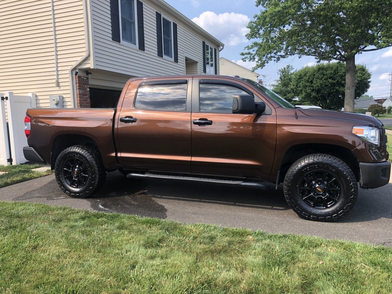

    2020 SR5 TRD OFFROAD
    Coach Builder 1 inch lift strut spacers Coach Builder 1 inch shackles TRD Sway Bar Diode Dynamics SS
    In theory the lowest lift will give you the least amount of “issues” per se. Like many said prior two inches will bring you dead level so if that is you goal I would go with a coil over. However if you are looking for some rake the 1 inch front lift range is perfect IMHO. At which point you can do a coil over or a small front spacer. The problem with dead level is that the rear end sags under even smaller loads. Here is an example…D1E98D89-6F9F-4DF1-8571-26E6915F1197.jpgit has the sagging ass looking with maybe 75 pounds tongue weight.
    I have .75 (Coach Builder spacer) of lift…

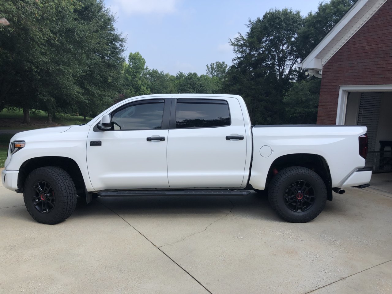

    TRD Pro BBS Wheels, TRD LED Headlights, Rigid LED Fog lights, 040 TRD Grille, 040 Hood Bulge, Black Center Valence, Driver's Grab Handle, TRD Pro Fox Suspension, 1.00" BORA Wheel Spacers, 1.5" Rear Shackles, TRD Front and Rear Sway bars, 295/70 R18 Cooper Discoverer AT3 XLTs, Full Size Spare, TRD Dual Exhaust, Console cover, Console Organizer, Husky Liner X-act Contours, Tinted Front Windows, Stubby Antenna, Autoventshade Deflectors, Duplicolor Painted Calipers, 040 Painted Front End Caps, Undercover Armor Flex Bed Cover
    For me, I wanted to stay OEM and the Fox TRD Pro suspension was the route I went. New, it is pricey but buy once cry once. I also added the BBS Pro wheels and went from 20” to 18” wheels on my 1794. Also put on Cooper Discoverer XLT AT 3 295/70 tires, 1.5” shackles on the rear and couldn’t be happier with the look and ride. There’s a slighted used set on Winston Salem NC CL
    Best.

    How's the rub factor on that size tire? Did you end up doing the bumper spacer too? Looks very sharp and right.:yes:

    Thanks. No bumper spacers needed. Just use a heat gun and soft blow hammer to shape a $35 inner fender liner and mud flaps. Removed small front mud flaps too. Added TRD Pro skid plate so no rubbing on this. A little trim work needed or simply bend the ears back on the standard metal skid plate to prevent rubbing there.
