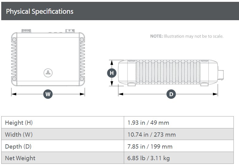

    8C21E779-49ED-422B-B5A1-780B6703E89D.jpg It’s Legit :rofl:

    That amp in your diagram will fit no problem.

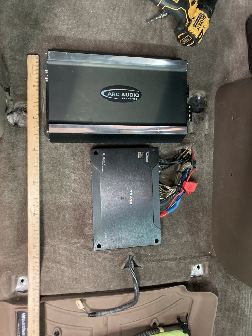

    Here is what I will stuff under the passenger seat:
    The Kenwood x802-5 (dimensions: 9-13/16"W x 2-1/8"H x 6-3/4"D)
    fits with plenty of lateral and vertical space under non powered passenger seat. The arc audio 400.4 (Dimensions: 13 inches x 8.5 inches x 2.5 inches ) needs more vertical room. I will need to reposition the kenwood as well. It hasnt been velcro’d nor fixed to the floor. The tension in the wiring/ plus the fact that it is so light had me leave it at that. Ill need to strap down that class ab monster though.
    I have my dsp under the driver seat and there is less room there anyhow.

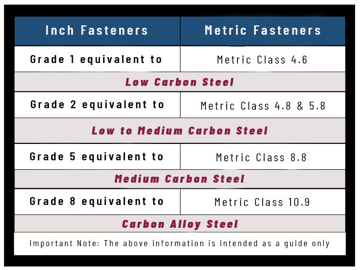

    Don't quote me on this, but I'm pretty sure grade 5 is used for seats, and grade 8 for seat belts. It looks like grade 8 is good for around 18,000lb share force, grade 5 is around 15k lb.

    Metric ratings and standard bolt ratings are different. Metric bolt grade 8.8 is not the same as grade 8 standard. Goes 8.8 to 10.9 to 12.9. Not sure of the lower than 8.8 standards but I'd say to stay away from those.
    LINK
