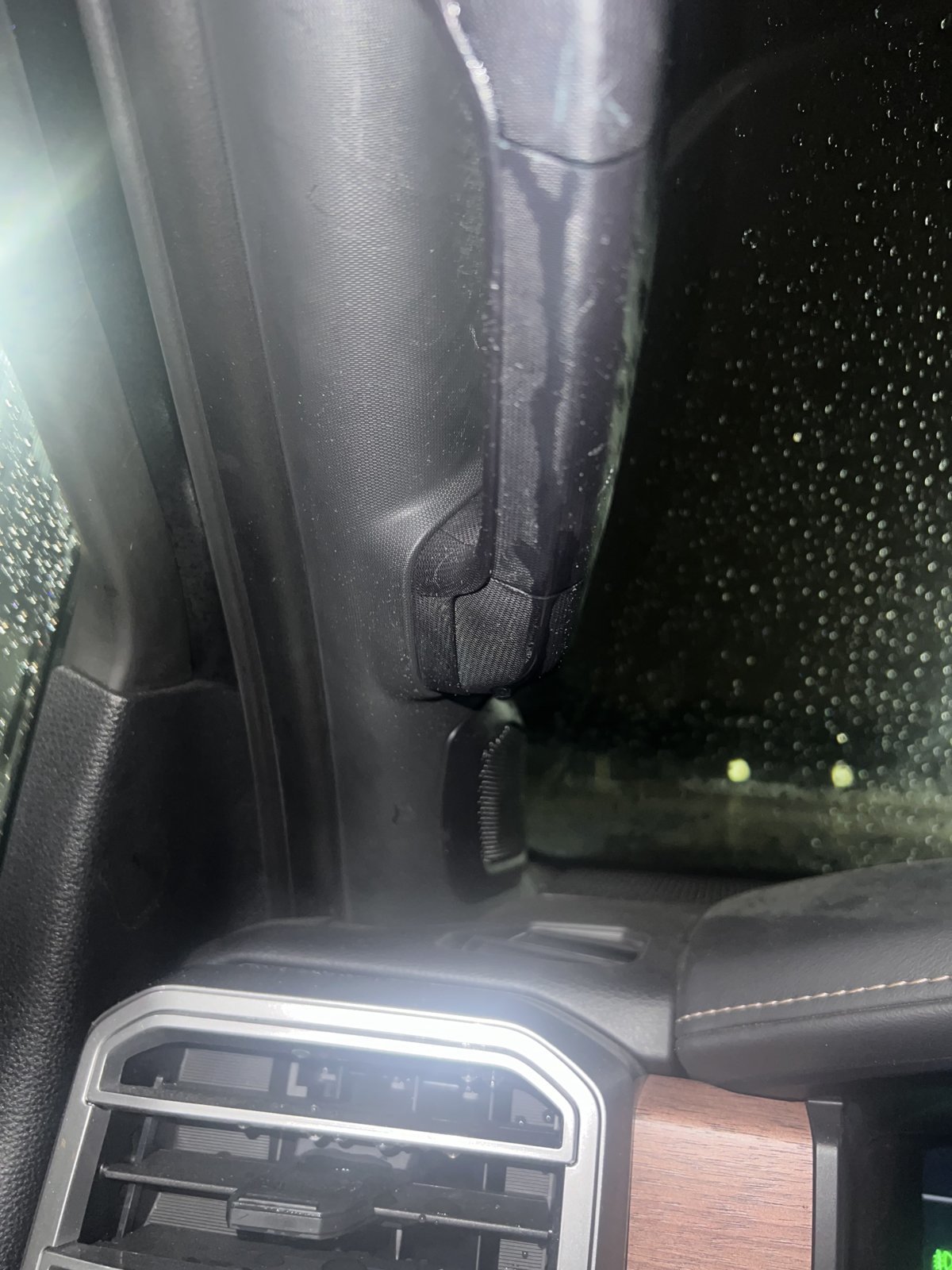

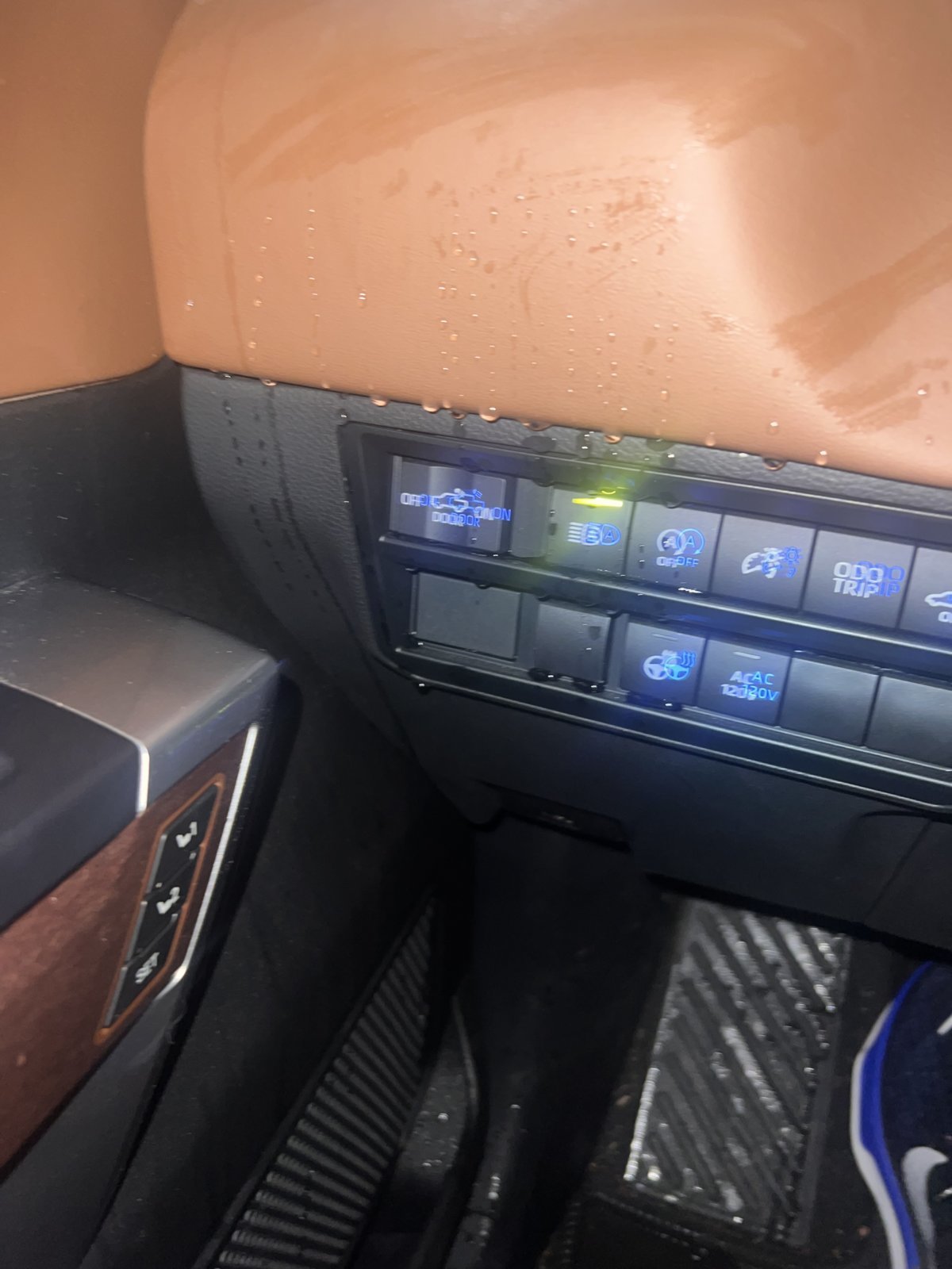

    I have a new 2023 Tundra 1794 edition. After substantial rain fall water is leaks through the entry assist handle and dripping all over drivers side dash, close to the drivers side door. I Took it to the dealer and they couldn’t find the leak or replicate it. This happened again yesterday and I have since taken the truck back for inspection. Has anyone dealt with this before?

    I want to say that there are a couple of posts here about leaking windshields. I linked your post in the 3rd gen section.

    This happens in vehicles with sun roofs when the drains are blocked but yeah that gasket around the windshield will also do it.

    I’ve been told from the dealership that the sunroof and the seal is dry. The windshield isn’t leaking either, and they claim my drain tube was not clogged. I can literally squeeze the hard plastic handle in the above pic and water comes out of it. The dealership just called and said they still can’t find where the water is getting in.IMG_4775.jpg
